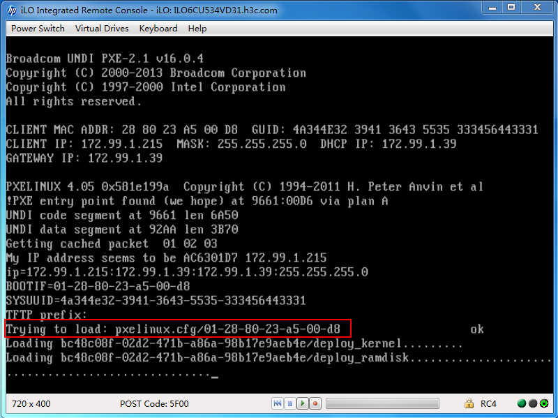

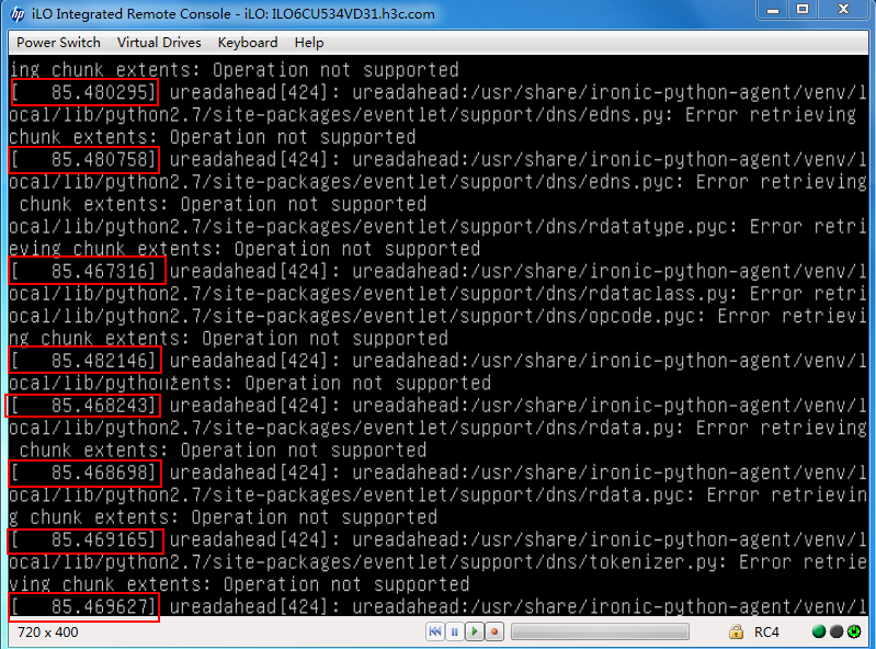

To determine whether a device is in detection phase or deployment phase, open the console and check whether the highlighted information shown in Figure-1 is displayed. If the information is displayed, the device is in detection phase.
Figure-1 Information displayed during node detection
Figure-2 Information displayed on server console during node detection
Figure-3 Information displayed on server console during node deployment

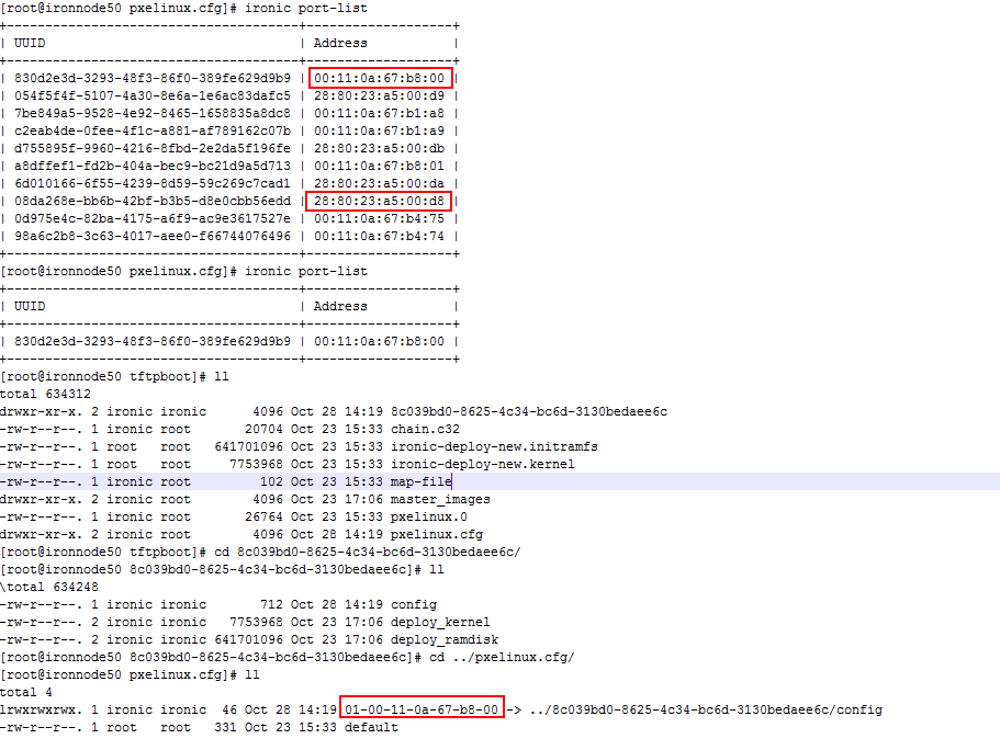

Front end processing errors occur and the deployed port information is incorrect. The correct information is 28:80:23:a5:00:d8. To resolve this issue, execute the following command:
mv 01-00-11-0a-67-b8-00 01-28-80-23-a5-00-d8
Figure-4 Port information
