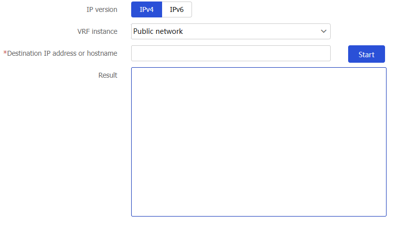

Use the tracert utility
Tracert is used to detect the path that packets traverse from your computer to the destination host. It can help you understand each hop the data passes through and the time required to reach each hop.
  1. Click the System tab.
  2. In the navigation pane, select Diagnosis Center > Tracert.
    Figure-1 Tracert
  1. Select an IP version. IPv4 indicates to trace the path that the IPv4 packets traverse from source to destination. IPv6 indicates to trace the path that the IPv6 packets traverse from source to destination.
  2. Enter the destination IP address or host name. The host name is case insensitive and can contain only letters, digits, hyphens (-), underscores (_), and dots (.).

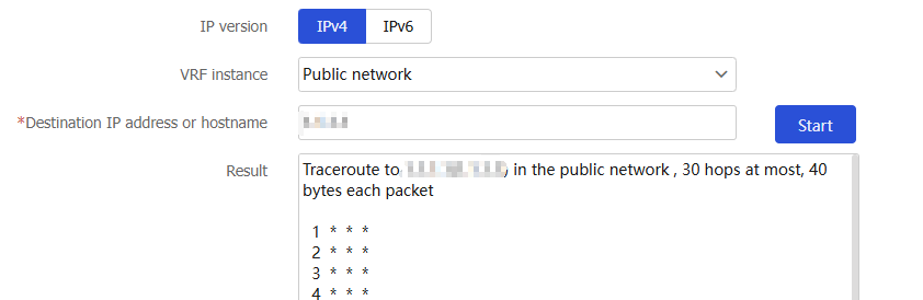

  3. Click Start to start the tracert operation.
    Figure-2 Starting the tracert operation
  1. In the Result area, view the tracert result.
