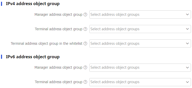

You can configure object groups for accurate terminal address identification. The device supports the following address object groups:
Terminal identification whitelist
The device permits the traffic of a terminal if the IP address of the terminal is in the terminal identification whitelist. Otherwise, the device drops the traffic of a terminal. The terminal identification whitelist supports the following actions:

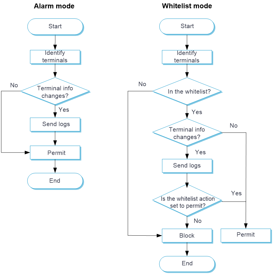

Workflow
Figure-1 Terminal identification workflow
Terminal identification works as follows:

Configure whitelist-mode terminal identification
In whitelist mode, the system permits traffic of only terminals in the whitelist. When the system detects a terminal information change, such as a vendor, model, or MAC address change, it sends a log message to the log host by using the fast log output feature. This mode is applicable to scenarios that have strict security requirements.

Configure object groups for terminal identification
  1. Click the Objects tab.
  2. In the navigation pane, select APP Security > Terminal Identification > Terminals.
  3. Click Configure object groups for terminal identification.
  4. Configure address object groups.
    Figure-4 Clicking Configure object groups for terminal identification
    Figure-5 Configuring object groups for terminal identification
    Table-1 Object group configuration items
    Item
    Description
    IPv4 address object group
    Manager address object group
    Select a manager address object group.
    Terminal address object group
    Select a terminal address object group.
    Terminal address object group in the whitelist
    Select a terminal address object group in the whitelist.
    The object group is used to filter terminal traffic. The system permits the traffic of a terminal if the IP address of the terminal is in the terminal identification whitelist. Otherwise, the system drops the traffic of a terminal.
    IPv6 address object group
  5. Click OK.
Configure alarm-mode terminal identification
In alarm mode, the system permits traffic of all terminals. When the system identifies a terminal for the first time or detects a terminal information change, it sends a log message to the log host by using the fast log output feature. This mode is applicable to scenarios that do not have strict security requirements.
