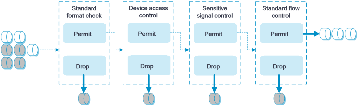

IoT device security management is a technology implementing intelligent detection and security management on IoT devices. The main features include standard format check, device access control, sensitive signal control, and standard flow control.
If a device is configured with more than one of the above features, the device processes a packet in the sequence of standard format check, device access control, sensitive signal control, and standard flow control.
Figure-1 Packet processing procedure

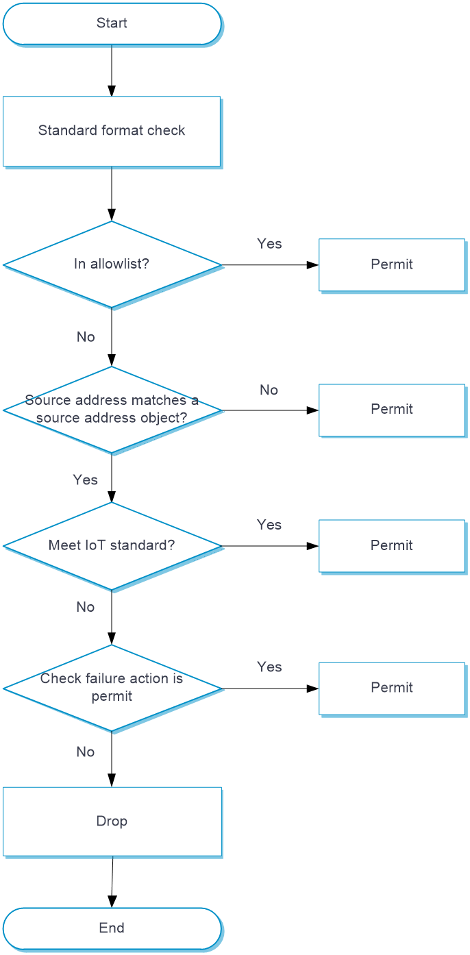

Upon receiving an IoT packet, the device configured with standard format check operates as follows:
  1. Verify whether the packet source address is in the allowlist.
    • If the address is in the allowlist, the device allows the packets to pass.
    • If the address is not in the allowlist, the device proceeds to the next step.
  2. Compare the packet source addresses against addresses in the source address object groups to determine whether format check is required.
    • If format check is not required, the device allows the packet to pass.
    • If format check is required, the device proceeds to the next step.
  3. You can configure an IPv4 source address object group, an IPv6 source address object group, and a MAC address object group to filter packets. A match is found if the packet matches any object group.
  4. Check the administrative area, device ID, IoT device type, and interface method to identify whether the packet match the corresponding IoT standard.
    • If all the packet attributes match the standard requirements, the device allows the packets to pass.
    • If a packet attribute does not meet the standard requirement, the device allows the packets to pass or drops the packets as configured.
Figure-2 Standard format check processing

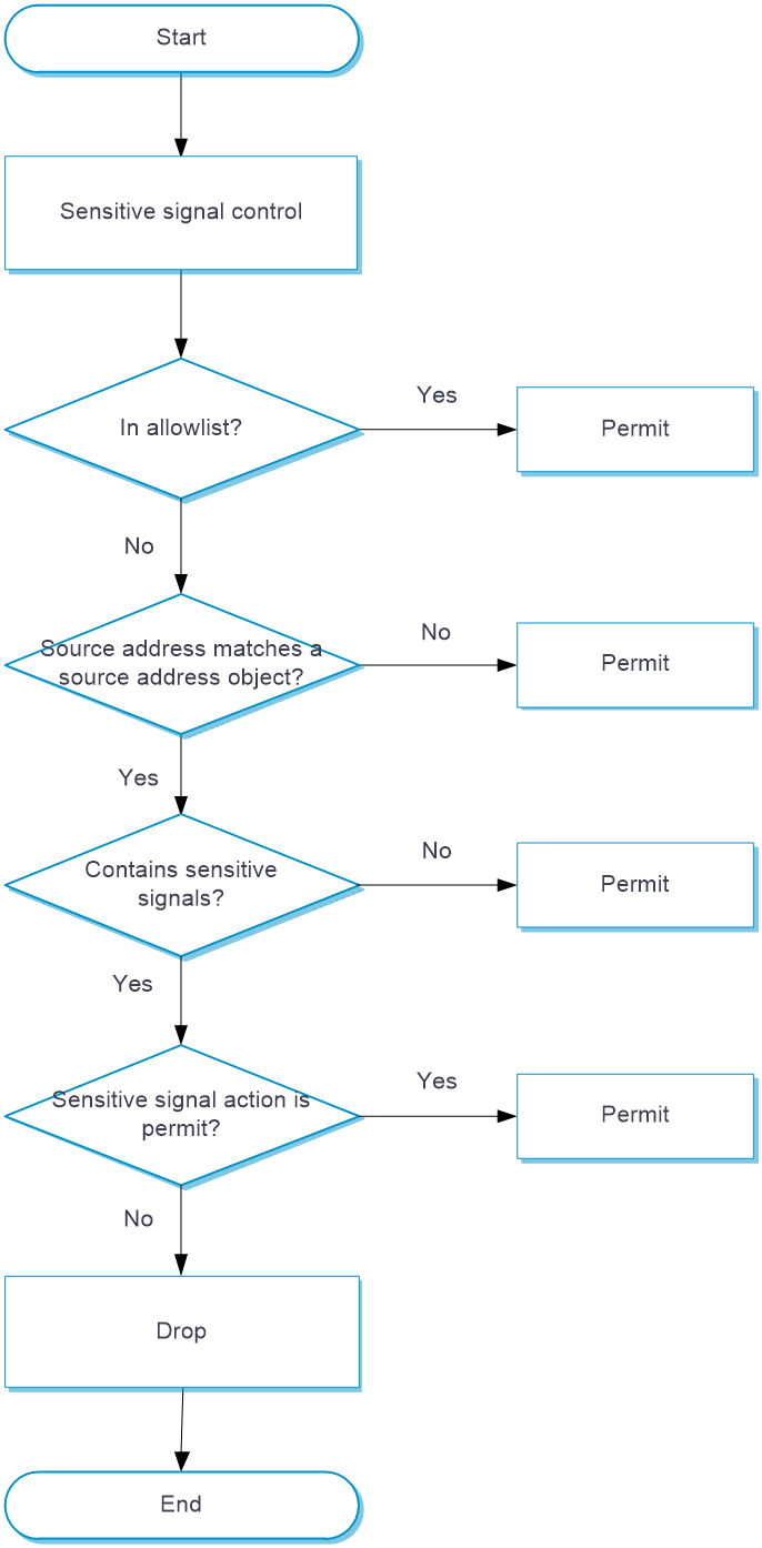

Sensitive signal control
This feature filters traffic by sensitive signals based on different IoT device standards to control sensitive user behaviors, such as querying, access, and control, to avoid data breaches and date tampering.
Upon receiving an IoT packet, the device configured with sensitive signal control operates as follows:
  2. Compare the packet source addresses against addresses in the source address object groups to determine whether sensitive signal check is required.
    • If sensitive signal check is not required, the device allows the packet to pass.
    • If sensitive signal check is required, the device proceeds to the next step.
  4. Check whether the packet information contains specified sensitive signals.
    • If packets do not contain sensitive signals, the device allows the packets to pass directly.
    • If packets have sensitive signals, the device allows the packets to pass or drops the packets as configured.
Figure-4 Sensitive signal control processing

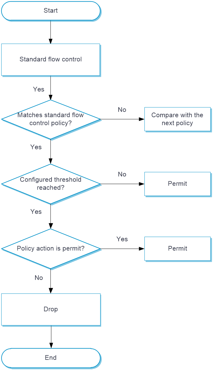

Standard flow control
This feature checks IoT device traffic based on different standard flow control policies. By comparing the total number of requests per device and request rate per device with the configured thresholds, this feature controls device request traffic and avoids DoS attacks.
When a device receives IoT packets, it compares the packets with standard flow control policies in the sequence as displayed. Once a match is found, the device takes the action defined in the policy on the packet. If no match is found, the device allows the packet to pass directly.
Upon receiving an IoT packet, the device configured with standard flow control operates as follows:
  1. Check the requester ID, IP address, MAC address, and IoT standard by policies to verify whether the packets require standard flow control.
    • If a packet matches all criterion types in a policy, the packet matches the policy successfully and standard flow control is required for the packet. Note that each criterion type includes one or more criteria, and a packet matches a criterion type if it matches any criterion of the type.
    • If a packet fails to match one of the criteria types in a policy, the packet continues to compare with the next policy until it is successfully matched. If the packet fails to match any of the policies, standard flow control is not required.
  2. Check whether the request times and rate information in the packet reaches the configured thresholds.
    • If the request times and rate information in the packet reaches the configured thresholds, the device executes the action configured in the policy on a packet.
    • If the thresholds are not reached, the device allows the packet to pass directly.
Figure-5 Standard traffic control processing

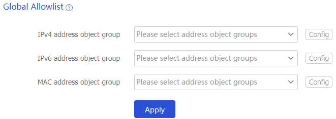

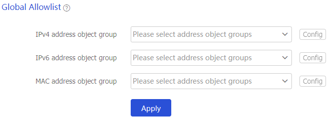

  1. Configure the global allowlist.
    1. Select Policies > IoT Device Security Management > Standard Format Check.
    2. Configure the global allowlist. To improve the system processing efficiency and reduce incorrect reporting, you can add address object groups of trusted devices or devices that are reported incorrectly by format check to the allowlist.
      Figure-6 Configuring the global allowlist

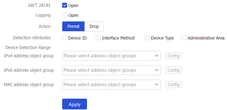

  2. Enable standard format check for different standards. Supported standards include GB/T 28181, GB 35114, and GA/T 1400.
    2. Configure settings on the Standard Format Check page.
      Figure-7 Enabling standard format check for different standards
      Table-1 Standard format check configuration items
      Item
      Description
      Standards
      GB/T 28181
      Enable format check for the specified standard.
      GB 35114
      GA/T 1400
      Logging
      Enable logging standard format check failures.
      Action
      Specify the action to take upon standard format check failure. Options include:
      • Pass.
      • Drop.
      Detection Attributes
      Configure detection attributes for standard format check. A packet passes the standard format check only after it passes the examination on all the specified detection attributes.
      Source Address Check
      Configure source address object groups to filter out devices for standard format check. The device performs standard format check on packets that match any configured source address object group.
  3. Click Apply.

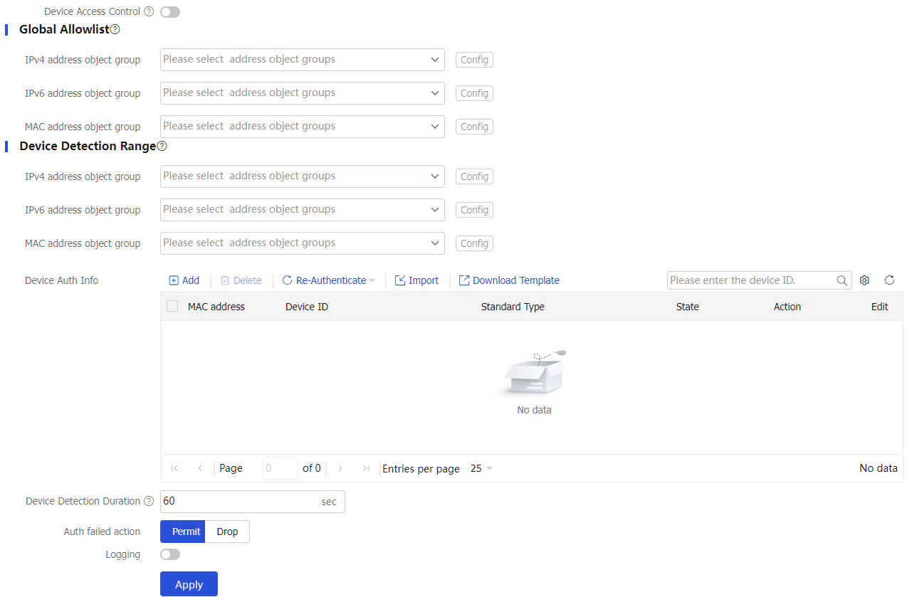

Configure device access control
About this feature
The device access control feature checks the traffic of IoT devices based on IoT device standards and configured device information. This ensures only traffic from allowed IoT devices can pass and can effectively prevent device tampering.
  1. Select Polices > IoT Device Security Management > Device Access Control.
  2. Configure settings on the Device Access Control page.
    Figure-8 Configuring device access control
    Table-2 Device access control configuration items
    Item
    Description
    Enable device access control.
    Global Allowlist
    To improve the device processing efficiency and reduce incorrect report, you can add address object groups of trusted devices or devices that are reported incorrectly by device access control to the allowlist.
    Device Authentication Information
    Used to authenticate IoT devices, such as device address, device ID, and device standard. If the IoT device information collected in a packet matches the configured device authentication information, the system permits the packet to pass. To import device authentication information, click Import.
    Authentication inaccuracy might occur if you access an IoT management platform to edit the device ID or standard information for an authenticated device. To resolve this issue, click Re-Authenticate for the device after changing the device authentication information.
    Detection Duration
    Specify the time during which the system continuously collects IoT information in each packet received to authenticate a device. This setting avoids device authentication failure caused by incomplete IoT information in a single packet.
    Action
    Specify the action to take upon an authentication failure. Options include:
    • Pass.
    • Drop.
    Logging
    Enable logging device authentication failures.
  3. Click Apply.

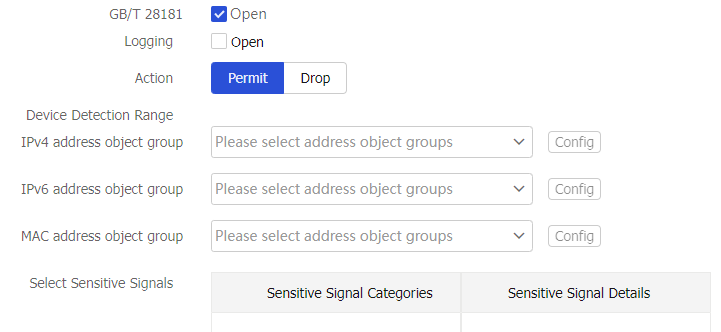

  2. Enable sensitive signal control for different standards. Supported standards include GB/T 28181, GB 35114, and GA/T 1400.
    1. Select Policies > IoT Device Security Management > Sensitive Signal Control.
    2. Configure settings on the Sensitive Signal Control page.
      Figure-10 Enabling sensitive signal control for different standards
      Table-3 Sensitive signal control configuration items
      Item
      Description
      Standards
      GB/T 28181
      Enable sensitive signal control for the specified standard.
      GB 35114
      GA/T 1400
      Logging
      After logging is enabled, the system reports corresponding logs when sensitive signals are detected.
      Action
      Specify the action upon format check failure. Options include:
      • Pass.
      • Drop.
      Select Sensitive Signals
      Select sensitive signals to be detected. The system will check whether packets contain the specified operations, such as edit and delete.
  3. Click Apply.

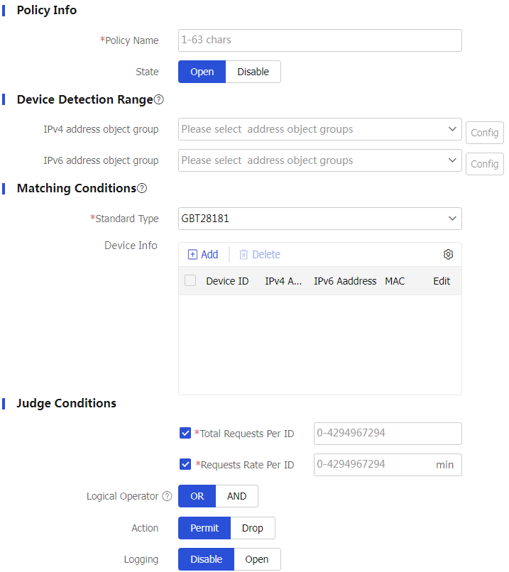

  2. Click Add to access the Add Standard Flow Control page.
  3. Configure settings to create a policy.
    Figure-11 Creating a standard traffic control policy-1
    Figure-12 Creating a standard traffic control policy-2
    Table-4 Standard traffic control policy configuration items
    Item
    Description
    Policy Name
    Configure a policy name.
    Status
    Whether the standard flow control policy is enabled.
    Match Criteria
    Standard type
    Standard type used by the packet.
    Device information
    Basic device information including device ID and address.
    Requests Per ID
    Total number of requests sent by an IoT device.
    Request Rate Per ID
    Request rate (number of requests per minute) of an IoT device.
    Logical Operation
    Logical relation between the detection attributes. Options include:
    • Or: Execute the specified action in the policy when either of the detection attribute of a packet reaches the configured threshold.
    • And: Execute the specified action in the policy only when both of the detection attributes of a packet reach the configured thresholds.
    Action
    Specify the action to take when a packet matches a policy and the detection attributes of the packet reach the thresholds. Options include:
    • Pass.
    • Drop.
    Logging
    After logging is enabled, the system reports the corresponding logs when a packet matches a policy and the detection attributes of the packet reach the thresholds.

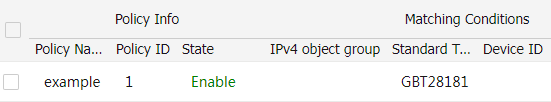

  4. Click OK. The created policy is displayed on the Standard Flow Control page.
    Figure-13 Standard traffic control policy created
