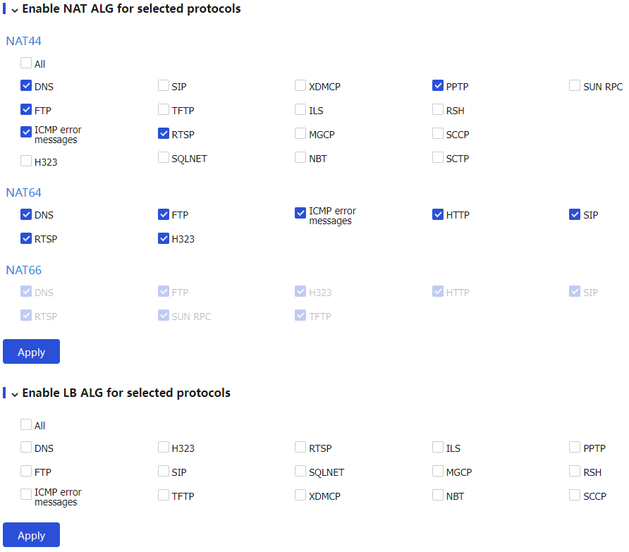

To configure ALG:
Click the
In the navigation pane, select
Select protocols to be enabled with ALG.
Support for protocols varies by device model.
Figure-1 Enabling ALG for the specified protocols
Click
