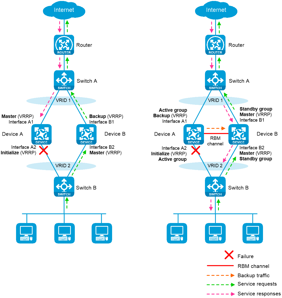

Figure-1 VRRP and hot backup association
A VRRP active/standby group can be in master or backup state, which determines the state of devices in the associated VRRP groups. For example, if a VRRP active group is in master state, all devices in the associated VRRP groups are masters.
The initial state of a VRRP active/standby group varies by the device mode as follows:
In the network configured with VRRP and hot backup association as shown in
Typically, the VRRP active group state is master on Device A (suppose it is the primary management device), so Device A is the master in both VRRP group 1 and VRRP group 2. The VRRP standby group state is backup on Device B (suppose it is the secondary management device), so Device B is the backup in both VRRP group 1 and VRRP group 2.
When Interface A2 (downlink interface on Device A) fails, Device A receives an interface failure event. Device A then notifies Device B of the VRRP active/standby group state change event in an update packet, requesting Device B to change the VRRP standby group sate to master.
Upon receiving the update packet, Device B changes the VRRP standby group state to master. Meantime, Device B changes its state to master in VRRP group 1 and VRRP group 2. After the state change, Device B sends a reply to Device A.
Upon receiving the reply, Device A changes the VRRP active group state to backup. Meantime, Device A changes its state to backup in VRRP group 1 and VRRP group 2.
For traffic to switch back when Interface A2 recovers, the devices will perform another master/backup state switchover that is similar to the procedure described above.

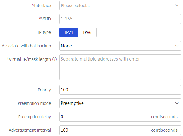

Configure a VRRP group as follows.
Table-1 Basic VRRP configuration items
Item | Description |
Interface | Specify the interface to where the VRRP group resides. |
VRID | Enter a virtual router ID that uniquely identifies a VRRP group. VRRP groups sharing the same VRID on different devices indicate one VRRP group. |
IP type | Specify IPv4 or IPv6 VRRP. |
Associate with hot backup | Configure this parameter in a VRRP-hot backup association scenario to enable collaboration between VRRP groups. |
Virtual IP | Enter the virtual IP address of the VRRP group. |
Priority | Enter the priority. A higher priority indicates the device is more likely to become the master of the VRRP group. |
Preemption mode | Select the preemption mode: preemptive or non-preemptive. |
Preemption delay | Enter the preemption delay time. A backup device waits for the specified period of time before it preempts as the master. 0 means the device immediately preempts as the master. |
Advertisement interval | Set the VRRP packet advertisement interval. For VRRPv2, the effective value can only be a multiple of 100. For example, if you configure the value as 10 through 100, 101 through 200, or 4001 through 4095, the effective value is 100, 200, or 4100, respectively. For VRRPv3, the configured value takes effect. |
Auth mode | Specify the no authentication, simple authentication, or MD5 authentication mode. VRRP validates VRRP packets by adding an authentication key to prevent attacks with forged packets. |

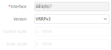

Figure-5 Advanced VRRP settings
Configure advanced VRRP group settings.
Table-2 Advanced VRRP configuration items
Interface | Specify the interface to which the VRRP group is bound. |
Version | Select VRRPv2 or VRRPv3. VRRPv2 supports only IPv4 VRRP. VRRPv3 supports both IPv4 VRRP and IPv6 VRRP. All routers in an IPv4 VRRP group must use the same IPv4 VRRP version. |
Control VLAN | Specify the control VLAN for a subinterface configured with ambiguous Dot1q termination. |
Inner VLAN | Specify the inner VLAN for a subinterface configured with ambiguous QinQ termination. |
