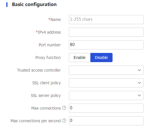

    Figure-2 Configuring basic settings of the the trusted API proxy

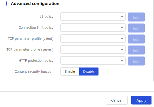

    Figure-3 Configuring advanced settings of the the trusted API proxy
    Table-1 Basic trusted API proxy configuration items
    Item
    Description
    Name
    Enter the name of the trusted API proxy, which is a case-insensitive string.
    IPv4 address
    Enter the IPv4 address used to provide trusted API proxy services.
    Port number
    Enter the port number for the trusted API proxy.
    If the trusted API proxy uses an SSL policy, you must specify a non-default port number for it (a typical example is 443).
    Proxy function
    Enable or disable the trusted API proxy.
    Trusted access controller
    Specify a trusted access controller for the trusted API proxy. The device will direct traffic matching the trusted API proxy to the specified trusted access controller for authentication and authorization. Only the users passing the authentication and authorization are allowed to proceed with subsequent procedures.
    You can select an existing trusted access controller or create a new trusted access controller.
    For more information about the trusted access controller, see the description for the trusted access controller module.
    SSL client policy
    Specify the SSL client policy used by the trusted API proxy to encrypt traffic exchanged between the device (SSL client) and the SSL server.
    You can select an existing SSL client policy or create a new SSL client policy.
    SSL server policy
    Specify the SSL server policy used by the trusted API proxy to encrypt traffic exchanged between the device (SSL server) and the SSL client.
    You can select an existing SSL server policy or create a new SSL server policy.
    Max connections
    Set the maximum number of connections allowed by the trusted API proxy. 0 means not limited.
    Max connections per second
    Set the maximum number of connections allowed by the trusted API proxy per second. 0 means not limited.
    Table-2 Advanced trusted API proxy configuration items
    Item
    Description
    LB policy
    Specify an LB policy for the trusted API proxy. Based on the LB policy rules, the device performs load balancing for packets matching the trusted API proxy according to their content.
    You can select an existing LB policy or create a new LB policy.
    A HTTP-type trusted API proxy can use only an LB policy of the generic or HTTP type.
    Connection limit policy
    Specify a connection limit policy for the trusted API proxy. The number of connections to the trusted API proxy will be limited by the specified policy.
    You can select an existing connection limit policy or create a new connection limit policy.
    TCP parameter profile (client)
    Specify a TCP parameter profile for the trusted API proxy. The device uses the parameter profile settings to process matching traffic. The client-side TCP parameter profile applies only to TCP connections between the device and the client.
    You can select an existing TCP parameter profile or create a new TCP parameter profile.
    TCP parameter profile (server)
    Specify a TCP parameter profile for the trusted API proxy. The device uses the parameter profile settings to process matching traffic. The server-side TCP parameter profile applies only to TCP connections between the device and the server.
    HTTP protection policy
    Specify an HTTP protection policy for the trusted API proxy. The device uses the protection policy settings to protect traffic matching the trusted API proxy.
    You can select an existing HTTP protection policy or create a new HTTP protection policy.
    Content security function
    Enable or disable the content security function.
    Content security-WAF profile
    Specify a WAF profile for content security. The device performs web application protection for traffic matching the trusted API proxy.
    For more information about WAF profiles, see WAF help.
    Content security-IPS profile
    Specify an IPS profile for content security. The device performs intrusion prevention for traffic matching the trusted API proxy.
    For more information about IPS profiles, see IPS help.
    Content security-Anti-virus profile
    Specify an anti-virus profile for content security. The device performs anti-virus prevention for traffic matching the trusted API proxy.
    For more information about anti-virus profiles, see anti-virus help.
