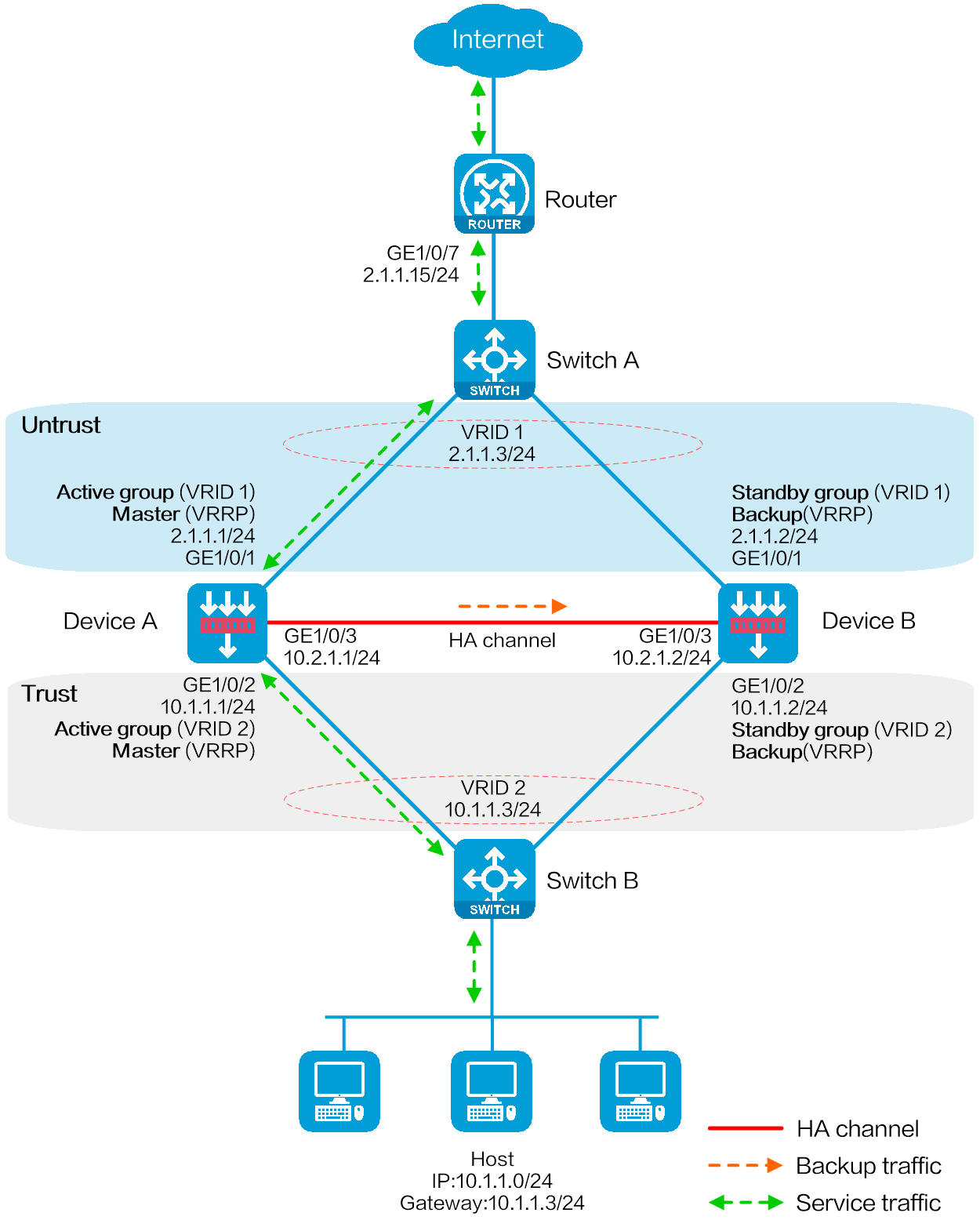

As shown in the following figure, Device A and Device B are border security devices connected to the internal network and the Internet. To improve service stability, use the two devices to form an HA system, with Device A as the primary device, and Device B as the secondary device. When Device A or its attached link fails, Device B takes over to ensure service continuity. In addition, configure static NAT on the device to ensure that internal users can access the Internet. The company owns ten external IPv4 address in the range of 2.1.1.1 to 2.1.1.10.
Figure 1 Network diagram

Procedures
Configure Router
  1. Assign IPv4 addresses to interfaces:

Configuring Device A
# Assign an IPv4 address to GigabitEthernet 1/0/1.
<DeviceA> system-view
[DeviceA-GigabitEthernet1/0/1] ip address 2.1.1.1 255.255.255.0
[DeviceA-GigabitEthernet1/0/1] quit
# Assign IP addresses to other interfaces in the same way according to the network diagram. (Details not shown.)
  1. Add interfaces to security zones.
# Add interfaces to security zones according to the network diagram.
[DeviceA] security-zone name untrust
[DeviceA-security-zone-Untrust] import interface gigabitethernet 1/0/1

  1. Configure RBM settings
In this example, Ethernet interfaces are used for control and data channel setup. If a device has both RBM and Ethernet interfaces, use the RBM interface for control and data channel setup to protect device security and stability. Do not use an RBM interface as a service interface.
# Specify two devices for the RBM system, with Device A as the primary device, and Device B as the secondary device. When Device A or its attached link fails, Device B takes over to ensure service continuity.
[DeviceA] remote-backup group
[DeviceA-remote-backup-group] remote-ip 10.2.1.2
[DeviceA-remote-backup-group] local-ip 10.2.1.1
[DeviceA-remote-backup-group] data-channel interface gigabitethernet 1/0/3
[DeviceA-remote-backup-group] device-role primary
RBM_P[DeviceA-remote-backup-group] undo backup-mode
RBM_P[DeviceA-remote-backup-group] hot-backup enable
RBM_P[DeviceA-remote-backup-group] configuration auto-sync enable
RBM_P[DeviceA-remote-backup-group] configuration sync-check interval 12
RBM_P[DeviceA-remote-backup-group] quit
# Configure VRRP groups and associate them with RBM. This configuration implements unified management and traffic direction for the VRRP groups.
RBM_P[DeviceA] interface gigabitethernet 1/0/1
RBM_P[DeviceA-GigabitEthernet1/0/1] vrrp vrid 1 virtual-ip 2.1.1.3 active
RBM_P[DeviceA-GigabitEthernet1/0/1] quit
RBM_P[DeviceA] interface gigabitethernet 1/0/2
RBM_P[DeviceA-GigabitEthernet1/0/2] vrrp vrid 2 virtual-ip 10.1.1.3 active
RBM_P[DeviceA-GigabitEthernet1/0/2] quit
  1. Configure static NAT

Configuration files
Router
interface GigabitEthernet1/0/7
 port link-mode route
 ip address 2.1.1.15 255.255.255.0
interface GigabitEthernet1/0/8
 ip address 3.1.1.14 255.255.255.0
 ip route-static 0.0.0.0 0 3.1.1.15
 ip route-static 10.1.1.0 24 2.1.1.3
Switch A:
vlan 10
 port access vlan 10
 port access vlan 10
 port access vlan 10
Switch B:
vlan 10
 port access vlan 10
 port access vlan 10
 port access vlan 10
Device A:
 nat static outbound 10.1.1.5 2.1.1.5 vrrp 1
 nat static outbound 10.1.1.6 2.1.1.6 vrrp 1
 nat static outbound 10.1.1.7 2.1.1.7 vrrp 1
 nat static enable
 ip address 10.2.1.1 255.255.255.0
security-zone name Trust
 import interface GigabitEthernet1/0/2
security-zone name Untrust
 import interface GigabitEthernet1/0/1
 ip route-static 0.0.0.0 0 2.1.1.15
security-policy ip
 rule 0 name trust-untrust
  action pass
  source-zone trust
  destination-zone untrust
  source-ip-subnet 10.1.1.0 255.255.255.0
 rule 1 name vrrp1
  action pass
  source-zone trust
  destination-zone local
  service vrrp
 rule 2 name vrrp2
  action pass
  source-zone local
  destination-zone trust
  service vrrp
 rule 3 name vrrp3
  action pass
  source-zone untrust
  service vrrp
 rule 4 name vrrp4
  action pass
  source-zone local
  service vrrp
remote-backup group
 data-channel interface GigabitEthernet1/0/3
 local-ip 10.2.1.1
 remote-ip 10.2.1.2
 device-role primary
Device B:
 ip address 2.1.1.2 255.255.255.0
 vrrp vrid 1 virtual-ip 2.1.1.3 standby
 ip address 10.1.1.2 255.255.255.0
 vrrp vrid 2 virtual-ip 10.1.1.3 standby
 ip address 10.2.1.2 255.255.255.0
remote-backup group
 local-ip 10.2.1.2
 remote-ip 10.2.1.1
 device-role secondary
