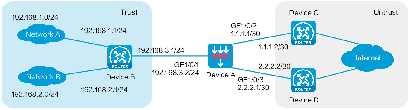

As shown in Figure 1, an enterprise deploys a security gateway Device A that is connected to internal networks A (192.168.1.0/24) and B (192.168.2.0/24) and ISP links A and B. ISP link A is connected to access device C with access point IP address 1.1.1.2/30. ISP link B is connected to access device D with access point IP address 2.2.2.2/30. Configure PBR to meet the following requirements:

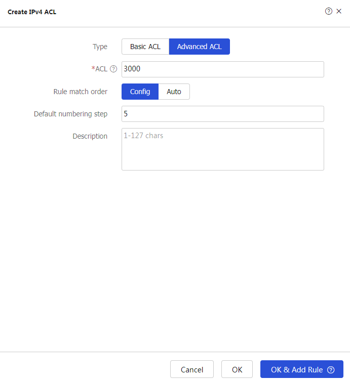

# Select Create to create an ACL to match user traffic from network A to the external network, as shown in Figure 2.
Figure 2 Creating ACL 3000

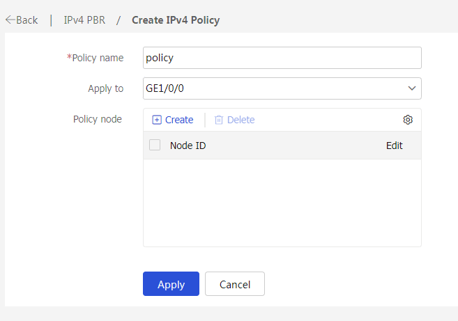

# In the dialog box that opens, configure the following parameters for the IPv4 PBR policy, as shown in Figure 8.
Figure 6 Creating an IPv4 PBR policy

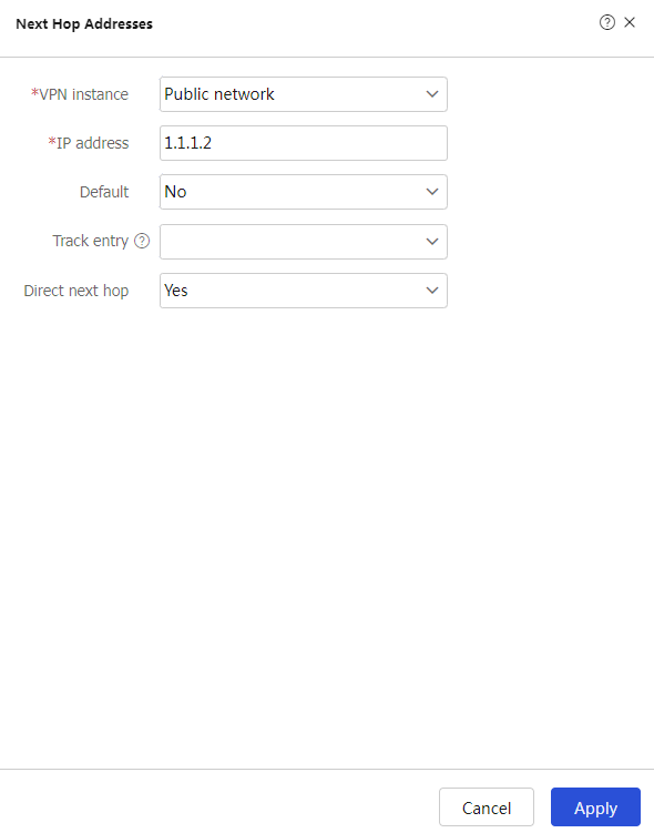

# Click Create in the Set next hops area, and configure the next hop settings as shown in Figure 10.
Figure 8 Setting the next hop

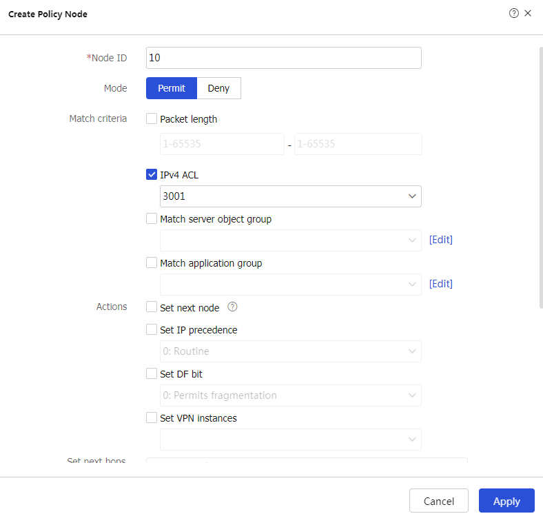

# Click Create to create policy node 10 to forward user traffic from network B to the external network, as shown in Figure 11.
Figure 9 Creating policy node 10
# Click Create in the Set next hops area, and configure the next hop settings as shown in Figure 12.
Figure 10 Setting the next hop
