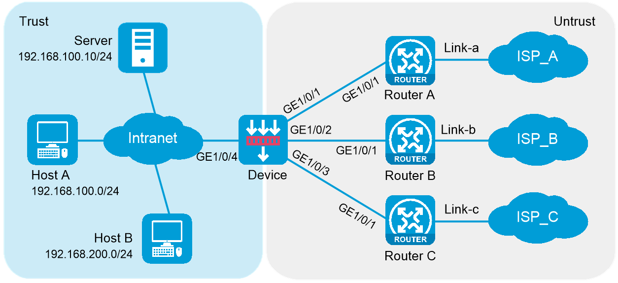

As shown in Figure 1, an enterprise accesses the external servers through ISP links Link_a, Link_b, and Link_c provided by ISP_A, ISP_B, and ISP_C, respectively. Configure outbound link load balancing to meet the following requirements:
The LB device distributes outbound traffic to external servers matching ISP_A, ISP_B, and ISP_C through Link_a, Link_b, and Link_c, respectively.

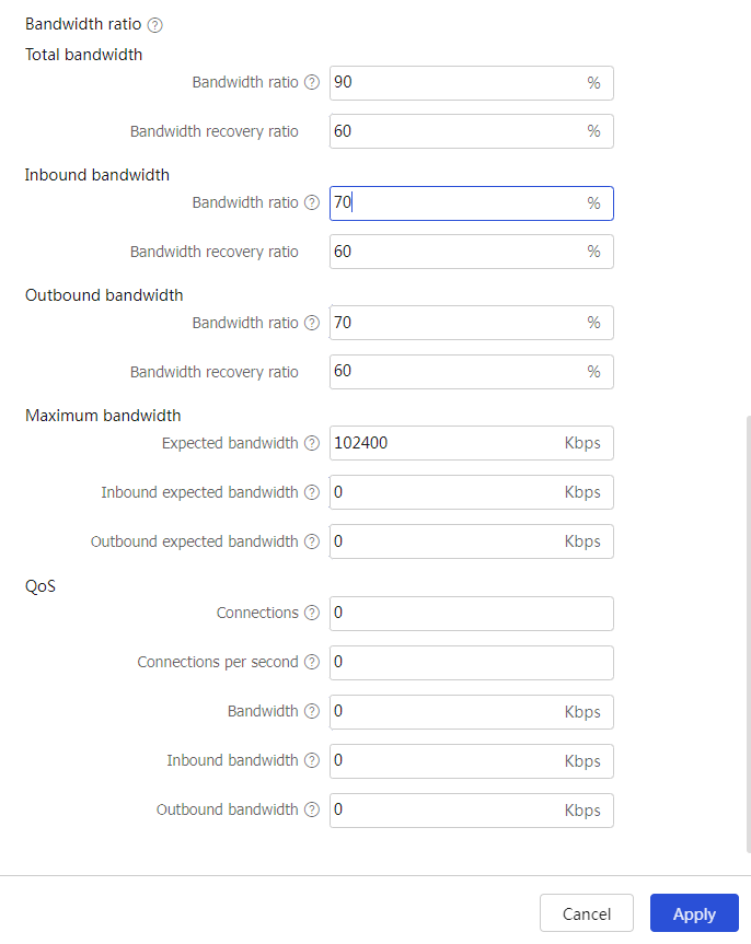

Host B (with IP address 192.168.200.0/24 in the finance department) needs to access online payment services. To avoid frequent egress IP address changes, the LB device distributes finance data traffic through Link_a. When the bandwidth usage on Link_a exceeds, the LB device distributes consequent traffic to Link_b.
Device |
Interface |
IP address |
Device |
Interface |
IP address |
Device |
GE1/0/1 |
30.1.1.1/24 |
Router A |
GE1/0/1 |
30.1.1.2/24 |
Device |
GE1/0/2 |
20.1.1.1/24 |
Router B |
GE1/0/1 |
20.1.1.2/24 |
Device |
GE1/0/3 |
10.1.1.124 |
Router C |
GE1/0/1 |
10.1.1.2/24 |
Device |
GE1/0/4 |
192.168.100.82/24 |

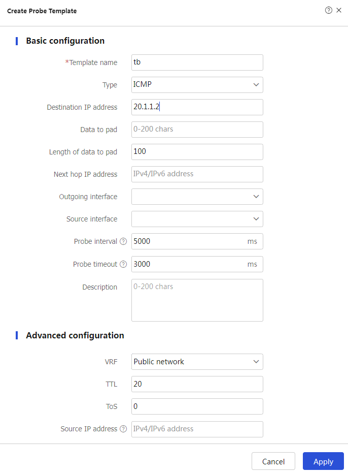

Configure ICMP probe templates.
# On the top navigation bar, click Objects.
# From the navigation pane, select Load Balancing > Health Monitoring.
# Click Create.
# In the dialog box that opens, configure an ICMP probe template named ta, as shown in Figure 2.
Figure 2 Creating probe template ta
# Click Apply.
# Configure an ICMP probe template named tb, as shown in Figure 3.
Figure 3 Creating probe template tb
# Click Apply.

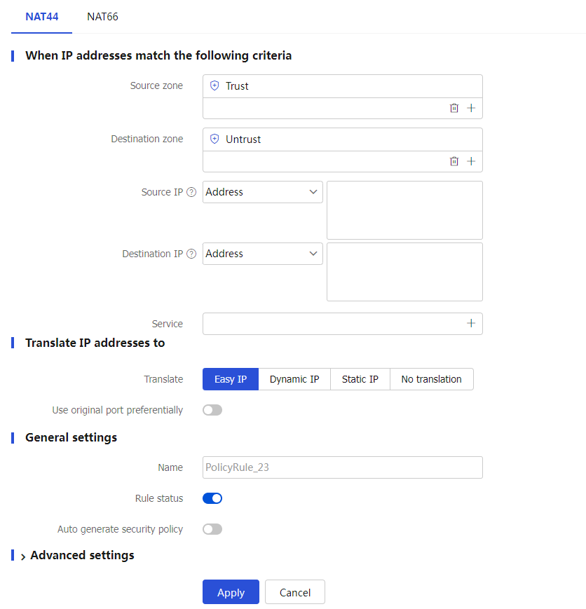

Configure outbound dynamic NAT rules.
# On the top navigation bar, click Policies.
# From the navigation pane, select Policy-based NAT.
# Click Create SNAT.
Figure 5 Configuring an outbound dynamic NAT rule named nat_ra
# Click Apply.

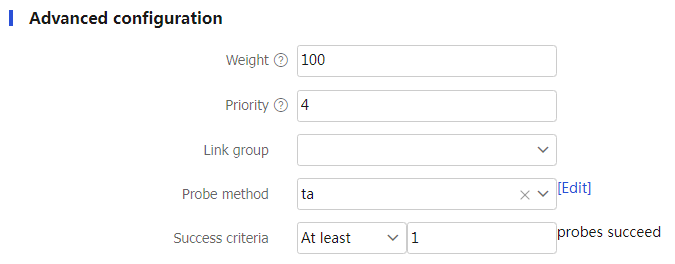

Configure links.
# On the top navigation bar, click Polices.
# From the navigation pane, select Load Balancing > Links.
# Click Create.

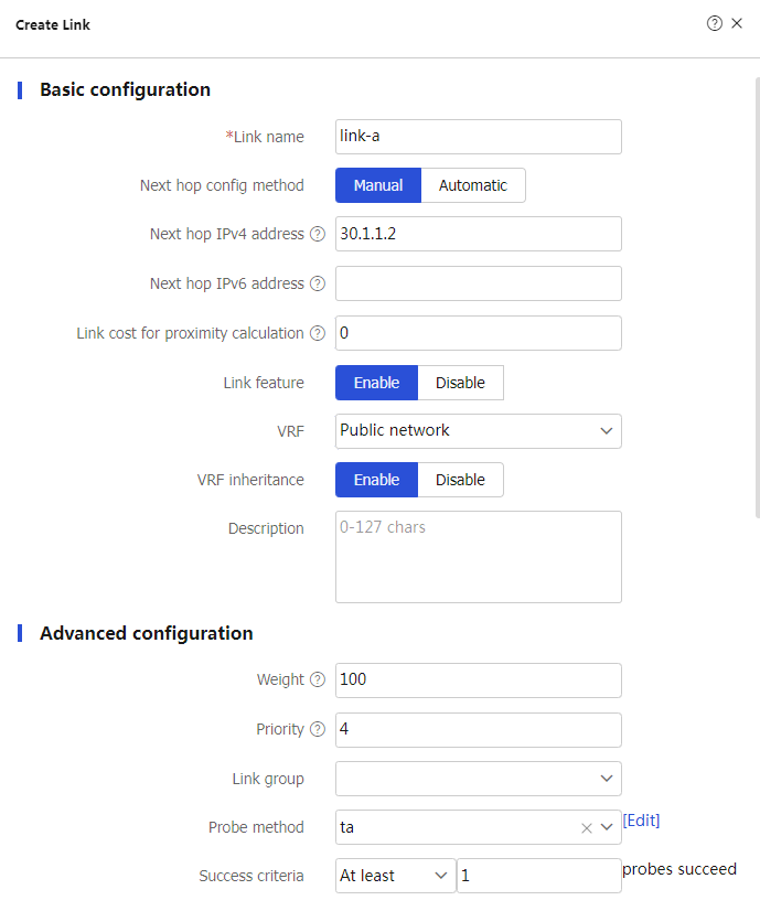

# In the dialog box that opens, configure a link named link-a as shown in Figure 8.
# Click OK.
# Click Create.
# In the dialog box that opens, configure a link named link-b as shown in Figure 9.
# Click OK.

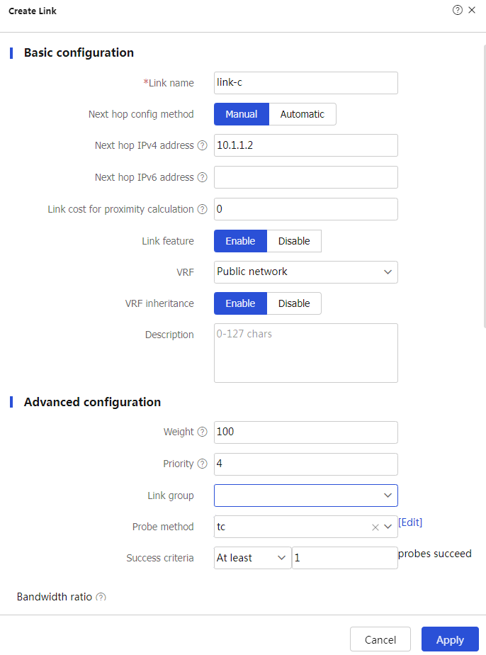

# Click Create.
# In the dialog box that opens, configure a link named link-c as shown in Figure 10.
# Click OK.

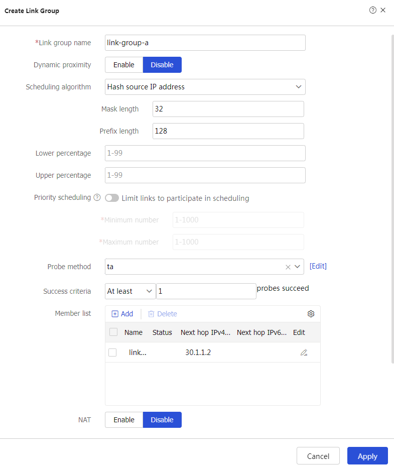

# On the Link Group tab, click Create.
# In the dialog box that opens, configure a link group named link-group-a as shown in Figure 11.
# Click OK.
Figure 9 Creating link group link-group-a

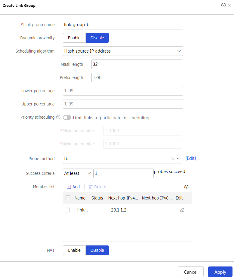

# In the dialog box that opens, configure a link group named link-group-b as shown in Figure 12.
# Click OK.
Figure 10 Creating link group link-group-b

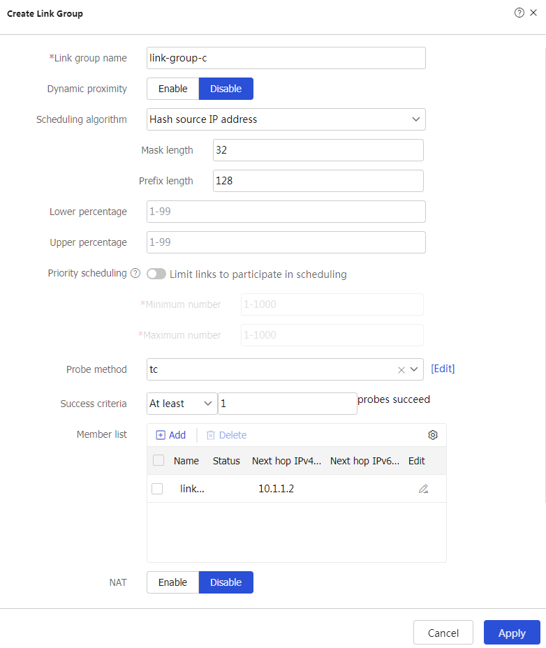

# In the dialog box that opens, configure a link group named link-group-c as shown in Figure 13
# Click OK.
Figure 11 Creating link group link-group-c

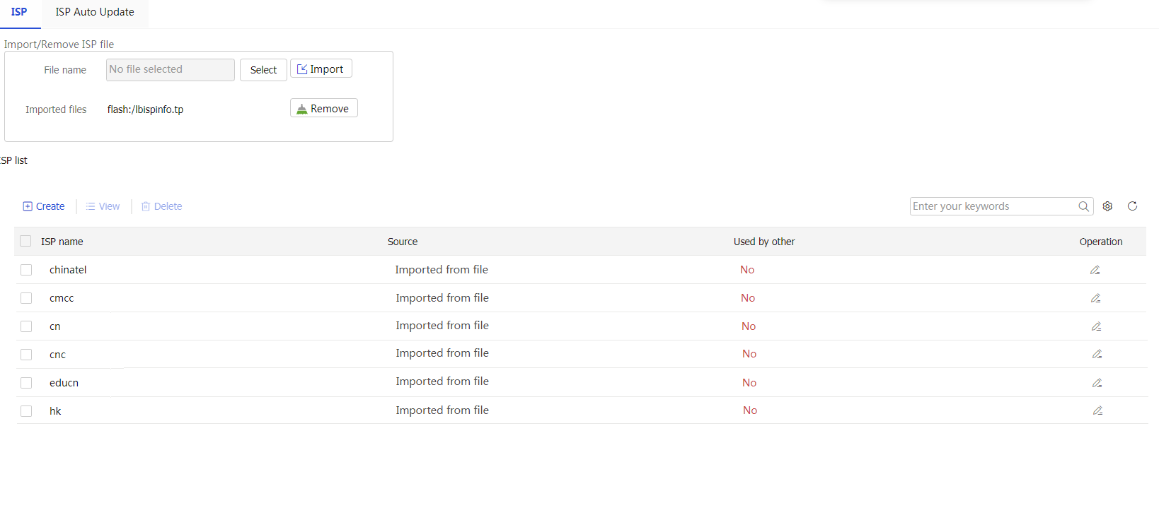

Import ISP information.
# From the navigation pane, select Load Balancing > ISP.
# Select file lbispinfo.tp.
# Click Import.
Figure 12 Importing ISP information

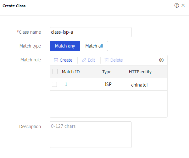

# On the Class tab, click Create.
# In the dialog box that opens, configure a class named class-isp-a as shown in Figure 15.
# Click OK.
Figure 13 Creating class class-isp-a

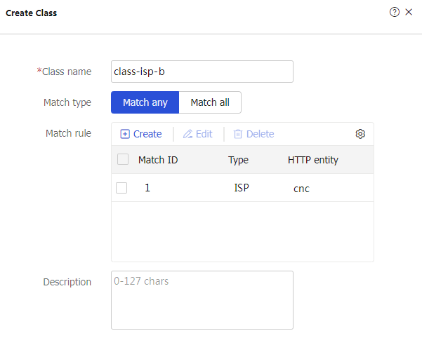

# In the dialog box that opens, configure a class named class-isp-b as shown in Figure 16.
# Click OK.

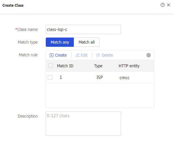

# In the dialog box that opens, configure a class named class-isp-c as shown in Figure 17.
# Click OK.
Figure 15 Creating class class-isp-c

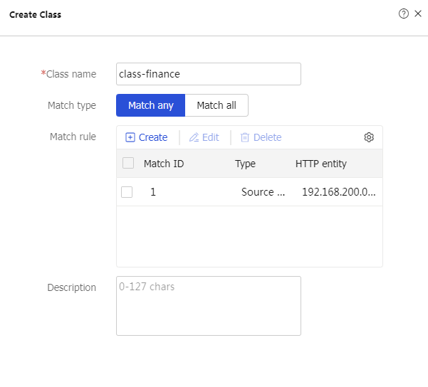

# In the dialog box that opens, configure a class named class-finance as shown in Figure 18.
# Click OK.

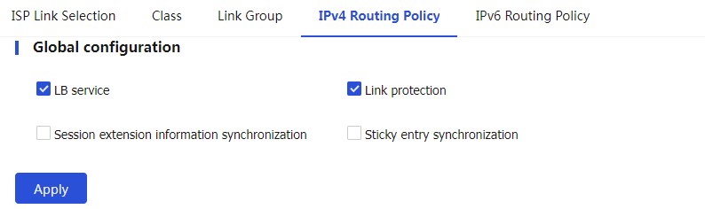

Configure IPv4 routing policies.
# From the navigation pane, select LB Policy > Link Load Balancing > Outbound Link LB.
# In the Global configuration area on the IPv4 Routing Policy tab, select LB service and Link protection.
Figure 17 Global configuration

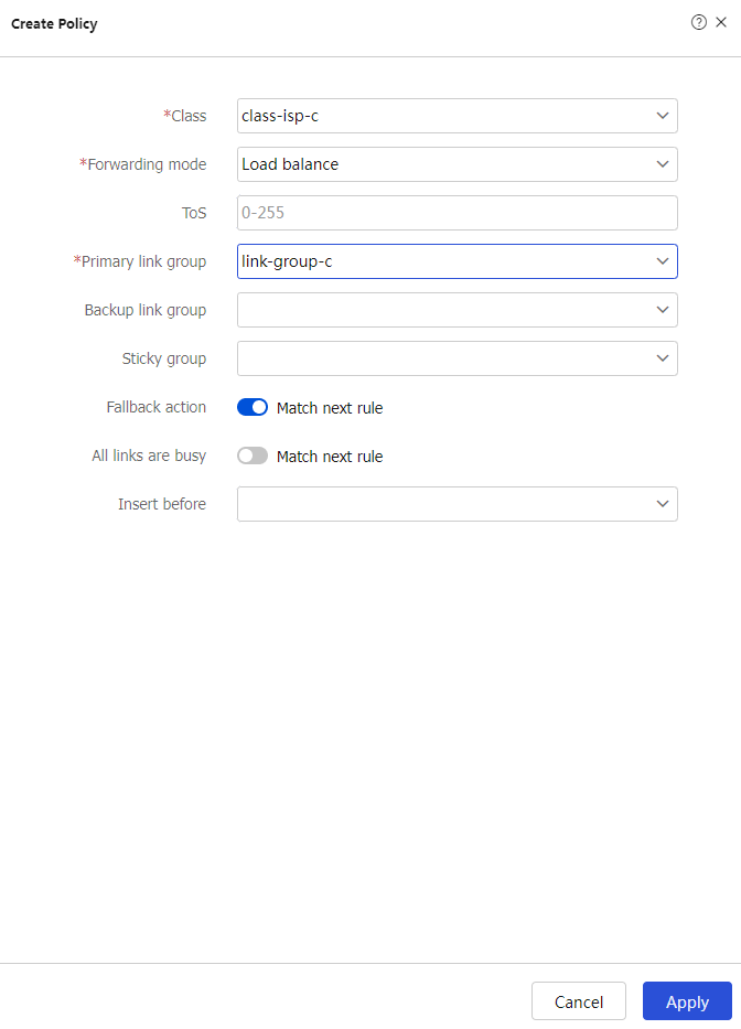

# In the Policy area on the IPv4 Routing Policy tab, click Create.
# In the dialog box that opens, configure an IPv4 routing policy for class class-isp-c:
Select class class-isp-c.
Select forwarding mode Load balance.
Select primary link group link-group-c.
Select Match next rule for the Fallback action field.
Click Apply.
Figure 21 Creating a policy for class class-isp-c

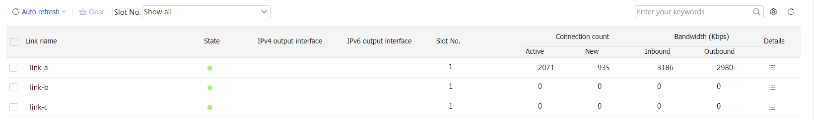

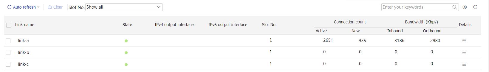

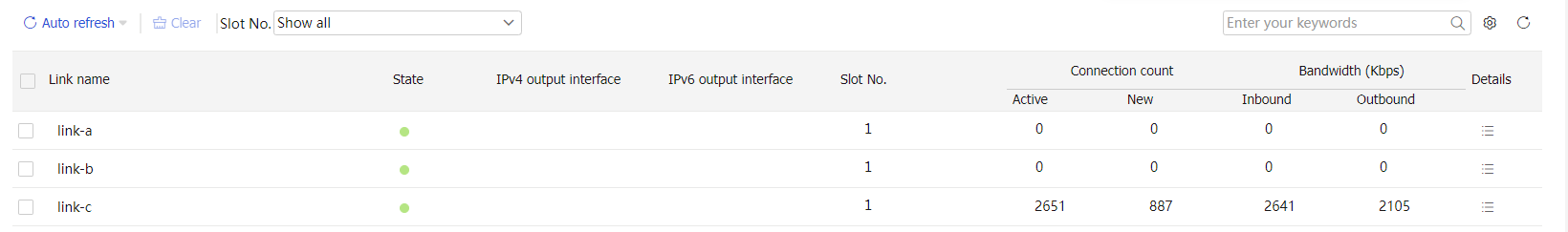

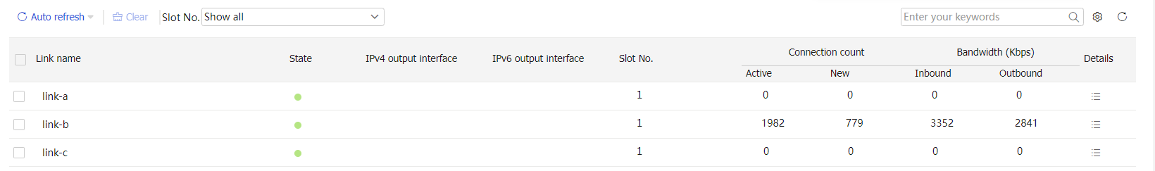

# On the top navigation bar, click the Monitor tab.
# From the navigation pane, select LB Monitor > Outbound Link LB Statistics > Links.
# View the statistics of link link-a as shown in Figure 25. Traffic from subnet 192.168.200.0/24 in the finance department matches class class-finance, and is distributed to link group link-group-a.
Figure 22 Statistics of traffic from the finance department
# View the statistics of link link-a as shown in Figure 26. Traffic destined for ISP-A matches class class-isp-a, and is distributed to link group link-group-a.
Figure 23 Statistics of traffic destined for ISP_A
# View the statistics of link link-b as shown in Figure 27. Traffic destined for ISP-B belongs to class class-isp-b, and is distributed to link group link-group-b.
Figure 24 Statistics of traffic destined for ISP_B
# View the statistics of link link-c as shown in Figure 28. Traffic destined for ISP_C belongs to class class-isp-c, and is distributed to link group link-group-c.
