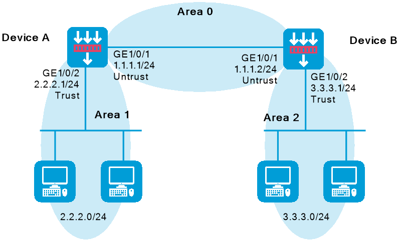

As shown in Figure-1, all devices run OSPF and the AS is divided into three areas. Device A and Device B act as ABRs to forward routes between areas. After configuration, each router should learn all routes to the AS.
Figure-1 Network diagram

  1. Configure IP addresses for interfaces correctly according to Figure-1.
