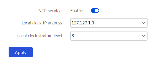

Click the
In the navigation pane, select
Enable NTP.
Figure-1 Enabling NTP
Select the local clock IP address. The IP address is 127.127.1.
Select the local clock stratum level. NTP uses the stratum level to define the clock accuracy. The smaller the stratum level, the higher the clock accuracy.
