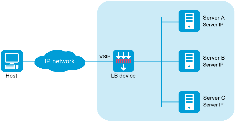

Gateway mode
In the gateway mode, the LB device is directly connected to the real servers and processes both of the requests and responses. When the LB device receives a user request, it uses the predefined health monitoring, sticky method, LB policy, and scheduling algorithm settings to calculate a real server for distributing the request. Then, the LB device sets the destination IP address of the request to the IP address of the calculated real server. When the LB device receives a response from the real server, it sets the source IP address to the VSIP.
Gateway-mode LB requires you to configure the default gateway or a static route for the real server. The real server can then send packets destined to the user through the LB device.
The gateway mode typically applies to small networks, because the deployment of the LB device changes the network topology.
Figure-1 Gateway-mode LB deployment
NAT-mode server load balancing contains the following elements:

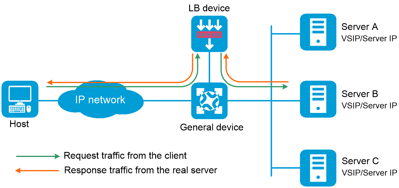

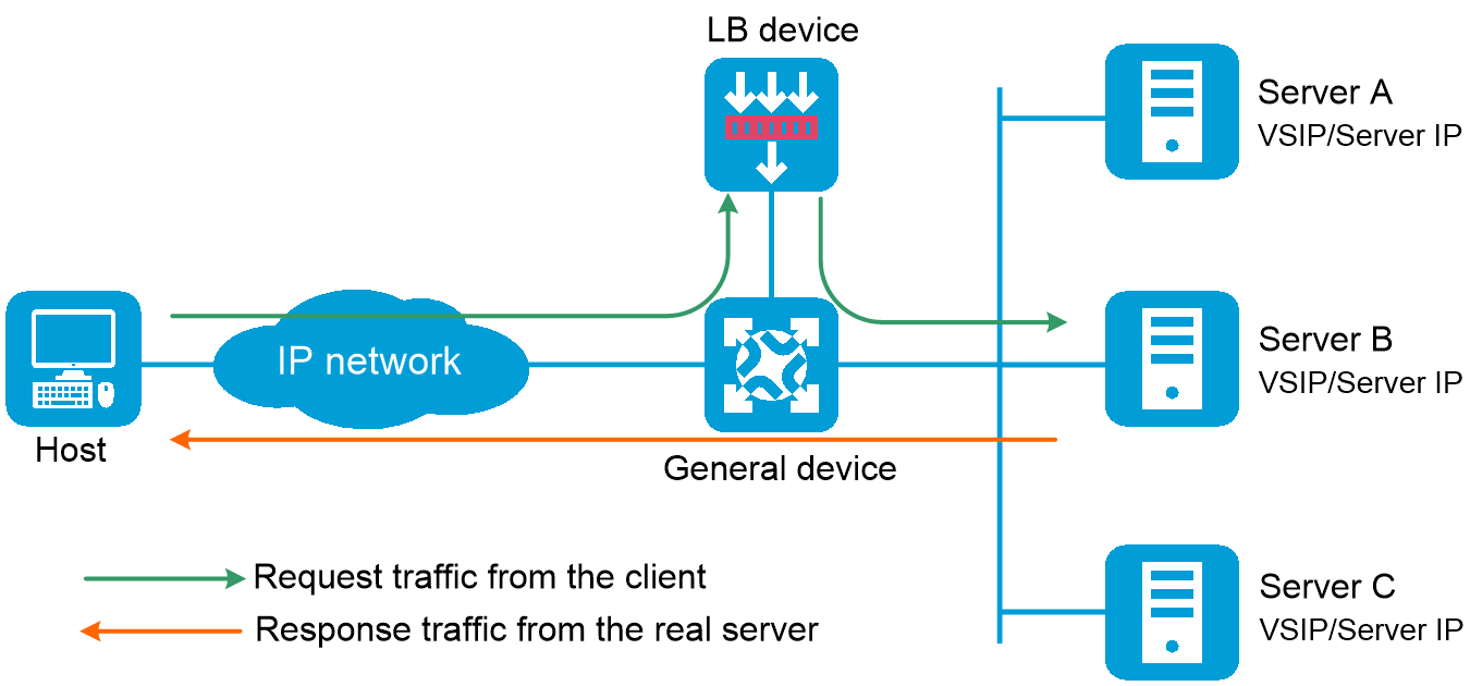

Triangle mode
In the triangle mode, the LB device is attached to the core switch and processes only user requests. The LB device does not process the responses from the real servers. When the LB device receives a request from the user, it uses the predefined health monitoring, sticky method, LB policy, and scheduling algorithm settings to calculate a real server for distributing the request. Then, the LB device distributes the request to the calculated real server, with the VSIP as the destination IP address but the MAC address of the real server as the destination MAC address. When the real server receives the request, it processes the request and sends a response directly to the user, with the VSIP as the source IP address and the user's IP address as the destination IP address.
Triangle-mode LB requires configuring the default gateway or a static route for the real server to send packets destined to the user through the gateway. In addition, you must configure the VSIP for the loopback interface on each real server.
The triangle mode is flexible, because the LB device deployment does not change the network topology. It typically applies to the scenarios with heavy traffic, such as video services, because the response traffic does not go through the LB device.
Figure-3 Triangle-mode LB deployment

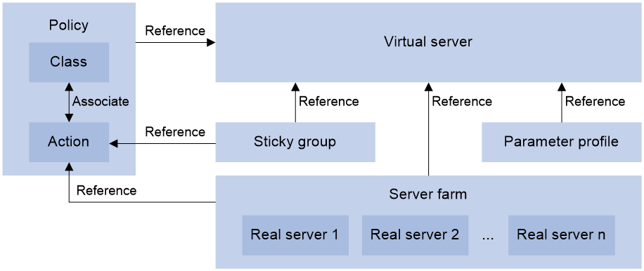

Relationship between the main configuration items
Figure-4 Relationship between the main configuration items

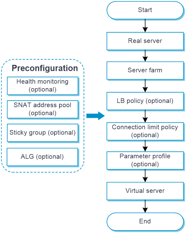

Configure server load balancing
Analysis
Configure server load balancing as shown in Figure-5.
Figure-5 Server load balancing configuration procedure
Complete the following tasks before you configure this feature:

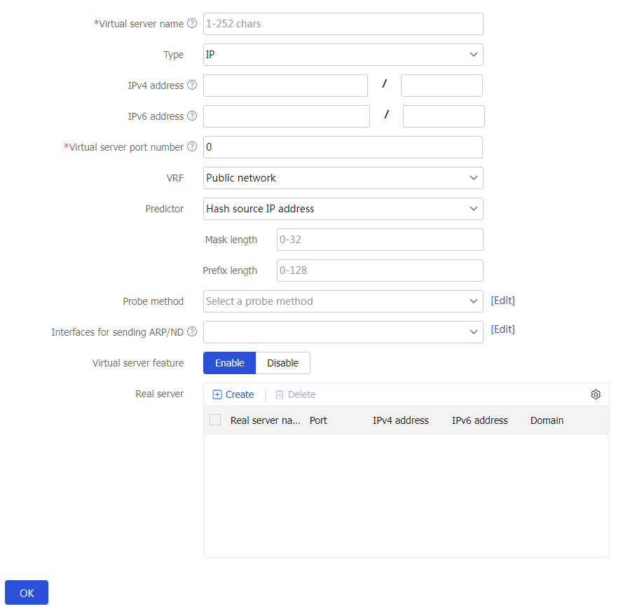

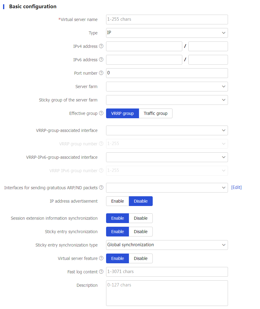

Configure a virtual server
A virtual server is a virtual service provided by the LB device to determine whether to perform load balancing for packets received on the LB device. Only the packets that match a virtual server are load balanced.
To configure a virtual server:
  1. Select Policies > LB Policy > Server Load Balancing > Virtual Servers.
  2. Click Create.
  3. Create a virtual server and configure basic virtual server settings.
    Figure-7 Basic virtual server settings
    Table-1 Basic configuration items
    Item
    Description
    Virtual server name
    Enter a name for the virtual server, case insensitive.
    Type
    Specify the virtual server type, which can be IP, TCP, UDP, SIP-TCP, SIP-UDP, HTTP, Performance (HTTP), HTTPS, HTTP redirection, RADIUS, MySQL, or Diameter.
    IPv4 address
    Configure an IPv4 address/mask length (0-32) for the virtual server.
    IPv6 address
    Configure an IPv6 address/prefix length (0-128) for the virtual server.
    Port number
    Configure the port number of the virtual server. 0 indicates any port.
    For the IP, TCP, UDP, and RADIUS virtual server types, you can enter a comma-separated list of up to 32 port number items. Each item specifies a port number or a range of port numbers, for example, 5,10,20-28.
    UDP per-packet load balancing
    Enable or disable per-packet load balancing for UDP traffic for a virtual server.
    When per-packet load balancing for UDP traffic is disabled, the LB device distributes traffic matching the virtual server according to application type. Traffic of the same application type is distributed to one real server. When per-packet load balancing for UDP traffic is enabled, the LB device distributes traffic matching the virtual server on a per-packet basis.
    This parameter is supported only by virtual servers of the UDP type, SIP-UDP type, and RADIUS type.
    SSL server policy
    Specify an SSL server policy for a virtual server to encrypt traffic between the LB device (SSL server) and the SSL client.
    You can select an existing SSL server policy or create an SSL server policy.
    This parameter is supported only by virtual servers of the TCP, HTTPS, and Diameter types.
    Redirection URL
    Specify a redirection URL for the virtual server, case sensitive. The redirection feature redirects all request packets matching the virtual server to the URL.
    You can also specify the question mark (?) or the following character strings as the redirection URL:
    • %h: Specifies the host name in the client request packet.
    • %p: Specifies the URL in the client request packet.
    • %%: Specifies the percentage sign (%).
    This parameter is supported only by virtual servers of the HTTP redirection type.
    Redirection mode
    Specify a redirection mode for the virtual server.
    • Temporary-302
    • Temporary-307
    • Permanent-301
    Server farm
    Select an existing server farm or create a server farm for the virtual server.
    This parameter is not supported by virtual servers of the HTTP redirection or Diameter type.
    Sticky group of the server farm
    Select an existing sticky group or create a sticky group as the primary sticky group for the server farm.
    VRRP-group-associated interface
    Specify the interface to be associated with the VRRP group.
    If you configure this parameter, you must bind a VRRP group number to the virtual server.
    VRRP group number
    Specify the number of the VRRP group to be bound to the virtual server.
    In a dual-active-mode hot backup system, both devices back up each other and process services. If you do not bind a VRRP group number to the virtual server, both devices process services and use the SNAT address pool. If you bind a VRRP group number to the virtual server, only the primary device processes services and uses the SNAT address pool. For more information about the hot backup system, see its online help.
    You can configure this parameter only after you specify a VRRP-group-associated interface.
    VRRP-IPv6-group-associated interface
    Specify the interface to be associated with the IPv6 VRRP group.
    If you configure this parameter, you must bind an IPv6 VRRP group number to the virtual server.
    VRRP IPv6 group number
    Specify the number of the IPv6 VRRP group to be bound to the virtual server.
    In a dual-active-mode hot backup system , both devices back up each other and process services. If you do not bind an IPv6 VRRP group number to the virtual server, both devices process services and use the SNAT address pool. If you bind an IPv6 VRRP group number to the virtual server, only the primary device processes services and uses the SNAT address pool. For more information about the hot backup system, see its online help.
    This setting applies only to virtual servers with IPv6 addresses.
    You can configure this parameter only after you specify an VRRP-IPv6-group-associated interface.
    MySQL version
    Specify the MySQL database version.
    The LB device initiates authentication to clients on behalf of the MySQL server and sends database initialization packets of the specified MySQL version to clients.
    This parameter is supported only by MySQL virtual servers.
    Read/Write splitting
    Enable or disable read/write splitting.
    This feature allows read commands and write commands to be executed by the read server farm and write server farm, respectively.
    This feature helps reduce the impact of concurrent read/write requests on database performance.
    After this feature is enabled, you must configure both a read server farm and a write server farm.
    Read server farm
    Select an existing server farm or create a server farm as the read server farm for the virtual server.
    This parameter is available only when read/write splitting is enabled.
    Read sticky group
    Select an existing sticky group or create a sticky group as the read sticky group for the virtual server.
    Write server farm
    Select an existing server farm or create a server farm as the write server farm for the virtual server.
    This parameter is available only when write/write splitting is enabled.
    Write sticky group
    Select an existing sticky group or create a sticky group as the write sticky group for the virtual server.
    Interfaces for sending gratuitous ARP/ND packets
    Specify interfaces for sending gratuitous ARP packets and ND packets.
    If the IP address of an interface connected to a client is in the same network segment as the virtual server IP address, you must perform the following tasks:
    • Specify the interface connected to the corresponding client as an interface for sending gratuitous ARP/ND packets.
    • Enable IP address advertisement.
    Operation mode
    Operating mode of the virtual server:
    • Layer 4.
    • Layer 7.
    This parameter is supported only by TCP virtual servers.
    If you configure a TCP virtual server to operate at Layer 7, you must also specify a non-zero port number or a range of port numbers for the TCP virtual server.
    Enable proxy protocol
    After you enable the proxy protocol for the TCP virtual server, the device transparently transmits the actual source IP addresses to the real servers.
    To avoid connection failures, make sure the real servers support the proxy protocol of the specified version before you enable it.
    This parameter is available only for TCP virtual servers with the operation mode of Layer 7.
    Enable or disable IP address advertisement for the virtual server.
    After this feature is configured, the device advertises the IP address of the virtual server to OSPF for route calculation. When the service of a data center switches to another data center, the traffic to the virtual server can also be switched to that data center.
    Redundancy group traffic distribution
    Select an existing redundancy group or create a redundancy group. The traffic matching the virtual server is directed to the specified redundancy group.
    If the redundancy group does not exist or contains no effective failover groups, this function does not take effect.
    Support for this function depends on the device model.
    Session extension information synchronization
    Enable or disable session extension information synchronization for the virtual server.
    This parameter is supported only by virtual servers of the IP, TCP, UDP, SIP-TCP, SIP-UDP, and RADIUS types.
    Sticky entry synchronization
    Enable or disable sticky entry synchronization for the virtual server.
    The following configuration changes will cause the device to delete existing sticky entries and generate new ones based on subsequent traffic:
    • Disable sticky entry synchronization.
    • Change the sticky entry synchronization type.
    Virtual servers of the HTTP redirection type do not support this function.
    Sticky entry synchronization type
    Select the sticky entry synchronization type:
    • Intra-group synchronization—Synchronizes sticky entries to the device in the same failover group.
    • Global synchronization—Synchronizes sticky entries to devices in all failover groups.
    This function is available only when sticky entry synchronization is enabled.

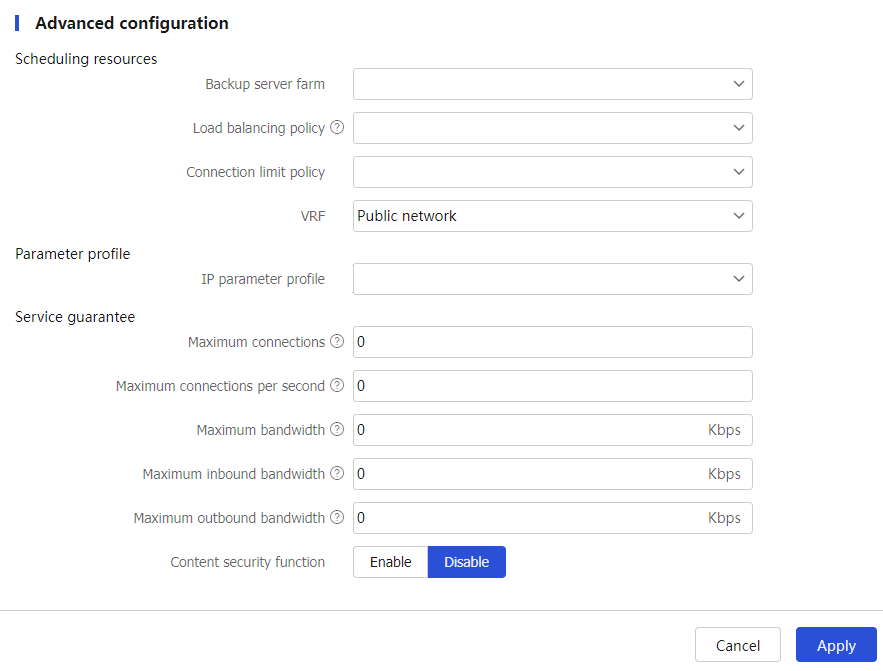

    Virtual server feature
    Enable or disable the virtual server.
    After you configure a virtual server, you must enable the virtual server for it to work.
    Reset connection
    Enable or disable resetting connections upon virtual server unavailability.
    With this feature enabled, the device immediately responds with an RST packet upon receiving a SYN packet and tears down the connection if the virtual server is unavailable.
    This parameter is available only for virtual servers of the TCP, SIP-TCP, HTTP, HTTPS, and Performance (HTTP) types.
    Fast log output
    Configure the content to be output by using the fast log output feature.

  4. (Optional.) Configure advanced virtual server settings.
    Figure-8 Advanced virtual server settings
    Table-2 Advanced configuration items
    Item
    Description
    Insert X-Forwarded-For
    Enable or disable source IP address insertion into the X-Forwarded-For field of the HTTP headers.
    With this feature enabled, the device inserts the client source IP address into the X-Forwarded-For field of the HTTP headers when receiving a request from the client.
    This parameter is supported only by virtual servers of the HTTP and HTTPS types.
    Scheduling resources-Backup server farm
    Specify the backup server farm for the virtual server.
    When the primary server farm is available (contains real servers), the virtual server forwards packets through the primary server farm. When the primary server farm is not available, the virtual server forwards packets through the backup server farm.
    You can select an existing server farm or create a server farm.
    This parameter is not supported by virtual servers of the Diameter type.
    Scheduling resources-Backup sticky group of the server farm
    Specify the backup sticky group for the server farm.
    If you specify both a primary sticky group and a backup sticky group, the device generates both primary sticky entries and backup sticky entries. If packets do not match primary sticky entries, backup sticky entries are used to match the packets.
    This parameter is supported only by virtual servers of the HTTP, HTTPS, and RADIUS types.
    Scheduling resources-Load balancing policy
    Specify an LB policy for the virtual server.
    By using an LB policy, the virtual server implements load balancing for matching packets based on the packet contents.
    You can select an existing LB policy or create an LB policy.
    A virtual server can use the policy template of the specified type. For example, a virtual server of the Performance (HTTP) or HTTP type can use a policy template of the generic type or HTTP type. A virtual server of the IP, TCP, UDP, SIP-TCP, or SIP-UDP type can use a policy template of the generic type only. A virtual server of the RADIUS type can use a policy template of the generic or RADIUS type only. A virtual server of the Diameter type can use a policy template of the Diameter type only.

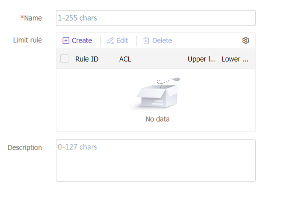

    Scheduling resources-Connection limit policy
    Specify a connection limit policy for the virtual server to limit the number of connections on the virtual server.
    You can select an existing connection limit policy or create a connection limit policy.
    Scheduling resources-SSL client policy
    Specify an SSL client policy for the virtual server to encrypt traffic between the LB device (SSL client) and the SSL server.
    You can select an existing SSL client policy or create an SSL client policy.
    This parameter is supported only by virtual servers of the HTTP or HTTPS type.
    Scheduling resources-SSL server policy with SNI
    Configure an SSL server policy with an SNI for the virtual server.
    1. Click Add to create an SSL server policy with an SNI.
      • Policy name: Enter a policy name, case insensitive.
      • Server name indication (SNI): Enter an SNI, case insensitive.
    2. Click OK. The new SSL server policy appears in the policy list.
    If you configured both an SSL server policy without an SNI and an SSL server policy with an SNI, the SSL server policy with an SNI takes effect.
    You cannot configure multiple SSL server policies with the same SNI for a virtual server.
    This parameter is supported only by virtual servers of the HTTPS type.
    Scheduling resources-Cookie sticky group
    Specify a cookie sticky group for the virtual server.
    You can also specify sticky groups to be associated with server farms on the Create Virtual Server page or Create Action page. The cookie sticky group specified for the virtual server has the highest priority. It is preferentially used to generate sticky entries.
    Only cookie sticky groups can be specified for this parameter.
    Cookie sticky groups with the cookie get sticky method cannot be specified for this parameter.
    Scheduling resources-VPN instance
    Specify a VPN instance for the virtual server.
    You can select an existing VPN instance or create a VPN instance.

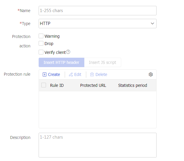

    Protection policy-HTTP protection policy
    Specify an HTTP protection policy for the virtual server to guard against attack traffic matching the protection policy.
    You can select an existing HTTP protection policy or create an HTTP protection policy.

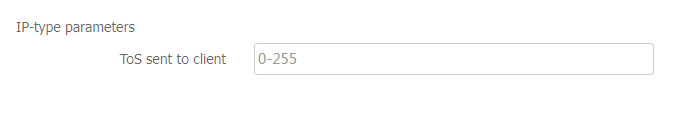

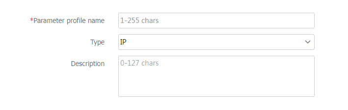

    Parameter profile-IP parameter profile
    Specify an IP parameter profile for the virtual server to process matching traffic based on the parameter profile.
    You can select an existing IP parameter profile or create an IP parameter profile.

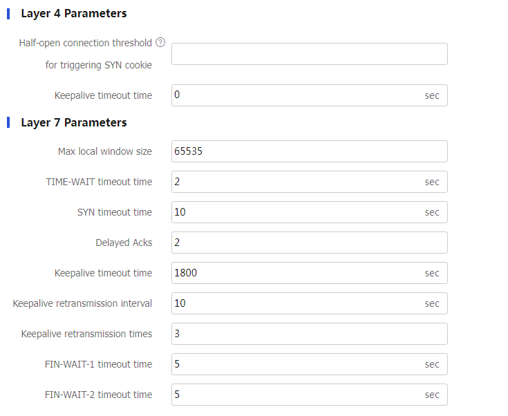

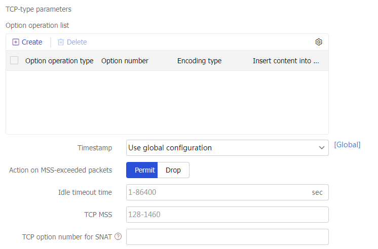

    Parameter profile-TCP parameter profile
    Specify a TCP parameter profile for the virtual server to process and optimize matching traffic based on the parameter profile.
    You can select an existing TCP parameter profile or create a TCP parameter profile.
    This parameter is supported only by TCP virtual servers with the operation mode of Layer 4.
    Parameter profile-TCP parameter profile (client side)
    Specify a TCP parameter profile for the virtual server to process matching traffic based on the parameter profile. A TCP parameter profile (client) used by the virtual server processes and optimizes TCP connections between the device and the client.
    This parameter is supported only by Performance (HTTP), HTTP, HTTPS, MySQL, Diameter virtual servers, and TCP virtual servers with the operation mode of Layer 7.
    Parameter profile-TCP parameter profile (server side)
    Specify a TCP parameter profile for the virtual server to process matching traffic based on the parameter profile. A TCP parameter profile (server) used by the virtual server processes and optimizes TCP connections between the device and the server.
    This parameter is supported only by Performance (HTTP), HTTP, HTTPS, MySQL virtual servers, and TCP virtual servers with the operation mode of Layer 7.

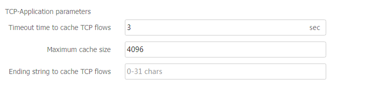

    Parameter profile-TCP-application parameter profile
    Specify a TCP-application parameter profile for the virtual server to process matching traffic based on the parameter profile.
    You can select an existing TCP-application parameter profile or create a TCP-application parameter profile.
    This parameter is supported only by TCP virtual servers operating at Layer 7.
    Parameter profile-HTTP parameter profile
    Specify an HTTP parameter profile for the virtual server to process matching traffic based on the parameter profile.
    You can select an existing HTTP parameter profile or create an HTTP parameter profile.
    This parameter is supported only by virtual servers of the Performance (HTTP), HTTP, or HTTPS type.

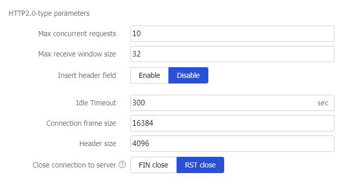

    Parameter profile-HTTP2 parameter profile (client side)
    Specify an HTTP/2 parameter profile on the client side for the virtual server. The device processes and optimizes HTTP/2 packets from the clients based on the specified parameter profile and sends HTTP/1.0 or HTTP/1.1 packets to the real servers.
    You can select an existing HTTP/2 parameter profile or create an HTTP/2 parameter profile.
    Parameter profile-HTTP2 parameter profile (server side)
    Specify an HTTP/2 parameter profile on the server side for the virtual server. After you specify HTTP/2 parameter profiles on both the client and server sides, the device processes and optimizes HTTP/2 packets from the clients based on the specified parameter profile and sends HTTP/2 packets to the real servers. If you specify an HTTP/2 parameter profile only on the server side but not on the client side for the virtual server, the specified parameter profile does not take effect.
    Parameter profile-HTTP statistics parameter profile
    Specify an HTTP statistics parameter profile for the virtual server to process matching traffic based on the parameter profile.
    You can select an existing HTTP statistics parameter profile or create an HTTP statistics parameter profile.
    Parameter profile-HTTP compression parameter profile
    Specify an HTTP compression parameter profile for the virtual server to process matching traffic based on the parameter profile.
    You can select an existing HTTP compression parameter profile or create an HTTP compression parameter profile.

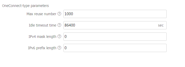

    Parameter profile-OneConnect parameter profile
    Specify a OneConnect parameter profile for the virtual server to process matching traffic based on the parameter profile.
    You can select an existing OneConnect parameter profile or create a OneConnect parameter profile.

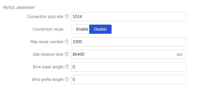

    Parameter profile-MySQL parameter profile
    Specify a MySQL parameter profile for the virtual server to process matching traffic based on the parameter profile.
    You can select an existing MySQL parameter profile or create a MySQL parameter profile.
    This parameter is supported only by virtual servers of the MySQL type.

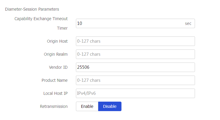

    Parameter profile-Diameter-Session parameter profile
    Specify a Diameter-Session parameter profile for the virtual server to process matching traffic based on the parameter profile.
    You can select an existing Diameter-Session parameter profile or create a Diameter-Session parameter profile.
    This parameter is supported only by virtual servers of the Diameter type.
    QoS-Maximum connections
    Specify the maximum number of connections for the virtual server. 0 means not limited.
    QoS-Maximum connections per second
    Specify the maximum number of connections per second for the virtual server. 0 means not limited.
    QoS-Maximum bandwidth
    Specify the maximum bandwidth for the virtual server. 0 means not limited.
    Virtual servers of the HTTP redirection or Diameter type do not support this function.
    QoS-Maximum inbound bandwidth
    Specify the maximum inbound bandwidth for the virtual server. 0 means not limited.
    QoS-Maximum outbound bandwidth
    Specify the maximum outbound bandwidth for the virtual server. 0 means not limited.
    External link domain name rewrite
    Enable or disable external link proxy.
    The external link proxy feature enables an LB device to operate as an external link proxy to request IPv4 resources on behalf of IPv6 clients. This feature helps achieve smooth IPv4-to-IPv6 network transition.
    This parameter is supported only by HTTP virtual servers.
    When the LB device detects an external link in the HTTP response from the server, it returns a script file for rewriting the external link. The client executes the script file and adds the specified parameters to the domain name of the external link. The parameters include the URI, domain name suffix, and virtual server port number. Upon receiving a DNS request containing the modified domain name, the LB device will request the associated IPv4 resource on behalf of the IPv6 client.
    The format of the domain name after rewrite is protocol type://original domain name+URI+domain name suffix+:virtual server port number. The protocol type can be HTTP or HTTPS.
    Suppose the protocol type is HTTP, domain name of the original external link is www.example1.com, URI is proxy, domain name suffix is example2.com, and virtual server port number is 8080. The external link domain name after rewrite is http://www.example1.com.proxy.example2.com:8080.
    URI
    Specify the URI for rewriting domain names of external links. The URI is a case-insensitive string that can contain only letters, digits, hyphens (-), and underscores (_).
    Upon receiving a response from the IPv6 site server, the LB device rewrites the IPv4 external link in the response by adding the specified parameters to the associated domain name. The parameters include the URI, domain name suffix, and virtual server port number. Suppose the domain name of the original external link is http://www.example1.com, URI is proxy, domain name suffix is example2.com, and virtual server port number is 8080. The external link domain name after rewrite is http://www.example1.com.proxy.example2.com:8080. Upon receiving a DNS request containing this modified domain name, the LB device performs the following operations:
    1. Extracts the original domain name.
    2. Requests the associated IPv4 resource on behalf of the IPv6 client.
    3. Returns the obtained IPv4 resource to the IPv6 client.
    Domain name suffix
    Specifies the domain name suffix for rewriting domain names of external links.
    The domain name suffix is a case-insensitive, dot-separated string. Each dot-separated label in the domain name can contain a maximum of 63 characters. The domain name can contain letters, digits, hyphens (-), underscores (_), and dots (.).

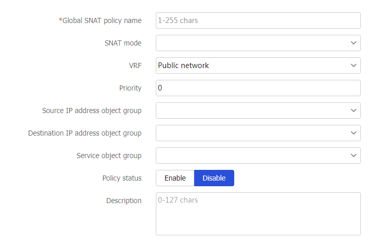

    SNAT address pool
    Specify a SNAT address pool for external link proxy.
    To request an IPv4 resource as an external link proxy, the LB device will choose an IP address from the specified SNAT pool. The LB device uses this IP address as the client IP address to initiate a request on behalf of the IPv6 client.
    If you do not specify a SNAT address pool, the LB device uses the IP address of the output interface to the server as the client IP address.
    Allowlists
    Add a domain name to the allowlist for external link proxy.
    1. Enter a domain name, a case-insensitive, dot-separated string. Each dot-separated label in the domain name can contain a maximum of 63 characters. The domain name can contain letters, digits, hyphens (-), underscores (_), and dots (.).
    2. Click Add. The domain name appears in the Allowlists.
    The LB device does not rewrite the external links containing any domain names in the allowlist.
  5. Click OK. The new virtual server appears on the Virtual Server page.

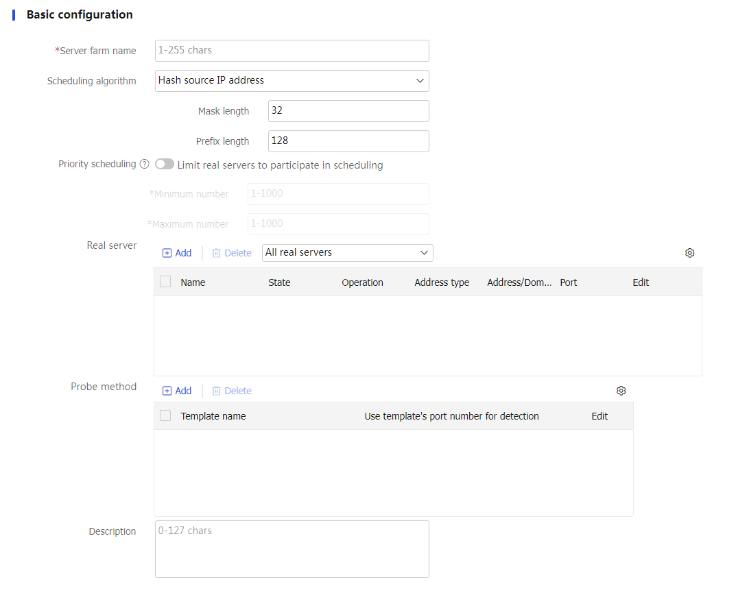

  3. Create a server farm and configure basic server farm settings.
    Figure-9 Basic server farm settings
    Table-3 Basic configuration items
    Item
    Description

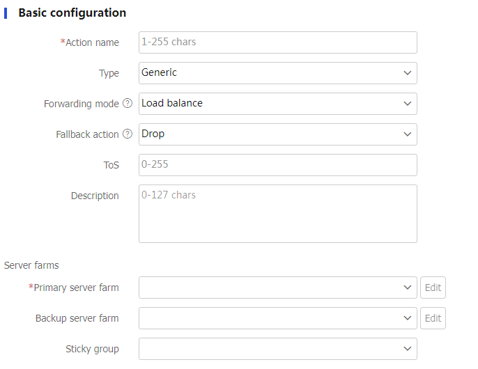

    Server farm name
    Enter a name for the server farm, case insensitive.
    Scheduling algorithm
    Select a scheduling algorithm for the server farm.
    • Round robin—Assigns user requests to real servers based on the weights of real servers. A higher weight indicates more user requests will be assigned.
    • Random—Randomly assigns user requests to real servers.
    • Weighted least connections—Always assigns user requests to the real server with the fewest number of weighted active connections (the number of active connections divided by weight). The weight used by this algorithm is configured on the Create Real Server page.
    • Bandwidth—Distributes user requests to real servers according to the product ratio of the weights and remaining bandwidth of real servers. For example, if the remaining bandwidths for real servers rs1 and rs2 are 150 kbps and 250 kbps, respectively, and their weights are 5 and 6, the traffic distribution ratio is 150×5:250×6, which is 1:2.
    • Maximum bandwidth—Distributes user requests always to an idle real server that has the largest remaining bandwidth. For example, if the remaining bandwidths of real servers rs1 and rs2 are 150 kbps and 250 kbps, respectively, the bandwidth difference is 100 kbps.
      • When the request traffic is less than 100 kbps, all traffic is allocated to rs2.
      • When the request traffic is more than 100 kbps, such as 130 kbps, 100 kbps is allocated to rs2, and the remaining 30 kbps is evenly distributed between both servers.
    • Dynamic feedback—Assigns new connections to real servers based on load weight values calculated by using the memory, CPU, and disk usage of the real servers. The less the load, the greater the weight value. A real server with a greater weight value is assigned more connections.
    • Least time—Assigns new connections to real servers based on load weight values calculated by using the response time of the real servers. The shorter the response time, the greater the weight value. A real server with a greater weight value is assigned more connections.
    • Source IP address hash—Hashes the source IP address of user requests and distributes user requests to different real servers according to the hash values. This algorithm applies to a scenario where user requests with the same source IP address need to be distributed to the same real server.
    • Source IP address CARP hash—Hashes the source IP address of user requests and distributes user requests to different real servers according to the CARP hash values. This algorithm applies to a scenario where user requests with the same source IP address need to be distributed to the same real server. When the number of available real servers changes, this algorithm makes all available real servers have the smallest load changes.
    • Source IP address and port number hash—Hashes the source IP address and port number of user requests and distributes user requests to different real servers according to the hash values. This algorithm applies to a scenario where user requests with the same source IP address and port number need to be distributed to the same real server.
    • Source IP address and port number CARP hash—Hashes the source IP address and port number of user requests and distributes user requests to different real servers according to the CARP hash values. This algorithm applies to a scenario where user requests with the same source IP address and port number need to be distributed to the same real server. When the number of available real servers changes, this algorithm makes all available real servers have the smallest load changes.
    • Destination IP address hash—Hashes the destination IP address of user requests and distributes user requests to different real servers according to the hash values. This algorithm applies to a scenario where a client needs to communicate with a real server repeatedly.
    • Destination IP address CARP hash—Hashes the destination IP address of user requests and distributes user requests to different real servers according to the CARP hash values. This algorithm applies to a scenario where a client needs to communicate with a real server repeatedly. When the number of available real servers changes, this algorithm makes all available real servers have the smallest load changes.
    • HTTP hash—Hashes the content of user requests and distributes user requests to different real servers according to the hash values. This scheduling algorithm takes effect only for an HTTP virtual server.
    • HTTP CARP hash—Hashes the content of user requests and distributes user requests to different real servers according to the CARP hash values. When the number of available real servers changes, this algorithm makes all available real servers have the smallest load changes. This scheduling algorithm takes effect only for an HTTP virtual server.
    • Weighted least connections (member)—Always assigns user requests to the real server with the fewest number of weighted active connections (the number of active connections divided by weight). The weight used by this algorithm is configured on the Real Server page.
    • Least time (member)—Always assigns user requests to real servers based on load weight values calculated by using the response time of the real servers. The shorter the response time, the greater the weight value. A real server with a greater weight value is assigned more connections.

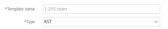

    To create a probe template:
    1. Click Add.
      • Template name: Enter a name for the probe template.
      • Use template's port number for detection: If you select this option, the destination port number specified in the template is used for detection. If you do not select this option, the real server's port number is used for detection.
    2. Click OK. The new probe template appears on the Health Monitoring page.

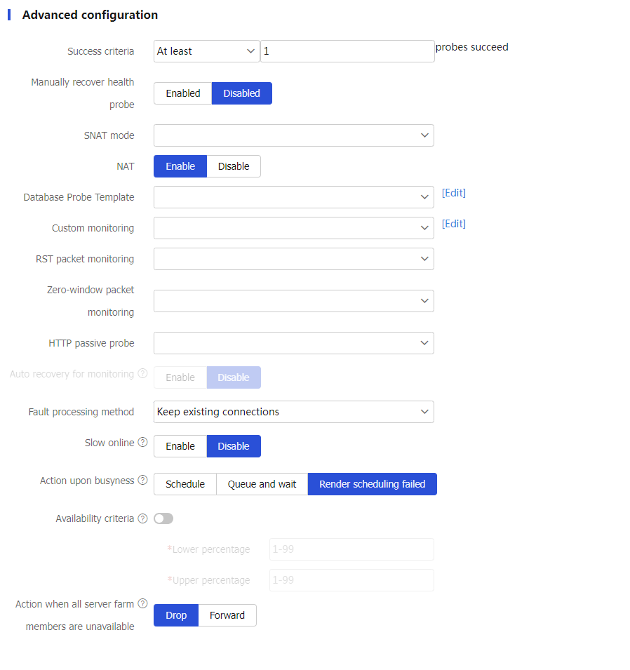

  4. (Optional.) Configure advanced server farm settings.
    Figure-10 Advanced server farm settings
    Table-4 Advanced configuration items
    Item
    Description
    Success criteria
    Specify the health monitoring success criteria for the real server.
    • All probes succeed: Health monitoring succeeds only when all the specified health monitoring methods succeed.
    • At least n probes succeed: Health monitoring succeeds when a minimum of the specified number of health monitoring methods succeed. When the specified number of health monitoring methods is greater than the number of health monitoring methods on the device, health monitoring succeeds if all health monitoring methods succeed.
    Manually recover health probe
    Enable or disable the health probe manual recovery feature.
    With this feature disabled, the device automatically restores the state of a server farm member to available after health monitoring succeeds for the server farm member. With this feature enabled, after health monitoring succeeds for the server farm member, you must manually restore the state of the server farm member to available on the real server list of the Edit Server Farm page.
    SNAT mode
    Specify an SNAT mode for the server farm.
    • SNAT pool: Translates the source IP address into an IP address in the specified SNAT address pool.
    • Auto mapping: Translates the source IP address into the IP address of the interface connecting to the real servers.
    • TCP option: Translates the source IP address into the IP address carried in the TCP option field of packets.
    If SNAT is not configured for a server farm, the server farm uses global SNAT policies for address translation.
    SNAT pool name
    Select an existing SNAT pool or create an SNAT pool for the server farm.
    This parameter is supported only when the SNAT mode is SNAT pool.
    NAT
    Disable NAT for the server farm in indirect-mode NAT configuration, or enable NAT for the server farm in NAT-mode configuration.
    RST packet monitoring
    Select an existing RST probe template or create an RST probe template for the server farm.
    Zero-window packet monitoring
    Select an existing zero-window probe template or create a zero-window probe template for the server farm.
    HTTP passive probe
    Select an existing HTTP passive probe template or create an HTTP passive probe template for the server farm.
    Custom monitoring
    Select an existing custom probe template or create a custom probe template for the server farm.
    This parameter does not take effect for server farm members configured with domain names.
    Auto recovery
    Enable or disable auto recovery. This function enables automatic recovery for real servers shut down by intelligent probe templates when the auto recovery timer expires.
    If health monitoring is not configured, a real server is recovered to the unknown state.
    If health monitoring is configured and succeeds, a real server is recovered to the available state. If health monitoring fails, a real server is recovered to the health-monitoring-failed state.
    This function is available only when an HTTP passive, RST, or zero-window probe template is specified for a server farm.
    Recovery time
    Enter the auto recovery time. The value 0 means that real servers cannot automatically recover.
    This parameter is available only when auto recovery is enabled.
    Fault processing method
    Specify the fault processing method for the real server.
    • Keep existing connections—Keeps the connection with the failed real server. Keeping or terminating the connection depends on the timeout mechanism of the protocol.
    • Redirect connections—Redirects the connection to another available real server in the server farm.
    • Terminate existing connections—Terminates the connection with the failed real server by sending RST packets (for TCP packets) or ICMP unreachable packets (for other types of packets).
    Slow online
    The real servers newly added to a server farm might not be able to immediately process large numbers of services assigned by the LB device. To resolve this issue, enable the slow online feature for the server farm. The feature uses the standby timer and ramp-up timer. When the real servers are brought online, the LB device does not assign any services to the real servers until the standby timer expires. When the standby timer expires, the ramp-up timer starts. During the ramp-up time, the LB device increases the service amount according to the processing capability of the real servers, until the ramp-up timer expires.
    • Standby time: The value range is 0 to 600 seconds.
    • Ramp-up time: The value range is 3 to 600 seconds.
    Action upon busyness
    Specify the action to take when the server farm is busy. A server farm is considered busy when all its real servers are busy. You can configure one of the following actions:
    • Schedule—Forcibly assigns connection requests to all real servers in the server farm.
    • Queue and wait—Stops assigning connection requests to a server farm and assigns new connection requests to a wait queue.
      • Queue length: New connection requests will be dropped when the queue length exceeds the configured length.
      • Timeout time: Connection requests already in the queue will be aged out when the configured timeout time expires.
    • Render scheduling failed—Stops assigning client requests to a server farm. If the LB policy for the server farm contains the action of matching the next rule, the device compares client requests with the next rule. Otherwise, the device drops the client requests.
    The device determines whether a real server is busy based on the following factors:
    • Maximum number of connections.
    • Maximum number of connections per second.
    • Maximum number of HTTP requests per second.
    • Maximum bandwidth, maximum inbound bandwidth, and maximum outbound bandwidth.
    • SNMP-DCA probe result.
    Availability criteria
    Set the criteria (lower percentage and upper percentage) to determine whether a server farm is available. This helps implement traffic switchover between the master and backup server farms.
    • Lower percentage—When the number of available real servers to the total number of real servers in the primary server farm is smaller than the lower percentage, traffic is switched to the backup server farm.
    • Upper percentage—When the number of available real servers to the total number of real servers in the primary server farm is greater than the upper percentage, traffic is switched back to the master server farm.
    Action when all server farm members are unavailable
    Specify an action to take when all server farm members are unavailable:
    • Drop.
    • Forward—Forwards requests to the most recently selected server farm member.
  5. Click OK. The new server farm appears on the Server Farm page.

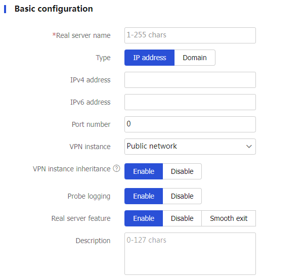

Configure a real server
A real server is an entity on the LB device to process user services. A real server can belong to multiple server farms. A server farm can have multiple real servers.
To configure a real server:
  1. Select Policies > LB Policy >Server Load Balancing > Real Servers.
  2. Click Create.
  3. Create a real server and configure basic real server settings.
    Figure-11 Basic real server settings
    Table-5 Basic configuration items
    Item
    Description
    Real server name
    Enter a name for the real server, case insensitive.
    Type
    Select the real server type:
    • IP address.
    • Domain.
    IPv4 address
    Specify an IPv4 address for the real server.
    The IPv4 address cannot be a loopback address, multicast address, broadcast address, or an address in the format of 0.X.X.X.
    IPv6 address
    Specify an IPv6 address for the real server.
    The IPv6 address cannot be a loopback address, multicast address, link-local address, or all-zero address.
    Domain
    Specify a domain name for the real server.
    After you specify a domain name for the real server, the device immediately sends a domain name query request to the DNS server, and creates a real server named auto_X.X.X.X based on the query results. If the specified domain name is resolved into multiple IP addresses, the device automatically creates multiple real servers.
    To specify a domain name for the real server, you must specify a DNS server on the DNS page for domain name resolution.
    Do not specify the same domain name for different real servers.
    Port number
    Specify the port number for the real server. If the port number is 0, packets use their respective port numbers.
    VPN instance
    Specify a VPN instance for the real server.
    VPN instance inheritance
    Enable or disable VPN instance inheritance.
    When VPN instance inheritance is enabled, a real server without a VPN instance specified inherits the VPN instance of its virtual server.
    Probe logging
    Enable or disable logging for health monitoring.
    This feature logs heath status changes of the real server.
    Real server feature
    Enable or disable the real server feature. Options include:
    • Enable.
    • Disable—Immediately tear down the existing connections for the real server.
    • Smooth exit—Process traffic only for the existing connections and existing sticky entries, and maintain health monitoring for the real server.
    • Slow offline—Stop establishing new connections and wait for the existing connections to expire.
    Description
    Enter a description for the real server.

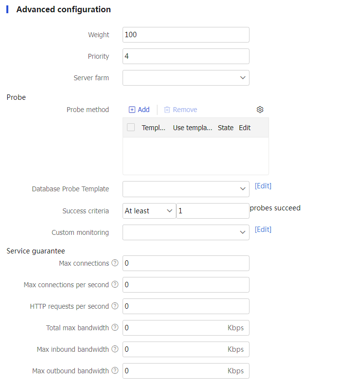

  4. (Optional.) Configure advanced real server settings.
    Figure-12 Advanced real server settings
    Table-6 Advanced configuration items
    Item
    Description
    Weight
    Enter the weight for the real server. A greater value means a higher priority to be selected.
    Priority
    Enter a priority for the real server in the server farm. A greater value means a higher priority to be selected.
    If the number of real servers with the highest priority is smaller than the configured minimum number, real servers with lower priority are selected to meet the minimum number.
    You can configure the maximum number and minimum number on the Server Farms page.
    Server farm
    Select an existing server farm or create a server farm for the real server.
    Probe-Probe method
    Specify a probe template used by the real server to detect the health and availability. You can configure this parameter by using one of the following methods:
    • Configure the parameter globally for all members in the server farm on the Server Farms page, facilitating configuration and management.
    • Configure the parameter for a specific real server farm member from the real server list on the Server Farms page or on the Real Servers page.
    The parameter setting specific to a real server takes precedence over the global setting.
    The probe result of a real server affects the use of the corresponding server farm member. The probe result of a server farm member does not affect the use of the corresponding real server.
    You can select an existing probe template or create a probe template
    1. Click Add.
    Probe-Success criteria
    Custom monitoring
    Select an existing custom probe template or create a custom probe template for the real server.
    This parameter is not available for real servers configured with domain names.
    With this feature disabled, the device restores the state of a server farm member to available after health monitoring succeeds for the server farm member. With this feature enabled, after health monitoring succeeds for the server farm member, you must manually restore the state of the server farm member to available on the real server list of the Edit Server Farm page.
    This parameter is available only for server farm members.
    Variables
    Configure a variable for a server farm member.
    To configure a variable:
    1. Click Add.
      • Name: Enter a variable name, case-sensitive.
      • Value: Enter a variable value, case-sensitive.
    2. Click OK. The new variable appears in the Variables list.
    This variable is used to rewrite the TCP payload in a general LB action. The specific content in the TCP payload will be replaced with the variable value associated with a server farm member. For example, if you configure a variable with name var1 and value _1 and configure an action of rewriting QMGR.S01 as QMGR.S01%[var1], the QMGR.S01 string in the TCP payload is rewritten as QMGR.S01_1.
    QoS-Max connections
    Specify the maximum number of connections for the real server. 0 means not limited.
    QoS-Max connections per second
    Specify the maximum number of connections per second for the real server. 0 means not limited.
    QoS-HTTP requests per second
    Specify the maximum number of HTTP requests per second for the real server. 0 means not limited.
    QoS-Total max bandwidth
    Specify the maximum bandwidth for the real server. 0 means not limited.
    QoS-Max inbound bandwidth
    Specify the maximum inbound bandwidth for the real server. 0 means not limited.
    QoS-Max outbound bandwidth
    Specify the maximum outbound bandwidth for the real server. 0 means not limited.

Configure an LB policy (optional)
An LB policy associates a class with an action to guide packet forwarding. In an LB policy, you can configure an action for packets matching the specified class, and configure the default action for packets matching no class.
You can specify multiple classes for an LB policy. Packets match the classes in the order the classes are configured. If a class is matched, the specified action is taken and packets stop matching the subsequent classes. As a best practice for finer matching when a class rule is included in the rule of another class, configure the class with more detailed rule first. If no class is matched, the default action is taken.
An LB policy can be used by a virtual server.
A Diameter LB policy takes effect only for Diameter requests.

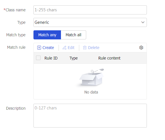

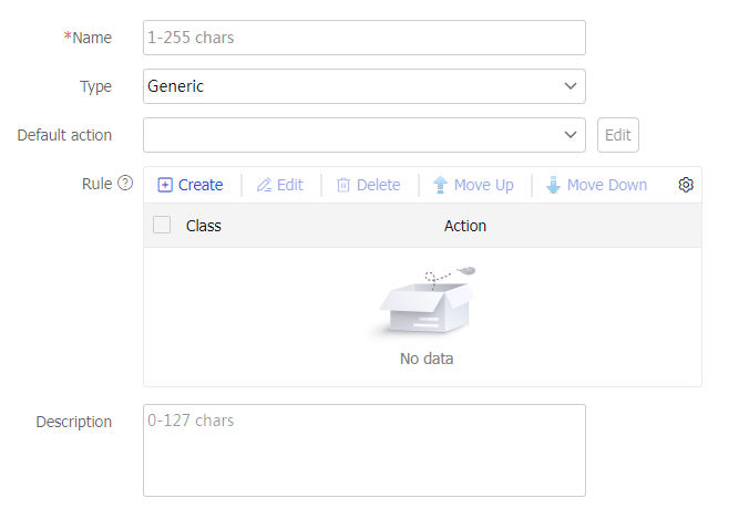

Configure a class
  1. Select Policies > LB Policy > Server Load Balancing > Advanced Policies > Class.
  2. Click Create.
  3. Create a class.
    Figure-13 Class settings
    Table-7 Class configuration items
    Item
    Description
    Class name
    Enter a name for the class, case insensitive.
    Type
    Specify the type for the class.
    • Generic: Applies to Layer 4 server load balancing.
    • HTTP: Applies to Layer 7 server load balancing.
    • RADIUS: Applies to Layer 7 server load balancing.
    • MySQL: Applies to Layer 7 server load balancing.
    • Diameter: Applies to Layer 7 server load balancing. Diameter is a protocol that provides authentication, authorization, and accounting services for computer networks. It evolved from the RADIUS protocol.
    Match type
    Specify the match type for the class.
    • Match any: Requires matching any rule of the LB class.
    • Match all: Requires matching all rules of the LB class.
    Match rule
    A class classifies packets by comparing packets with specific rules. Matching packets are further processed by actions. You can create a maximum of 65535 rules for a class.
    1. Click Create to create a match rule.
      • Rule ID: Specify the rule ID. Rules are matched in ascending order of rule IDs.
      • Type: Specify the rule type. The rule types include source IPv4 address, source IPv6 address, class, IPv4 ACL, IPv6 ACL, cookie, HTTP header, method, URL, content, user, RADIUS attribute, input interface, HTTP version, ISP, TCP payload, MySQL, application ID, and destination realm.
      • IPv4 address: Specify an IPv4 address. This parameter is available only when the rule type is source IPv4 address.
      • Mask length: Specify a mask length. This parameter is available only when the rule type is source IPv4 address.
      • IPv6 address: Specify an IPv6 address. This parameter is available only when the rule type is source IPv6 address.
      • Prefix length: Specify a prefix length. This parameter is available only when the rule type is source IPv6 address.
      • Class: Specify a class. This parameter is available only when the rule type is class.
      • ACL: Specify an ACL. You can select an existing ACL or create an ACL. This parameter is available only when the rule type is IPv4 ACL or IPv6 ACL.
      • Cookie name: Specify the cookie name for HTTP packets. The cookie name is a case-sensitive string excluding spaces, horizontal tabs, ASCII characters smaller than or equal to 31, ASCII characters greater than or equal to 127, or the following characters: ( ) < > @ , ; : \ " / [ ] ? = { }. This parameter is available only when the rule type is cookie.
      • Cookie value: Specify the cookie value regular expression. The string cannot contain question marks (?). This parameter is available only when the rule type is cookie.
      • Header name: Specify the header name for HTTP packets. The header name is a case-insensitive string excluding spaces, horizontal tabs, ASCII characters smaller than or equal to 31, ASCII characters greater than or equal to 127, or the following characters: ( ) < > @ , ; : \ " / [ ] ? = { }. This parameter is available only when the rule type is HTTP header.
      • Header value: Specify the header value regular expression. The string cannot contain question marks (?). This parameter is available only when the rule type is HTTP header.
      • Extension type: The extension type can be Predefined or Custom. This parameter is available only when the rule type is method.
      • Method: The predefined methods include GET, CONNECT, DELETE, HEAD, OPTIONS, POST, PUT, and TRACE. The custom method is a case-sensitive string excluding spaces, horizontal tabs, ASCII characters smaller than or equal to 31, ASCII characters greater than or equal to 127, or the following characters: ( ) < > @ , ; : \ " / [ ] ? = { }. This parameter is available only when the rule type is method.
      • URL: Specify the URL regular expression. The string cannot contain question marks (?). This parameter is available only when the rule type is URL.
      • Content offset: Specify the offset value of the HTTP entity based on the start of the HTTP packet. This parameter is available only when the rule type is content.
      • Content value: Specify the HTTP entity regular expression. The string cannot contain question marks (?). This parameter is available only when the rule type is content.
      • User: Select an existing user or user group in an identity domain, or create a user or user group. This parameter is available only when the rule type is user.
      • Attribute type: Enter an attribute type value. This parameter is available only when the rule type is RADIUS attribute.
      • Attribute value: Specify the RADIUS attribute regular expression. This parameter is available only when the rule type is RADIUS attribute.
      • Input interface: Specify an input interface. This parameter is available only when the rule type is input interface.
      • HTTP version: Specify an HTTP version. This parameter is available only when the rule type is HTTP version.
      • ISP: Select an existing ISP, or create an ISP. This parameter is available only when the rule type is ISP.
      • TCP payload: Enter a regular expression used to match TCP payloads. This parameter is available only when the rule type is TCP payload.
      • Case insensitivity: Enable case insensitivity for matching. This parameter is available only when the rule type is TCP payload or MySQL.
      • Negate the match rule: If this option is not selected, an LB action is taken when TCP packets match the regular expression. If this option is selected, an LB action is taken when TCP packets do not match the regular expression. This parameter is available only when the rule type is TCP payload or MySQL.
      • Regular expression: Enter a regular expression used to match MySQL statements. This parameter is available only when the rule type is MySQL.
      • Application ID: Specify an application ID. An LB action is taken when the application ID in a Diameter request matches the specified application ID. The application ID must be an application ID value defined in the Diameter Base Protocol and its extensions. This parameter is available only when the rule type is Diameter.
      • Destination Realm: Specify a destination realm. An LB action is taken when the destination realm in a Diameter request matches the specified destination realm. This parameter is available only when the rule type is Diameter.
    2. Click OK.
    Description
    Enter a description for the class.
  4. Click OK. The new class appears on the Class page.
Configure an action
  1. Select Policies > LB Policy > Server Load Balancing > Advanced Policies > Action.
  2. Click Create.
  3. Create an action and configure basic action settings.
    Figure-14 Basic action settings
    Table-8 Basic configuration items
    Item
    Description
    Action name
    Enter a name for the action, case insensitive.
    Type
    Specify an action type.
    • Generic
    • HTTP
    • HTTP redirection
    • RADIUS
    • Diameter
    Forwarding mode
    Specify a forwarding mode:
    • Load balance
    • Drop
    • Forward (supported by generic type and RADIUS type only)
    • Respond by using a file (supported by HTTP type only)
    If the LB policy is used by a SIP, HTTP, Performance (HTTP), HTTP redirection, HTTPS, MySQL, or Layer 7 TCP virtual server, the Forward option does not take effect.
    Uncompressed file
    If the URL path in a client request matches the specified URL path, the device responds to the request by using an uncompressed file.
    1. Click Create to create an uncompressed response file.
      • URL path: Specifies the URL path used to match HTTP requests, a case-sensitive string. The specified URL path must start with a forward slash (/).
      • Uncompressed file: Specifies an uncompressed file by its absolute path plus a file name, which is case insensitive, for example, flash:/file.html. Only one uncompressed file can be used for a URL, and one uncompressed file can be used for multiple URLs.
    2. Click OK.
    This parameter is available only when the forwarding mode is Respond by using a file.
    Compressed file
    If the URL path in a client request matches the specified working path plus a relative path in the zip file, the device responds to the request by using the file in the zip file. For example, if you configure the working path as /index and compressed file as flash:/za/zb/test.zip, and a relative path /css/col.css exists in test.zip, the matching URL is /index/css/col.css and the response file is col.css.
    • Working path: Specify a working path plus a relative path in the zip file to match the URL in HTTP requests, a case-sensitive string. The working path must start with a forward slash.
    • Compressed file: Specify a compressed file by its absolute path plus a file name, which is case insensitive. The file must be a zip file, for example, flash:/file.zip.
    Fallback action
    Specify a fallback action.
    • Drop: Drops packets upon failure to find an available real server.
    • Match next rule: Matches the next rule upon failure to find an available real server.
    • Respond by using another file: Responds to client requests with the specified default response file upon failure to find an available real server. Make sure the response file is a complete HTTP packet, rather than only the content of HTTP packet body.
      • Default response file: Specifies an uncompressed file by its absolute path plus a file name, which is case insensitive, for example, flash:/file.html.
    • Fin close: Sends FIN packets to close the TCP connection.
    • Rst close: Sends RST packets to close the TCP connection.
    This parameter is available only when the forwarding mode is Load balance.
    If the LB policy is used by a SIP virtual server, the Match next rule option does not take effect.
    Action taken upon failure to find the response file
    Specify an action taken upon failure to find the response file.
    • Match next rule: Matches the next rule upon failure to find a response file.
    • Respond by using a file: Responds to client requests with the specified default response file upon failure to find a response file. Make sure the response file is a complete HTTP packet, rather than only the content of HTTP packet body.
    TCP connection close mode
    Specify a TCP connection close mode.
    • By sending FIN: Sends FIN packets to close the TCP connection.
    • By sending RST: Sends RST packets to close the TCP connection.
    This parameter is available only when the forwarding mode is Drop.
    ToS
    Set the ToS field value of IP packets sent to the server.
    Description
    Enter a description for the action.
    Server farms-Primary server farm
    Select an existing server farm or create a server farm as the primary server farm.
    When the primary server farm is available (contains real servers), packets are forwarded through the primary server farm. When the primary server farm is not available, packets are forwarded through the backup server farm.
    Server farms-Backup server farm
    Select an existing server farm or create a server farm as the backup server farm.
    Server farms-Sticky group
    Select an existing sticky group or create a sticky group.
    HTTP redirection configuration-Redirection URL
    This setting redirects all HTTP request packets matching an action to the specified URL.
    Specify a redirection URL, a case-sensitive string. You can also specify the question mark (?) or the following character strings as the redirection URL:
    This parameter is available only when the action type is HTTP redirection.
    HTTP redirection configuration -Redirection mode
    Specify a redirection mode.
    • Temporary-302
    • Temporary-307
    • Permanent-301

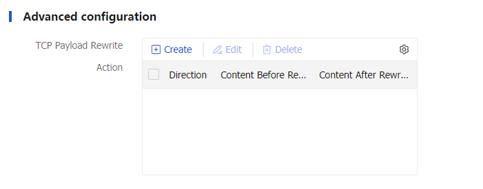

    TCP payload rewrite
    1. Click Create.
      • Direction: Specify the direction, which can be Both, Request, or Response.
      • Content before rewrite: TCP message body to rewrite, a case-sensitive regular expression string.
      • Content after rewrite: TCP message body after rewrite. You can also specify the following replacement strings:
      • %[variable]—Replaces the specified value with the variable associated with the server farm member. The variable is the variable name.
      • %[1-9]—Replaces the specified value with the content in the corresponding parentheses. For example, if you configure the content before rewrite as (Wel)(co)(me) and the content after rewrite as %2, the string Welcome will be replaced with co in the second pair of parentheses.
    2. Click OK.
    This parameter is supported only in a generic LB action.
    Only TCP virtual servers operating at Layer 7 support an LB policy containing the TCP payload rewrite configuration.
  1. Select Policies > LB Policy > Server Load Balancing > Advanced Policies > Load Balancing Policy.
  2. Click Create.
  3. Create an LB policy.
    Figure-16 LB policy settings
    Table-10 LB policy configuration items
    Item
    Description
    Name
    Enter a name for the LB policy, case insensitive.
    Type
    Specify the type for the LB policy.
    Default action
    Specify a generic action for a generic LB policy, or specify any type of action for an HTTP LB policy.
    You can select an existing action or create an action.
    Rule
    Specify an action for packets matching the specified class.
    1. Click Create.
      • Class: Select an existing class or create a class.
      • Action: Select an existing action or create an action.
      • Insert before: Inserts the target class before a class.
    2. Click OK.
    Description
    Enter a description for the LB policy.
  4. Click OK. The new LB policy appears on the Load Balancing Policy page.
Configure a connection limit policy (optional)
Using a connection limit policy can limit the number of connections on the device. It helps prevent a large number of connections from consuming too many device system resources and server resources. In this way, internal network resources (hosts or servers) are protected, and device system resources can be used more appropriately.
A connection limit policy can have multiple rules. Each rule specifies a range of users and the limit to the user connections. A connection limit policy applies only to the user connections matching a rule. When the number of connections for a certain type reaches the upper limit, the device does not accept new connection requests of that type. It accepts new connection requests only when the number of connections drops below the lower limit.
The user ranges in the rules are set by using ACLs.
To configure a connection limit policy:
  1. Select Policies > LB Policy > Server Load Balancing > Advanced Policies > Connection Limit Policy.
  2. Click Create.
  3. Create a connection limit policy.
    Figure-17 Connection limit policy settings
    Table-11 Connection limit policy configuration items
    Item
    Description
    Name
    Enter a name for the connection limit policy, case insensitive.
    Limit rule
    Create a rule.
    1. Click Create.
      • Rule ID: Specify an ID for the connection limit rule.
      • Type: Specify a connection limit rule type, which can be IPv4 ACL or IPv6 ACL.
      • Limit by: Select source IP address, destination IP address, or service. Source IP address limits user connections by source IP address. Destination IP address limits user connections by destination IP address. Service limits user connections by service. Services are classified by transport layer protocol and service port number.
      • Connection limits-Upper limit: Specify the upper limit of connections. When the number of connections in a specified range or for a certain type reaches the upper limit, the device does not accept new connection requests.
      • Connection limits–Lower limit: Specify the lower limit of connections. The lower limit must be equal to or smaller than the upper limit. The device accepts new connection requests only when the number of connections drops below the lower limit.
    2. Click OK.
    Description
    Enter a description for the connection limit policy.
  4. Click OK. The new connection limit policy appears on the Connection Limit Policy page.
Configure a protection policy (optional)
You can specify a protection policy to protect the URLs specified in the protection policy. A protection action is taken if the number of times a user accesses a protected URL exceeds the configured protection threshold during the protection period.
To configure a protection policy:
  1. Select Policies > LB Policy > Server Load Balancing > Advanced Policies > Protection Policy.
  2. Click Create.
  3. Create a protection policy.
    Figure-18 Protection policy settings
    Table-12 Protection policy configuration items
    Item
    Description
    Name
    Enter a name for the protection policy, case insensitive.
    Type
    Specify the type for the protection policy.
    The device supports only the HTTP type.
    Protection action
    Select protection actions. A protection action is taken if the number of times a user accesses a protected URL exceeds the configured protection threshold. You can specify the following protection actions:
    • Warning—Generates a log message and sends it to the information center.
    • Drop—Drops requests.
    • Verify client—Returns a response carrying a cookie value to the client. If a subsequent request carries the returned cookie value, it passes the verification. If a subsequent request does not carry a cookie value or carries a different cookie value, it fails to pass the verification and is dropped. The device supports returning a cookie value by inserting an HTTP header or a JS script.
    Protection rule
    A protection policy can contain multiple protection rules. Each protection rule defines the URLs to be protected and the protection period. A protection action is taken if the number of times a user accesses a protected URL exceeds the configured protection threshold during the protection period. The device supports using source-IP-based and cookie-based criteria to determine whether requests belong to the same user. If you configure both a cookie-based request threshold and a source-IP-based request threshold, the protection action is taken when either threshold is exceeded.
    1. Click Create to create a protection rule.
      • Protected URL: Specify a regular expression to match URLs, a case-sensitive string. The regular expression cannot contain question marks (?).
      • Statistics period: Set the protection period. If the number of times that a user accesses a protected URL exceeds the request threshold during the protection period, the protection action is taken.
      • Source-IP-based threshold: Configure a source-IP-based request threshold.
      • Cookie name: Specify an HTTP cookie by its name, a case-sensitive string. The cookie name cannot contain brackets ({ }, ( ),[ ], < >), at sign (@), comma (,), semicolon (;), colon (:), backslash (\), quotation mark ("), slash (/), question mark (?), equal sign (=), space character (SP), and horizontal tab (HT). Additionally, the cookie name cannot contain ASCII codes that are less than or equal to 31 and greater than or equal to 127.
      • Cookie-based threshold: Configure a cookie-based protection threshold.
    2. Click OK.
    Description
    Enter a description for the protection policy.
  4. Click OK. The new protection policy appears on the Protection Policy page.
Configure a parameter profile (optional)
You can configure advanced parameters through a parameter profile. The virtual server references the parameter profile to analyze, process, and optimize service traffic.
To configure a parameter profile:
  1. Select Policies > LB Policy > Server Load Balancing > Parameter Profiles.
  2. Click Create.
  3. Create a parameter profile.
    Figure-19 Parameter profile settings
    Table-13 Parameter profile configuration items
    Item
    Description
    Parameter profile name
    Enter a name for the parameter profile, case insensitive.
    Type
    Specify the type for the parameter profile.
    • IP: Applies to Layer 4 and Layer 7 server load balancing. For more information about IP parameter configuration.
    • TCP: Applies to Layer 4 and Layer 7 server load balancing. For more information about TCP parameter configuration.
    • HTTP: Applies to Layer 7 server load balancing. For more information about HTTP parameter configuration.
    • HTTP-Compression: Applies to Layer 7 server load balancing. For more information about HTTP compression parameter configuration.
    • HTTP-Statistics: Applies to Layer 7 server load balancing. For more information about HTTP statistics parameter configuration.
    • OneConnect: Applies to Layer 7 server load balancing. For more information about OneConnect parameter configuration.
    • TCP-Application: Applies to Layer 7 server load balancing. For more information about TCP application parameter configuration.
    • MySQL: Applies to Layer 7 server load balancing. For more information about MySQL application parameter configuration.
    • Diameter-Session: Applies to Layer 7 server load balancing. For more information about Diameter-Session parameter configuration.
    • HTTP2.0: Applies to Layer 7 server load balancing. For more information about HTTP/2 parameter configuration.
    Description
    Enter a description for the parameter profile.
    Figure-20 IP parameter profile settings
    Table-14 IP parameter configuration items
    Item
    Description
    ToS sent to client
    Set the ToS field value of IP packets sent to the client.
    Figure-21 TCP parameter profile settings
    Table-15 TCP parameter configuration items
    Item
    Description
    Option operation list
    This feature enables the LB device to insert the client's actual IP address into the specified option in headers of TCP packets sent to the server or remove the specified option.
    • To create an option operation, click Create.
      • Insert: Inserts content into the specified option in headers of TCP packets sent to the server.
      • Remove: Removes the specified option from headers of TCP packets sent to the server.
      • Option number: Number of the option to be operated.
      • Encoding type: Select the binary or string encoding mode for the TCP option.
      • Insert content into TCP options: Enter a string to be inserted into TCP options. You can also specify one or multiple replacement strings including %{is} (client source IP address), %{isl} (length of the source IP address), %{ps} (source port number), and %{psl} (length of the source port number).
    • Click OK. The new option operation appears in the Option operation list.
    Insert only into data packets
    Enable or disable inserting specified content only into data packets.
    With this feature enabled, the specified content will be inserted only into data packets. With this feature disabled, the specified content will be inserted into both data packets and handshake packets.
    This feature does not take effect if the TCP parameter profile is used by an IP or UDP virtual server, or a TCP virtual server with the operation mode of Layer 4.
    Timestamps option
    Specify an action to take on the Timestamps option in headers of TCP packets sent to the server. Options include:
    • Preserve: Preserve the Timestamps option in the headers of TCP packets sent to the server.
    • Remove: Remove the Timestamps option from the headers of TCP packets sent to the server.
    • Rewrite: Rewrite the Timestamps option in the headers of TCP packets sent to the server with the Timestamps option value of the LB device.
    • Use global settings: Use the action specified globally. To view the global settings, click Global settings to open the Objects > Load Balancing > Advanced Configuration page.
    Action on MSS-exceeded packets
    Specify the action to take on the segments that exceed the MSS in the HTTP requests sent by the client.
    • Permit: Allows the segments to exceed the MSS.
    • Drop: Discards the segments that exceed the MSS.
    Idle timeout time
    Specify the idle timeout time for TCP connections.
    If no data is transmitted before the idle timeout time expires, the LB device disconnects the TCP connection with the client or server.
    TCP MSS
    Specify the MSS for the LB device.
    TCP option number for SNAT
    Specify the number of the TCP option used for SNAT.
    The LB device translates the source IP address of packets into the IP address in the specified TCP option.
    Layer 4 Parameters-Half-open connection threshold for triggering SYN cookie
    Set the half-open connection threshold for triggering SYN cookie.
    During the process of establishing a TCP connection between the client and the virtual server, the connection is half-open from the time the virtual server receives the SYN packet until it receives the ACK packet.
    This parameter takes effect only when the TCP parameter profile is used by a TCP virtual server with the operation mode of Layer 4.
    Layer 4 Parameters-Keepalive timeout time
    Set the TCP keepalive packet sending interval for an idle TCP connection.
    This parameter takes effect only when the TCP parameter profile is used by a TCP virtual server.
    Layer 7 Parameters-Max local window size
    Configure the maximum local window size for TCP connections.
    Layer 7 Parameters-TIME-WAIT timeout time
    Set the TIME_WAIT state timeout time for TCP connections.
    A TCP connection is released slowly after it is disconnected, because the TIME_WAIT timer of TCP is long. You can adjust the TIME_WAIT state timeout time.
    This parameter takes effect only when the TCP parameter profile is used by an HTTP or HTTPS virtual server.
    Layer 7 Parameters-SYN timeout time
    Set the SYN packet timeout time for TCP connections. If no SYN-ACK packet is received when the timer expires, the TCP connection is closed.
    Layer 7 Parameters-Delayed Acks
    Set the number of received TCP data packets for a delayed ACK. With this parameter configured, the device uniformly sends an ACK after receiving the specified number of data packets. This parameter reduces the number of ACK packets and improves network transmission efficiency.
    Layer 7 Parameters-Keepalive timeout time
    Layer 7 Parameters-Keepalive retransmission interval
    Set the TCP keepalive packet retransmission interval.
    Layer 7 Parameters-Keepalive retransmission times
    Set the TCP keepalive packet retransmission times.
    Layer 7 Parameters-FIN-WAIT-1 timeout time
    Set the FIN-WAIT-1 state timeout timer for TCP connections.
    Layer 7 Parameters-FIN-WAIT-2 timeout time
    Set the FIN-WAIT-2 state timeout timer for TCP connections.

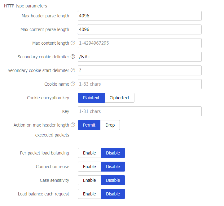

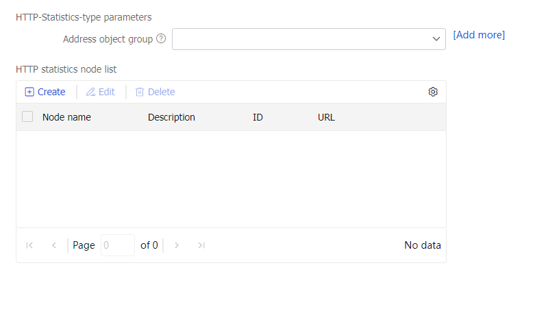

    Figure-22 HTTP parameter profile settings
    Table-16 HTTP parameter configuration items
    Item
    Description
    Max header parse length
    Set the maximum length of HTTP headers that can be parsed.
    Max content parse length
    Set the maximum length of the HTTP entities that can be parsed.
    Secondary cookie delimiter
    Specify the delimiter that separates secondary cookies in URLs, including ! " # ; < > ? [ \ ] ^ ` | : @ & $ + * ' ( ) , /.
    Secondary cookie start delimiter
    Specify the start delimiter for secondary cookies in URLs, including ! " # ; < > ? [ \ ] ^ ` |.
    Cookie name
    Specify the cookie to be encrypted by its name, a case-sensitive string.
    Cookie encryption key
    Specify a key in plaintext or ciphertext form.
    Key
    Specifies the key, a case-sensitive string.
    Action on max-header-length exceeded packets
    Specify the action to take on the HTTP requests when their packet headers exceed the maximum length.
    • Permit: Allows the HTTP requests to pass.
    • Drop: Discards the HTTP requests.
    When the HTTP packet header length exceeds the processing capability of load balancing, the drop action applies.
    Per-packet load balancing
    Enable or disable per-packet load balancing for HTTP requests.
    Connection reuse
    Enable or disable connection reuse between the LB device and the server.
    Connection reuse allows the LB device to establish connections to the server that can be reused by clients. Because multiple clients can use the same connection, the number of connections between the clients and the server is reduced.
    Case sensitivity
    Enable or disable case sensitivity for matching character strings. This setting affects the following content:
    • HTTP header value, HTTP cookie name and value, and URL for matching classes.
    • Header value, URL, and key value used for generating sticky entries for the HTTP header sticky method.
    • Cookie name and value and key value used for generating sticky entries for the cookie get sticky method.
    Load balance each request
    Enable or disable per-request load balancing for HTTP requests.

    Figure-24 HTTP statistics parameter profile settings
    Table-18 HTTP statistics parameter configuration items
    Item
    Description
    Address object group
    If HTTP packets match the specified URL and source IP address object group, they are counted based on the source IP address object group. If HTTP packets match the specified URL but do not match the specified source IP address object group, they are counted based on the source IP address.
    You can specify a maximum of 1024 source IP address object groups in one HTTP statistics parameter profile.
    HTTP statistics node list
    1. Click Create.
      • Node name: Specify the statistics node name, case insensitive. You can configure a maximum of 256 statistics nodes in one HTTP statistics parameter profile.
      • Description: Enter a description for the statistics node, case sensitive.
      • Statistics rule list: List of URL match rules. You can configure a maximum of 256 URL match rules for one statistics node.
      • ID: Specify the match rule ID.
      • URL: Specify a URL regular expression. The string cannot contain question marks (?).
    2. Click OK.
    Figure-25 OneConnect parameter profile settings
    Table-19 OneConnect parameter configuration items
    Item
    Description
    Max reuse number
    Set the maximum number of times that a TCP connection can be reused.
    After connection reuse is enabled, a TCP connection is not disconnected until the maximum number of reuse times is reached. After the TCP connection is disconnected, new connection requests trigger establishment of a new TCP connection.
    Idle timeout time
    Set the idle timeout time for TCP connections between the LB device and servers.
    The idle timeout time is the amount of time that a TCP connection can stay idle before it is disconnected. After the TCP connection is disconnected, new connection requests trigger establishment of a new TCP connection.
    IPv4 mask length
    Specify the IPv4 mask length for connection reuse.
    This setting limits the network segment of clients that can reuse connections between the LB device and servers. If the client that initiates a connection request is in the same network segment as the idle TCP connection, the idle TCP connection is reused. If the client does not match this requirement, a new TCP connection is established.
    IPv6 prefix length
    Specify the IPv6 prefix length for connection reuse.
    Figure-26 TCP application parameter profile settings
    Table-20 TCP application parameter configuration items
    Item
    Description
    TCP buffering period
    Specify the buffering period for TCP payload matching.
    TCP maximum buffering size
    Specify the maximum buffering size.
    The device stops buffering traffic when the maximum buffering size is reached.
    TCP buffering end string
    Configure the TCP buffering end string.
    The device stops buffering traffic when it receives the buffering end string.
    Figure-27 MySQL parameter profile settings
    Table-21 MySQL parameter configuration items
    Item
    Description
    Connection pool size
    Specify the maximum number of TCP connections that can be stored in a connection pool.
    After MySQL data transfer is completed, the TCP connection is stored in a connection pool instead of being closed. For a new connection request, the device selects an available connection from the connection pool before attempting to open a new connection.
    Connection reuse
    Enable or disable connection reuse.
    This feature allows the LB device to establish connections to the server that can be reused by multiple clients.
    This feature helps reduce the connections opened between clients and servers.
    Max reuse number
    Idle timeout time
    IPv4 mask length
    This setting limits the network segment of clients that can reuse connections between the LB device and servers. If a client that initiates a connection request is in the same network segment as the idle TCP connection, the client reuses the idle TCP connection. If the client does not match this requirement, a new TCP connection is established.
    IPv6 prefix length
    Figure-28 Diameter-Session parameter profile settings
    Table-22 Diameter-Session parameter configuration items
    Item
    Description
    Capability exchange timeout timer
    Specify the timeout time for capability exchange. When the device establishes a TCP connection with a client or a server, they must exchange Capabilities-Exchange-Request (CER) and Capabilities-Exchange-Answer (CEA) messages. If no CER or CEA messages are exchanged before the timer expires, the device determines that the TCP connection is down and tears down the connection to save system resources.
    A Diameter-Session parameter profile takes effect only for Diameter requests.
    Original host
    Specify the original host name for the device to send to the peer during capability exchange.
    The original host name must be a Fully Qualified Domain Name (FQDN), which contains a host name and a domain name.
    Original realm
    Specify the original realm for the device to send to the peer during capability exchange.
    Vendor ID
    Specify the vendor ID for the device to send to the peer during capability exchange.
    Product name
    Specify the product name for the device to send to the peer during capability exchange.
    Local host IP
    Specify the IP address for the device to send to the peer during capability exchange.
    The IP address must be an available IP address that is already configured for an interface on the device.
    Retransmission
    Enable or disable retransmission of Diameter messages.
    This feature enables the device to retransmit Diameter messages to the server farm if it does not receive any response before the retransmission timeout timer expires, ensuring service availability for users.
    Retransmission timeout timer
    Set the timeout time for retransmitting Diameter messages.
    With the retransmission feature enabled, the device retransmits Diameter messages to another real server in the server farm and restarts the timer if it does not receive any response before the timer expires. If the device still does not receive any response before the second timer expires, it determines that the data transmission fails and informs the client that the server is not reachable.
    The device can retransmit Diameter messages only once.
    Figure-29 HTTP2.0 parameter profile settings
    Table-23 HTTP2.0 parameter configuration items
    Item
    Description
    Max concurrent requests
    Specify the maximum number of concurrent requests for each TCP connection.
    Max receive window size
    Specify the maximum receive window size for HTTP/2 packets.
    Insert header field
    Enable or disable inserting fields into headers of HTTP/2 requests.
    Header field name
    Specify the header field name to be inserted into HTTP/2 packet headers.
    Idle Timeout
    Specify the timeout time for idle TCP connections.
    Connection frame size
    Specify the maximum connection frame size for HTTP/2 packets.
    Header size
    Specify the header size for HTTP/2 packets.
    Close connection to server
    • FIN close: Close connections to the server by sending FIN packets.
    • RST close: Close connections to the server by sending RST packets.
    This parameter takes effect only when the client sends HTTP/2 requests while the device and real server support only HTTP1.1.

Configure an intelligent probe template (optional)
You can configure an HTTP passive, RST, zero-window, custom, or database intelligent probe template to monitor a single server farm member or all members in a server farm.
Support for intelligent probe template types varies by device model.
To configure an intelligent probe template:
  1. Select Policies > LB Policy > Server Load Balancing > Probe Templates.
  2. Click Create.
  3. Create an intelligent probe template.
    Figure-30 Intelligent probe template settings
    Table-24 Intelligent probe template configuration items
    Item
    Description
    Probe template name
    Enter a name for the probe template, case insensitive.
    Type
    Specify the type for the intelligent probe template:
    • RST: Monitors the number of RST packets sent by a real server. For information about configuring an RST probe template.
    • Zero-window: Monitors the number of zero-window packets sent by a real server. For information about configuring a zero-window probe template.
    • HTTP passive: Monitors the number of abnormal URLs in HTTP response packets. For information about configuring an HTTP passive probe template.
    • Custom: Monitors the state of real servers by using a custom script file. For information about configuring a custom probe template.
    Description
    Enter a description for the intelligent probe template.

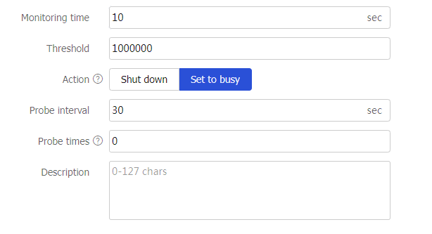

    Monitoring time
    Specify the monitoring time. During the monitoring time, the system counts the number of RST packets or zero-window packets sent by each server farm member in a server farm if an RST or zero-window probe template is specified.
    Threshold
    Specify the maximum number of RST packets or zero-window packets a real server can send before an action is taken.
    Action
    Specify the action to take when the RST or zero-window packet threshold is reached.
    • Shut down: Shuts down a real server.
    • Set to busy: Places a real server in busy state. The system continues to probe the real server at the probe intervals. If the number of RST or zero-window packets sent does not reach the threshold during the probe interval, the real server is placed back in normal state. If the packet number reaches the threshold, the system probes the real server until the maximum probe times is reached. If the result of every probe reaches the threshold, the system automatically shuts down the real server.
    A real server that is shut down due to packet threshold violation or exceeded probe times will be restored to normal state immediately when the intelligent probe template is deleted.
    Probe interval
    Specify the interval to probe the real server in busy state.
    Probe times
    Specify the maximum number of times for probing the real server in busy state. The value 0 means that the number of probe times is not limited.

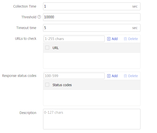

    Figure-32 HTTP passive probe template settings
    Table-26 HTTP passive probe template configuration items
    Item
    Description
    Monitoring time
    Specify the monitoring time. During the monitoring time, the system monitors the responses of matching HTTP requests if an HTTP passive probe template is specified.
    Threshold
    Specify the maximum number of abnormal URLs in HTTP response packets. If the number of abnormal URLs exceeds the maximum number, the real server is shut down.
    Timeout time
    Specify the timeout time for the HTTP passive probe template.
    The device monitors the responses of HTTP requests with the specified URL. If the response time for an HTTP request exceeds the timeout time, a URL error is recorded.
    URLs to check
    Configure the URLs to check. The URLs cannot contain question marks (?).
    If the device receives an HTTP request with any of the specified URLs, the device monitors the responses of the HTTP request.
    A maximum of 10 URLs can be configured for an HTTP passive probe template.
    Response status code
    Configure the response status codes to check.
    If an HTTP response contains any of the specified response status codes, a URL error is recorded.
    A maximum of 10 response status codes can be configured for an HTTP passive probe template.

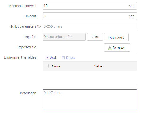

    Figure-33 Custom probe template settings
    Table-27 Custom probe template configuration items
    Item
    Description
    Monitoring time
    Specify the monitoring interval. At the monitoring intervals, the system executes the specified script file.
    Timeout time
    Specify the timeout time for waiting for responses.
    As a best practice, set timeout time to be smaller than the monitoring interval.
    Script parameters
    Configure script parameters.
    When executing a script file, the device transfers the script parameters to the script file.
    Multiple space-separated script parameters are supported.
    Script file
    Select and import a script file.
    The device detects the state of real servers according to the detection contents in the script file.
    The device supports only script files with the .py suffix.
    Environment variables
    Configure an environment variable.
    You can specify the environment to execute the custom script file by configuring an environment variable.

Configure a global SNAT policy (optional)
A global SNAT policy is used to translate the source IP addresses of packets into the specified IP addresses. You can implement SNAT by configuring a global SNAT policy on the Global SNAT Policy page or by configuring SNAT on the Server Farm page. The SNAT configuration on the Server Farm page has higher priority. A server farm without SNAT configuration uses the global SNAT policy for address translation.
To configure a global SNAT policy:
  1. Select Policies > LB Policy > Server Load Balancing > Global SNAT Policies.
  2. Click Create.
  3. Create a global SNAT policy.
    Figure-34 Global SNAT policy settings
    Table-28 Global SNAT policy configuration items
    Item
    Description
    Global SNAT policy name
    Enter a name for the global SNAT policy, case insensitive.
    SNAT mode
    Select an SNAT mode.
    SNAT pool name
    Select an existing SNAT pool or create an SNAT pool.
    VRF
    Specify the VPN instance to which the global SNAT policy belongs.
    Priority
    Set the priority for the global SNAT policy.
    You can configure multiple global SNAT policies with different priorities. They are matched in descending order of priority values.
    Source IP address object group
    Specify a source IP address object group for address translation. The device performs SNAT on only packets with a matching source IP address.
    Destination IP address object group
    Specify a destination IP address object group for address translation. The device performs SNAT on only packets with a matching destination IP address.
    Service object group
    Specify a service object group for address translation. The device performs SNAT on only packets with a matching service.
    Policy status
    Enable or disable the global SNAT policy.
    Description
    Enter a description for the global SNAT policy.
  4. Click OK. The new global SNAT policy appears on the Global SNAT Policy page.
