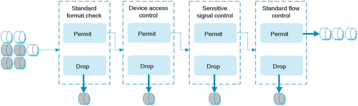

If a device is configured with more than one of the above features, the device processes a packet in the sequence of standard format check, device access control, sensitive signal control, and standard flow control.
Figure-1 Packet processing procedure

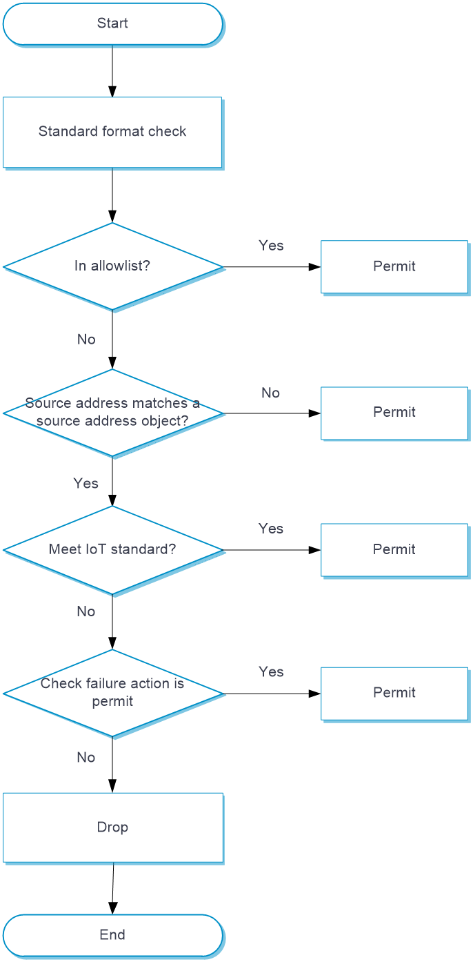

This feature checks IoT device traffic based on different IoT device standards to avoid non-standard devices from accessing IoT networks.
Upon receiving an IoT packet, the device configured with standard format check operates as follows:
Verify whether the packet source address is in the allowlist.
If the address is in the allowlist, the device allows the packets to pass.
If the address is not in the allowlist, the device proceeds to the next step.
Compare the packet source addresses against addresses in the source address object groups to determine whether format check is required.
If format check is not required, the device allows the packet to pass.
If format check is required, the device proceeds to the next step.
You can configure an IPv4 source address object group, an IPv6 source address object group, and a MAC address object group to filter packets. A match is found if the packet matches any object group.
Check the administrative area, device ID, IoT device type, and interface method to identify whether the packet match the corresponding IoT standard.
If all the packet attributes match the standard requirements, the device allows the packets to pass.
If a packet attribute does not meet the standard requirement, the device allows the packets to pass or drops the packets as configured.
Figure-2 Standard format check processing

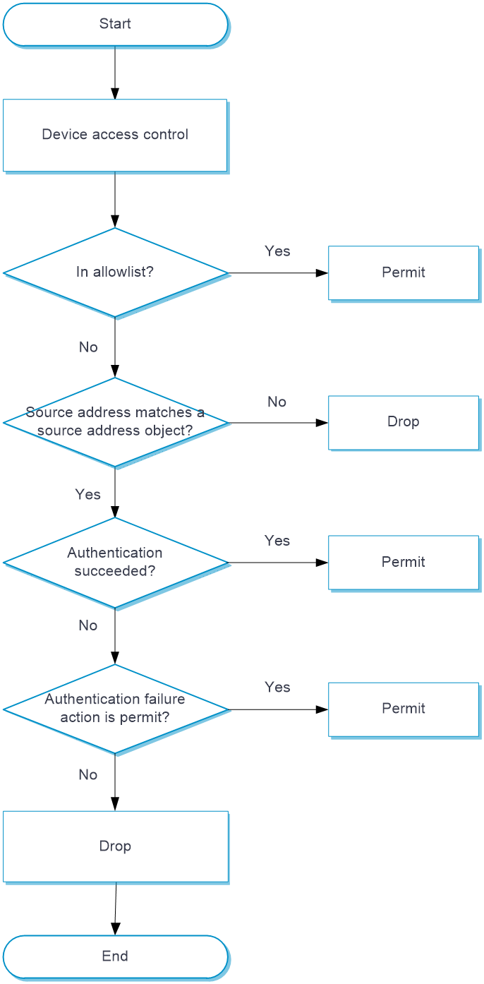

This feature examines IoT device traffic based on different IoT device standards and the device information configured by the administrators to allow only traffic from permitted IoT devices to pass. This can avoid devices from being tampered.
Upon receiving an IoT packet, the device configured with device access control operates as follows:
Compare the packet source addresses against addresses in the source address object groups to determine whether access control is required.
If access control is not required, the device allows the packet to pass.
If access control is required, the device proceeds to the next step.
Check whether the packets can be forwarded by checking the authentication information such as the IP address, MAC address, device ID, and standard.
If packet authentication information meets all requirements, the device allows packets to pass directly.
If packet authentication information fails to meet the requirements, the device allows the packets to pass or drops the packets as configured.
Figure-3 Device access control processing

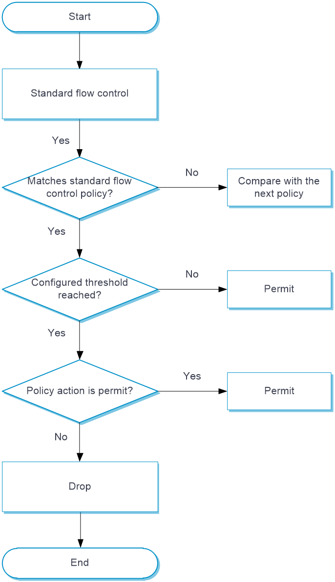

This feature checks IoT device traffic based on different standard flow control policies. By comparing the total number of requests per device and request rate per device with the configured thresholds, this feature controls device request traffic and avoids DoS attacks.
When a device receives IoT packets, it compares the packets with standard flow control policies in the sequence as displayed. Once a match is found, the device takes the action defined in the policy on the packet. If no match is found, the device allows the packet to pass directly.
Upon receiving an IoT packet, the device configured with standard flow control operates as follows:
Check the requester ID, IP address, MAC address, and IoT standard by policies to verify whether the packets require standard flow control.
If a packet matches all criterion types in a policy, the packet matches the policy successfully and standard flow control is required for the packet. Note that each criterion type includes one or more criteria, and a packet matches a criterion type if it matches any criterion of the type.
If a packet fails to match one of the criteria types in a policy, the packet continues to compare with the next policy until it is successfully matched. If the packet fails to match any of the policies, standard flow control is not required.
Check whether the request times and rate information in the packet reaches the configured thresholds.
If the request times and rate information in the packet reaches the configured thresholds, the device executes the action configured in the policy on a packet.
If the thresholds are not reached, the device allows the packet to pass directly.
Figure-5 Standard traffic control processing

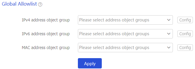

Configure the global allowlist.
Select
Configure the global allowlist. To improve the system processing efficiency and reduce incorrect reporting, you can add address object groups of trusted devices or devices that are reported incorrectly by format check to the allowlist.
Figure-6 Configuring the global allowlist

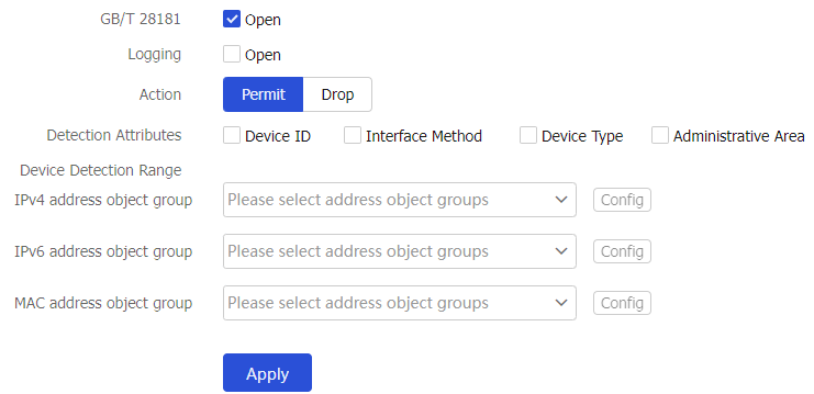

Enable standard format check for different standards. Supported standards include GB/T 28181, GB 35114, and GA/T 1400.
Select
Configure settings on the
Figure-7 Enabling standard format check for different standards
Table-1 Standard format check configuration items
Item | Description | |
Standards | GB/T 28181 | Enable format check for the specified standard. |
GB 35114 | ||
GA/T 1400 | ||
Logging | Enable logging standard format check failures. | |
Action | Specify the action to take upon standard format check failure. Options include:
Detection Attributes | Configure detection attributes for standard format check. A packet passes the standard format check only after it passes the examination on all the specified detection attributes. | |
Source Address Check | Configure source address object groups to filter out devices for standard format check. The device performs standard format check on packets that match any configured source address object group. | |
Click

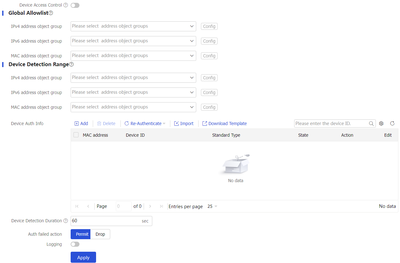

The device access control feature checks the traffic of IoT devices based on IoT device standards and configured device information. This ensures only traffic from allowed IoT devices can pass and can effectively prevent device tampering.
Select
Figure-8 Configuring device access control
Table-2 Device access control configuration items
Device Access Control | Enable device access control. |
Global Allowlist | To improve the device processing efficiency and reduce incorrect report, you can add address object groups of trusted devices or devices that are reported incorrectly by device access control to the allowlist. |
Device Authentication Information | Used to authenticate IoT devices, such as device address, device ID, and device standard. If the IoT device information collected in a packet matches the configured device authentication information, the system permits the packet to pass. To import device authentication information, click Authentication inaccuracy might occur if you access an IoT management platform to edit the device ID or standard information for an authenticated device. To resolve this issue, click |
Detection Duration | Specify the time during which the system continuously collects IoT information in each packet received to authenticate a device. This setting avoids device authentication failure caused by incomplete IoT information in a single packet. |
Action | Specify the action to take upon an authentication failure. Options include:
Logging | Enable logging device authentication failures. |
Click

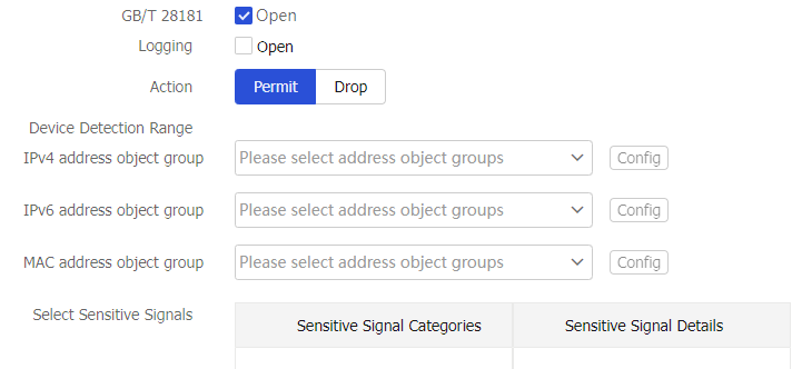

The sensitive signal control feature identifies sensitive signals in IoT device traffic based on IoT device standards, and matches and filters relevant sensitive signals in traffic based on the configurations. This feature can detect sensitive behaviors in IoT device traffic, such as queries, access, and control, effectively avoiding data leakage and tampering.

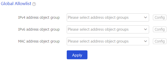

Select
Configure the global allowlist. To improve the system processing efficiency and reduce incorrect reporting, you can add address object groups of trusted devices or devices that are reported incorrectly by sensitive signal control to the allowlist.
Figure-9 Configuring the global allowlist
Enable sensitive signal control for different standards. Supported standards include GB/T 28181, GB 35114, and GA/T 1400.
Select
Figure-10 Enabling sensitive signal control for different standards
Table-3 Sensitive signal control configuration items
Standards | GB/T 28181 | Enable sensitive signal control for the specified standard. |
GB 35114 | ||
GA/T 1400 | ||
Logging | After logging is enabled, the system reports corresponding logs when sensitive signals are detected. | |
Action | Specify the action upon format check failure. Options include:
Select Sensitive Signals | Select sensitive signals to be detected. The system will check whether packets contain the specified operations, such as edit and delete. | |
Click

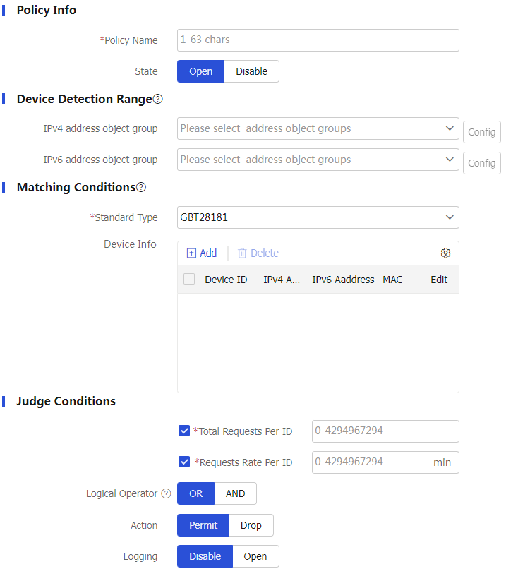

The standard traffic control feature provides the following functions to control the traffic of requesting devices and effectively prevent DoS attacks:
Detects the traffic of IoT devices, according to standard traffic control policies.
Compares the request count and request rate of a single device with a specific ID against the configured thresholds.
Select
Click
Configure settings to create a policy.
Figure-11 Creating a standard traffic control policy-1
Figure-12 Creating a standard traffic control policy-2
Table-4 Standard traffic control policy configuration items
Policy Name | Configure a policy name. | |
Status | Whether the standard flow control policy is enabled. | |
Match Criteria | Standard type | Standard type used by the packet. |
Device information | Basic device information including device ID and address. | |
Detection Attributes | Requests Per ID | Total number of requests sent by an IoT device. |
Request Rate Per ID | Request rate (number of requests per minute) of an IoT device. | |
Logical Operation | Logical relation between the detection attributes. Options include:
Action | Specify the action to take when a packet matches a policy and the detection attributes of the packet reach the thresholds. Options include:
Logging | After logging is enabled, the system reports the corresponding logs when a packet matches a policy and the detection attributes of the packet reach the thresholds. | |

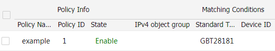

Click
Figure-13 Standard traffic control policy created
