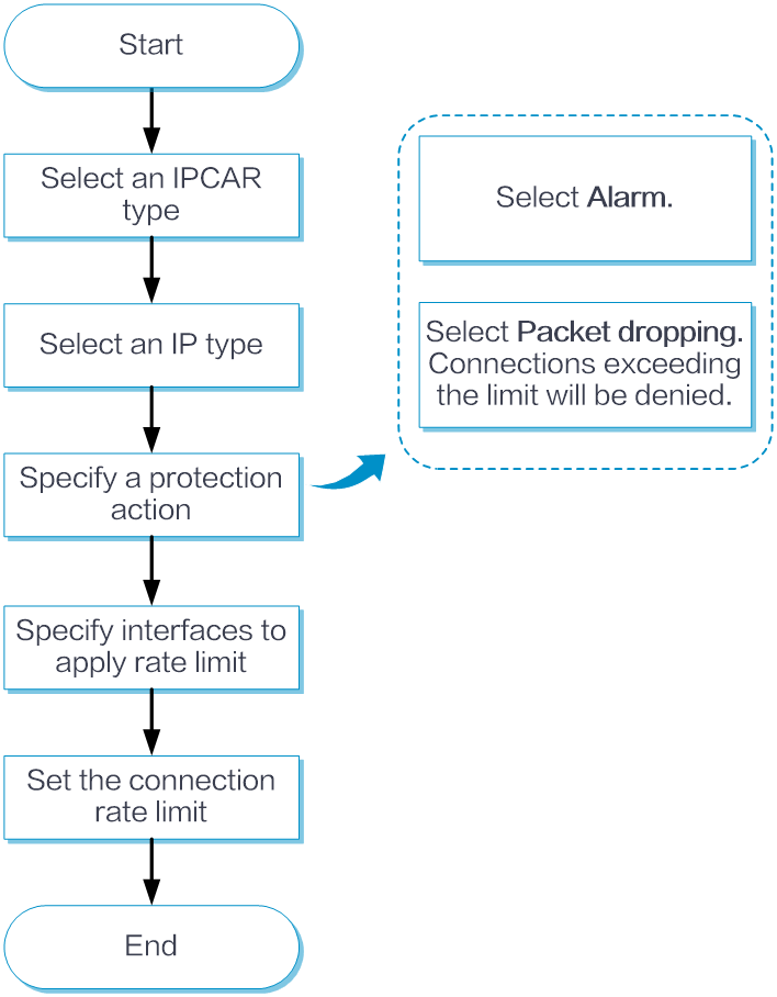

Configuration flow
Figure-1 shows the configuration flow chart.
Figure-1 Configuration flow chart

    IP type
    Select an IP type. Options include IPv4 and IPv6.
    Protection action
    Select a protection action.
    • Alarm—Sends logs when the connection rate exceeds the rate limit. You can view the logs on the IPCAR Logs page.
    • Packet dropping—Drops packets when the connection rate exceeds the rate limit.
    Interfaces
    Select interfaces to apply the rate limit.
    Per-IP Connection Rate Threshold
    Enter a connection rate limit.
  3. Click OK.
