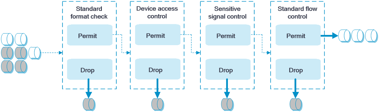

If a device is configured with more than one of the above features, the device processes a packet in the sequence of standard format check, device access control, sensitive signal control, and standard flow control.
Figure-1 Packet processing procedure

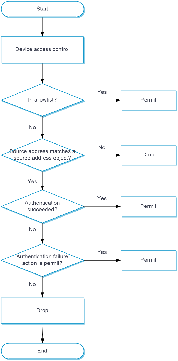

Device access control
This feature examines IoT device traffic based on different IoT device standards and the device information configured by the administrators to allow only traffic from permitted IoT devices to pass. This can avoid devices from being tampered.
Upon receiving an IoT packet, the device configured with device access control operates as follows:
  1. Verify whether the packet source address is in the allowlist.
    • If the address is in the allowlist, the device allows the packets to pass.
    • If the address is not in the allowlist, the device proceeds to the next step.
  2. Compare the packet source addresses against addresses in the source address object groups to determine whether access control is required.
    • If access control is not required, the device allows the packet to pass.
    • If access control is required, the device proceeds to the next step.
  3. You can configure an IPv4 source address object group, an IPv6 source address object group, and a MAC address object group to filter packets. A match is found if the packet matches any object group.
  4. Check whether the packets can be forwarded by checking the authentication information such as the IP address, MAC address, device ID, and standard.
    • If packet authentication information meets all requirements, the device allows packets to pass directly.
    • If packet authentication information fails to meet the requirements, the device allows the packets to pass or drops the packets as configured.
Figure-3 Device access control processing

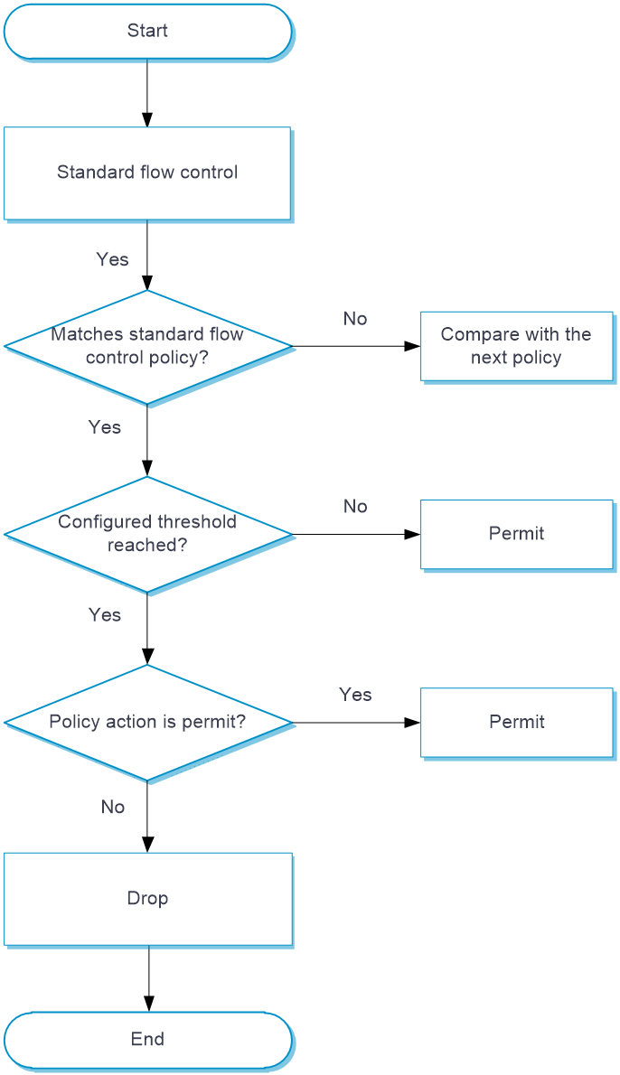

Standard flow control
This feature checks IoT device traffic based on different standard flow control policies. By comparing the total number of requests per device and request rate per device with the configured thresholds, this feature controls device request traffic and avoids DoS attacks.
When a device receives IoT packets, it compares the packets with standard flow control policies in the sequence as displayed. Once a match is found, the device takes the action defined in the policy on the packet. If no match is found, the device allows the packet to pass directly.
Upon receiving an IoT packet, the device configured with standard flow control operates as follows:
  1. Check the requester ID, IP address, MAC address, and IoT standard by policies to verify whether the packets require standard flow control.
    • If a packet matches all criterion types in a policy, the packet matches the policy successfully and standard flow control is required for the packet. Note that each criterion type includes one or more criteria, and a packet matches a criterion type if it matches any criterion of the type.
    • If a packet fails to match one of the criteria types in a policy, the packet continues to compare with the next policy until it is successfully matched. If the packet fails to match any of the policies, standard flow control is not required.
  2. Check whether the request times and rate information in the packet reaches the configured thresholds.
    • If the request times and rate information in the packet reaches the configured thresholds, the device executes the action configured in the policy on a packet.
    • If the thresholds are not reached, the device allows the packet to pass directly.
Figure-5 Standard traffic control processing
