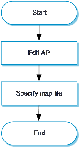

Configure a map file as shown in the following figure:
Basic configuration
To configure basic settings:
  1. From the left navigation pane, select Configure > AP Config > AP > Map Files.
  2. Click the Edit icon in the Actions column for the target AP. You can then edit the map file for the AP on the Map Files tab.
  3. Select a map file from the Map File field. You can select a file on the device or a local file. Click Edit. Edit the file in the dialog box that opens.
  4. After the configuration, click Submit.
