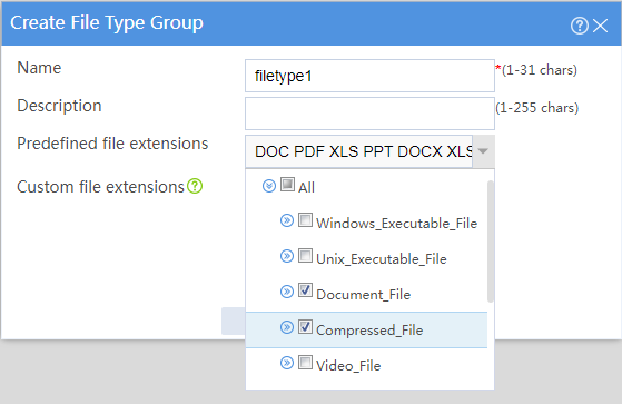

Configure file type groups.
# Create file type group filetype1 as follows:
On the top navigation bar, click Objects.
From the navigation pane, select APP Security > File Filtering > File Type Groups.
Click Create.
In the dialog box that opens, configure the file type group:
Enter filetype1 in the Name field.
From the Predefined file extensions list, select Compressed_File and Docmument_File.
Click OK.
Figure 2 Creating file type group filetype1

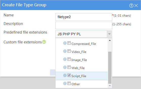

# Create file type group filetype2 with the Script_File predefined file extension selected.
Figure 3 Creating file type group filetype2
