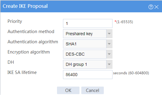

Create an IKE proposal:
# On the top navigation bar, click Network.
# From the navigation pane, select VPN > IPsec > IKE Proposals.
# Click Create.
Set the priority to 1.
Select the preshared key authentication method.
Select the SHA1 authentication algorithm.
Select the DES-CBC encryption algorithm.
Use the default settings for other parameters.
# Click OK.
Figure 7 Creating an IKE proposal

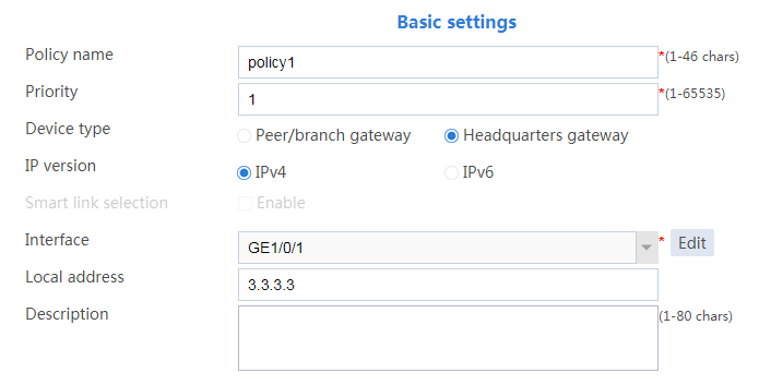

# Configure the basic settings as follows:
Set the policy name to policy1.
Set the device type to Headquarters gateway.
Set the IP version to IPv4.
Select interface GE1/0/1.
Figure 8 Basic settings

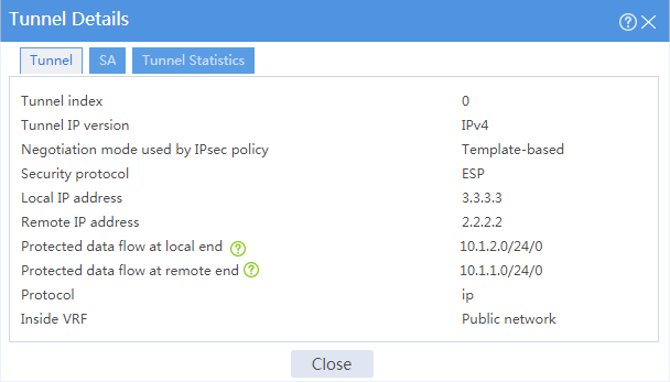

Verify that Device A and Device B can communicate with each other.
On Device A, display IPsec tunnel information:
# From the navigation pane, select VPN > IPsec > IPsec Tunnels. The established IPsec tunnel is displayed.
# Click the Details icon for the IPsec tunnel. The Tunnel Details page displays tunnel information, SA information, and tunnel statistics.
Figure 11 Details of the IPsec tunnel on Device A

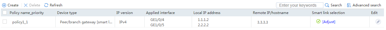

On Device A, automatically or manually switch links:
# From the navigation pane, select VPN > IPsec > IPsec Policies. In this example, the created IPsec policy policy1_1 is displayed, and IPsec smart link selection is enabled in the policy.
IPsec smart link selection enables the branch gateway to monitor the real-time packet loss ratio and delay of the active link over which the IPsec tunnel is established. The branch gateway can dynamically select a link with desired transmission quality to establish the IPsec tunnel to the headquarters.
Figure 12 IPsec policies

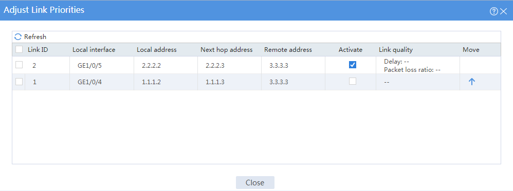

# Click Adjust in the Smart link selection column to open the Adjust Link Priorities page.
# Select the check box in the Activate column of a link to manually activate the link.
Figure 13 Adjust link priorities
Figure 14 Details of the IPsec tunnel on Device B
