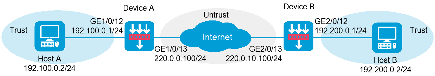

As shown in Figure 1, establish an IPsec tunnel between Device A and Device B to protect data flows between the subnets of Host A and Host B. Configure the tunnel as follows:
Set up SAs through IKE negotiation.
Configure IKE to use the 3DES-CBC encryption algorithm, the SHA256 authentication algorithm, and the preshared key authentication method.
Specify the IPsec encapsulation mode as tunnel and the security protocol as ESP

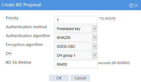

Create an IKE proposal:
# On the top navigation bar, click Network.
# From the navigation pane, select VPN > IPsec > IKE Proposals.
# Click Create.
Set the priority to 1.
Select the preshared key authentication method.
Select the SHA256 authentication algorithm.
Select the 3DES-CBC encryption algorithm.
Use the default settings for other parameters.
# Click OK.
Figure 2 Creating an IKE proposal

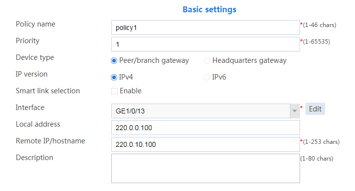

# Configure the basic settings as follows:
Set the policy name to policy1.
Set the device type to Peer/branch gateway.
Set the IP version to IPv4.
Select interface GE1/0/13.
Configure the local address as 220.0.0.100.
Configure the remote address/host name as 220.0.10.100.

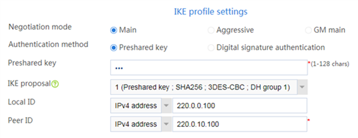

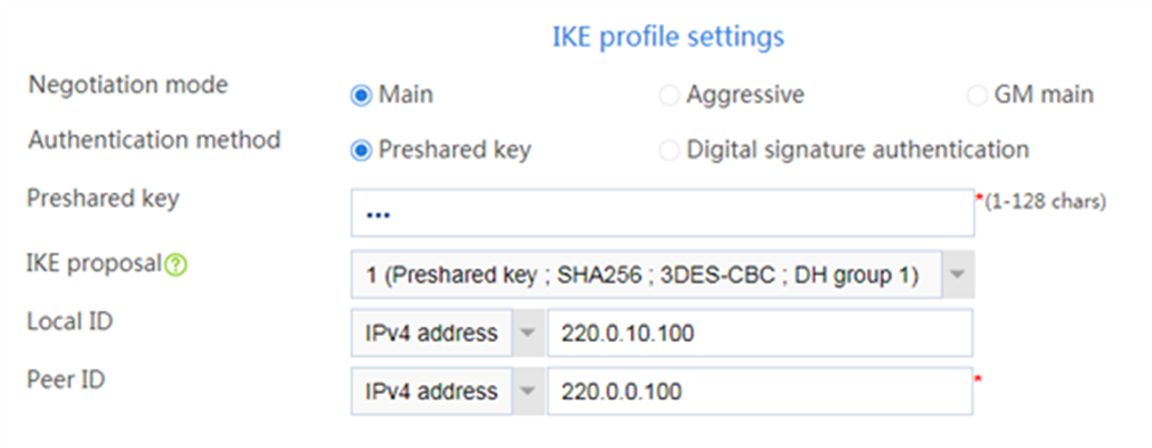

# Configure the IKE profile settings as follows:
Set the negotiation mode as Main.
Set the authentication method as Preshared key.
Enter the preshared key string.
Select IKE proposal 1 (Preshared key; SHA256; 3DES-CBC; DH group 1).
Set the local ID as IPv4 address 220.0.0.100.
Set the peer ID as IPv4 address 220.0.10.100.
Figure 4 IKE profile settings

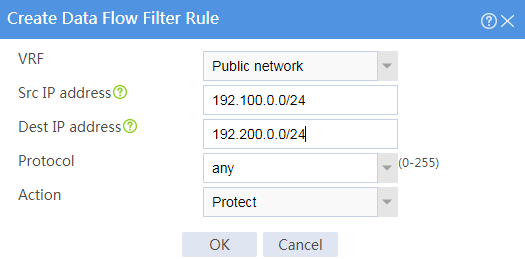

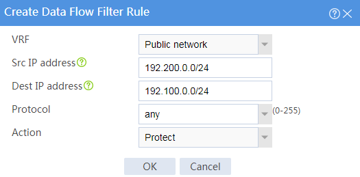

# Configure the data flow filter rules as follows:
Click Create.
Set the source IP address as 192.100.0.0/24.
Set the destination IP address as 192.200.0.0/24.
# Click OK.
Figure 5 Creating a data flow filter rule
Select interface GE2/0/13.
Configure the local address as 220.0.10.100.
Configure the remote address/host name as 220.0.0.100.
Figure 7 Basic settings
Set the local ID as IPv4 address 220.0.10.100.
Set the peer ID as IPv4 address 220.0.0.100.
Figure 8 IKE profile settings
Click Create.
Set the source IP address as 192.200.0.0/24.
Set the destination IP address as 192.100.0.0/24.
# Click OK.
Figure 9 Creating a data flow filter rule

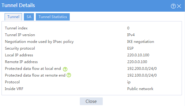

On Device A, display IPsec tunnel information:
# From the navigation pane, select VPN > IPsec > IPsec Tunnels. The established IPsec tunnel is displayed.
# Click the Details icon for the IPsec tunnel. The Tunnel Details page displays tunnel information, SA information, and tunnel statistics.
Figure 10 Details of the IPsec tunnel on Device A
