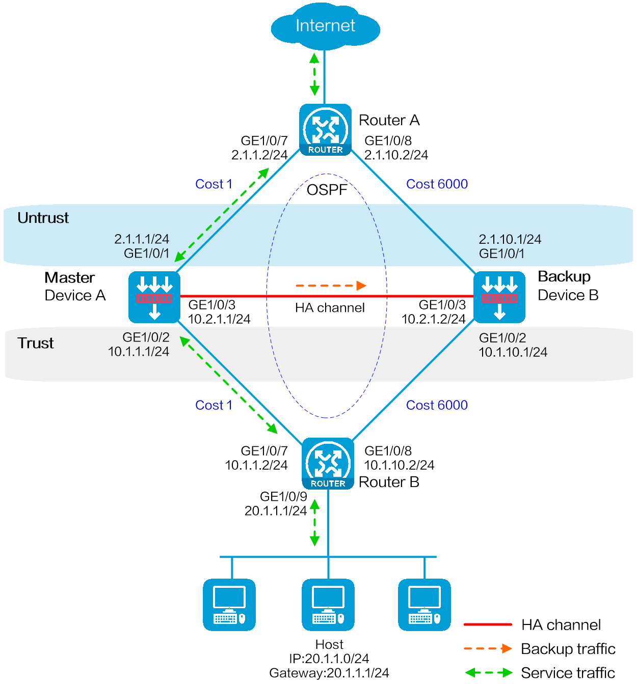

CLI example: Configuring the HA group in active/standby mode in collaboration with a routing protocol
As shown in Figure 1, set up the HA group at the border between the Internet and the internal network of an enterprise to ensure service continuity.
Figure 1 Network diagram
Software versions used
This configuration example was created and verified on R9071 of the M9000-AI-E8 device.
Member device restrictions and guidelines
A hot backup system can contain a maximum of two devices.
To ensure that the traffic size is within the processing capability of one device upon failure of the other device, make sure the throughput of each device does not exceed 50% of its capability.
Hardware environment consistency
Before you configure hot backup, verify that the following hardware settings are the same on the devices to be assigned to a hot backup system:
Software environment consistency
Before you configure hot backup, verify that the following software settings are the same on the devices to be assigned to a hot backup system:
Procedures

Configuration files
 router id 2.1.1.2
ospf 1
 area 0.0.0.0
  network 2.1.1.0 0.0.0.255
  network 2.1.10.0 0.0.0.255
interface GigabitEthernet1/0/7
 port link-mode route
 ip address 2.1.1.2 255.255.255.0
interface GigabitEthernet1/0/8
 ip address 2.1.10.2 255.255.255.0
interface GigabitEthernet1/0/9
 ip address 3.1.1.14 255.255.255.0
 ip route-static 0.0.0.0 0 3.1.1.15
 router id 10.1.1.2
ospf 1
 area 0.0.0.0
  network 10.1.1.0 0.0.0.255
  network 10.1.10.0 0.0.0.255
  network 20.1.1.0 0.0.0.255
 ip address 10.1.1.2 255.255.255.0
 ip address 10.1.10.2 255.255.255.0
 ip address 20.1.1.1 255.255.255.0
 router id 2.1.1.1
track 1 interface GigabitEthernet1/0/1
track 2 interface GigabitEthernet1/0/2
ospf 1
 area 0.0.0.0
 ip address 2.1.1.1 255.255.255.0
 ip address 10.2.1.1 255.255.255.0
security-zone name Trust
 import interface GigabitEthernet1/0/2
security-zone name Untrust
 import interface GigabitEthernet1/0/1
security-policy ip
 rule 0 name trust-untrust
  action pass
  source-zone trust
  destination-zone untrust
  source-ip-subnet 20.1.1.0 255.255.255.0
 rule 1 name ospf1
  action pass
  source-zone trust
  destination-zone local
  service ospf
 rule 2 name ospf2
  action pass
  source-zone local
  destination-zone trust
  service ospf
 rule 3 name ospf3
  action pass
  source-zone untrust
  service ospf
 rule 4 name ospf4
  action pass
  source-zone local
  service ospf
remote-backup group
 data-channel interface GigabitEthernet1/0/3
 configuration sync-check interval 12
 adjust-cost ospf enable absolute 6000
 track 1
 track 2
 local-ip 10.2.1.1
 remote-ip 10.2.1.2
 device-role primary
 router id 2.1.10.1
ospf 1
 area 0.0.0.0
 ip address 2.1.10.1 255.255.255.0
 ip address 10.1.10.1 255.255.255.0
 ip address 10.2.1.2 255.255.255.0
remote-backup group
 track 1
 track 2
 local-ip 10.2.1.2
 remote-ip 10.2.1.1
 device-role secondary
