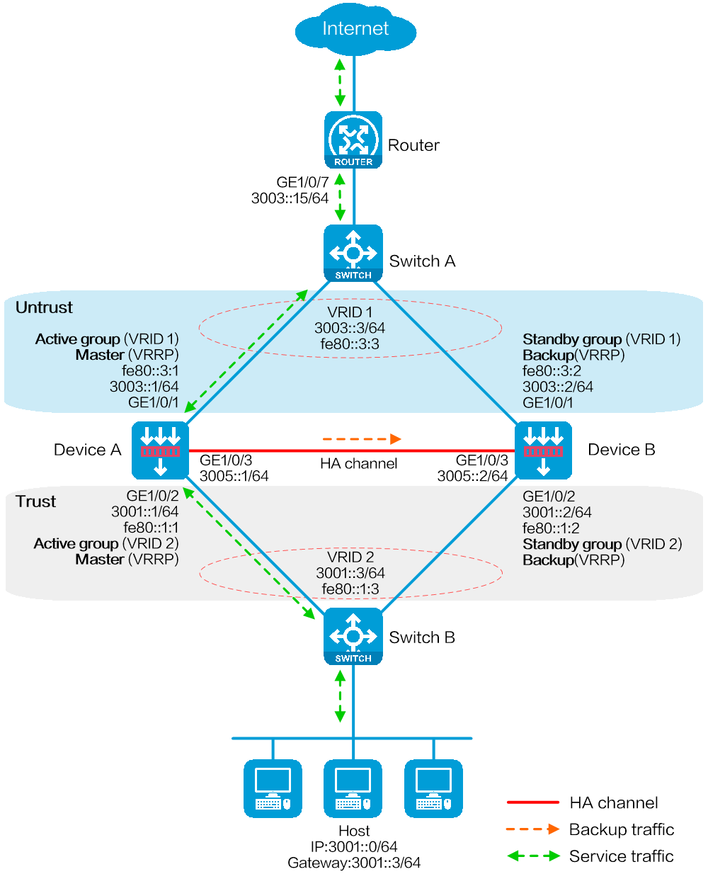

CLI example: Configuring active/standby hot backup in collaboration with VRRP (IPv6)
As shown in Figure 1, set up a hot backup system at the border between the Internet and the internal network of an enterprise to ensure service continuity.
Figure 1 Network diagram
Software versions used
This configuration example was created and verified on R9071 of the M9000-AI-E8 device.

Configure the router:
  1. Configure IPv6 addresses for interfaces.
# Assign an IPv6 address to GigabitEthernet 1/0/7.
<Router> system-view
[Router] interface gigabitethernet 1/0/7
[Router-GigabitEthernet1/0/7] ipv6 address 3003::15/64
[Router-GigabitEthernet1/0/7] quit
  1. Configure routes as follows:
# Specify 3003::3/64 (virtual IPv6 address of VRRP group 1) as the next hop of the routes to the internal network.
# Specify 3007::15/64 as the next hop of the route to the Internet.
[Router] ipv6 route-static 3001::3 64 3003::3
[Router] ipv6 route-static 0::0 64 3007::15

On the host, specify 3001::3 (virtual IP address of VRRP group 2) as the default gateway. (Details not shown.)

 Total number of virtual routers : 2
 Interface          VRID  State        Running Adver   Auth     Virtual
                                       Pri     Timer   Type        IP
 GE1/0/1            1     Master       100     100     None     FE80::3:3
 GE1/0/2            1     Master       100     100     None     FE80::1:3
# Enable statistics collection for the security policy rules of the security zones Trust and Untrust. Verity that you can view the processed traffic on Device A but not on Device B when the host communicates with the Internet. (Details not shown.)
Verify the configuration on Device B:
# Verify that the HA channels have been set up.
RBM_S[DeviceB] display remote-backup-group status
Remote backup group information:
  Backup mode: Active/standby
  Device management role: Secondary
  Device running status: Standby
  Data channel interface: GigabitEthernet1/0/3
  Local IPv6: 3005::2
  Remote IPv6: 3005::1    Destination port: 60064
  Control channel status: Connected
  Keepalive interval: 1s
  Keepalive count: 10
  Configuration consistency check interval: 12 hour
  Configuration consistency check result: Not Performed
  Configuration backup status: Auto sync enabled
  Session backup status: Hot backup enabled
  Uptime since last switchover: 0 days, 3 hours, 11 minutes
  Switchover records:
    Time                     Status change        Cause
    2021-06-22 13:33:33      Initial to Active    Local device rebooted
# Verify that Device A is the backup in all VRRP groups.
RBM_S[DeviceB] display vrrp ipv6
IPv6 Virtual Router Information:
 Running mode      : Standard
 RBM control channel is established
   IPv6 VRRP active group status : Backup
   IPv6 VRRP standby group status: Backup
                                       Pri     Timer   Type        IP
 GE1/0/1            1     Backup       100     100     None     FE80::3:3
 GE1/0/2            1     Backup       100     100     None     FE80::1:3
