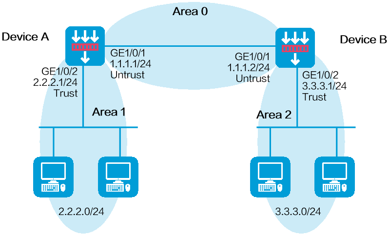

As shown in Figure 1, all devices run OSPF and the AS is divided into three areas. Device A and Device B act as ABRs to forward routes between areas. After configuration, each router should learn all routes to the AS.
Figure 1 Network diagram
Software version used
This configuration example was created and verified on R9071 of the M9000-AI-E8 device.
Procedures
Configure Device A
1.        Configure IP addresses for interfaces correctly according to Figure 1.

# View detailed information about OSPF neighbors on Device A.
[DeviceA] display ospf peer verbose
         OSPF Process 1 with Router ID 2.2.2.1
                 Neighbors
 Area 0.0.0.0 interface 1.1.1.1(GigabitEthernet1/0/1)'s neighbors
 Router ID: 3.3.3.1          Address: 1.1.1.2          GR State: Normal
   State: Full  Mode: Nbr is master  Priority: 1
   DR: 1.1.1.1  BDR: 1.1.1.2  MTU: 0
   Options is 0x42 (-|O|-|-|-|-|E|-)
   Dead timer due in 32  sec
   Neighbor is up for 00:07:08
   Authentication Sequence: [ 0 ]
   Neighbor state change count: 5
   BFD status: Disabled
# View OSPF routing information on Device A.
[DeviceA] display ospf routing
                  Routing Table
 Routing for network
 Destination        Cost     Type    NextHop         AdvRouter       Area
 3.3.3.0/24         2        Inter   1.1.1.2         3.3.3.1         0.0.0.0
 2.2.2.0/24         1        Stub    0.0.0.0         2.2.2.1         0.0.0.1
 1.1.1.0/24         1        Transit 0.0.0.0         2.2.2.1         0.0.0.0
 Total nets: 3
 Intra area: 2  Inter area: 1  ASE: 0  NSSA: 0
# Verify that devices in area 1 can ping PCs in area 2, and vice versa.
