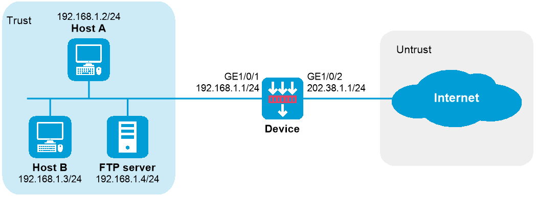

As shown in Figure 1, the internal FTP server at 192.168.1.4/24 provides services for internal and external users. The private network uses two public IP addresses 202.38.1.1 and 202.38.1.2.
Configure NAT hairpin in C/S mode to allow external and internal users to access the internal FTP server by using public IP address 202.38.1.2.
Figure 1 Network diagram

# Assign IP addresses to interfaces and configure routes, security zones, zone pairs, and interzone policies. Make sure the network connections are available. (Details not shown.)
# Configure ACL 2000 to identify packets from subnet 192.168.1.0/24 to be translated.
<Device> system-view
[Device] acl basic 2000
[Device-acl-ipv4-basic-2000] rule permit source 192.168.1.0 0.0.0.255
[Device-acl-ipv4-basic-2000] quit
# Configure a NAT server mapping on GigabitEthernet 1/0/2 to map the IP address of the FTP server to a public address, allowing external users to access the internal FTP server.
[Device] interface gigabitethernet 1/0/2
[Device-GigabitEthernet1/0/2] nat server protocol tcp global 202.38.1.2 inside 192.168.1.4 ftp
# Enable outbound NAT with Easy IP on GigabitEthernet 1/0/2 so that NAT translates the source addresses of the packets from internal hosts into the IP address of interface GigabitEthernet 1/0/2.
[Device-GigabitEthernet1/0/2] nat outbound 2000
[Device-GigabitEthernet1/0/2] quit
# Enable NAT hairpin on GigabitEthernet 1/0/1.
[Device-GigabitEthernet1/0/1] nat hairpin enable
# Verify that both internal and external hosts can access the internal FTP server through the public address. (Details not shown.)
