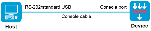

2.        Find the console cable shipped with the device and connect the DB-9 female connector or the standard USB connector of the console cable to the 9-pin serial port or the USB port of the PC.
3.        Identify the console port of the device carefully and connect the RJ-45 connector of the console cable to the console port.
Figure 1 Connecting a terminal to the console port
