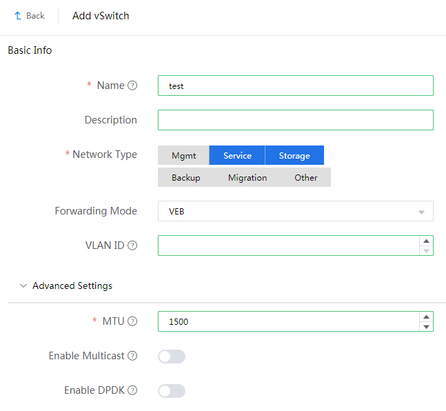

  1. On the cluster configuration page, click the vSwitches tab. Click Add vSwitch.
  1. Configure basic information for the vSwitch. This example creates a vSwitch for the storage network.. Enter stor in the Name field, select VEB from the Forwarding Mode list, and enter a VLAN ID in the VLAN ID field.

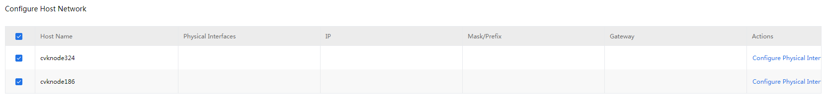

  1. Configure the host network settings. Select the hosts that will use the vSwitch.

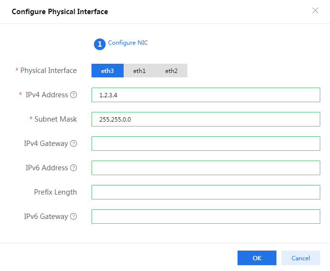

  1. Configure physical interfaces for the selected hosts:
  1. Click Configure Physical Interface in the Actions column for a host.

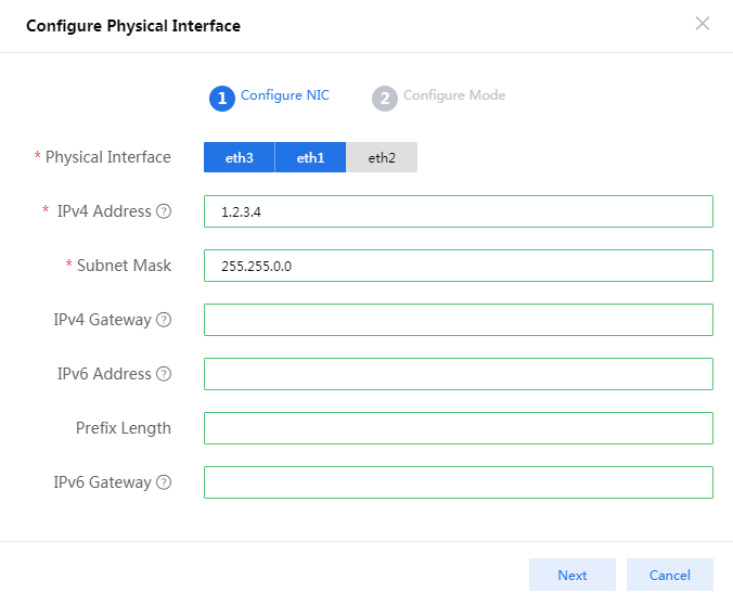

  1. In the dialog box that opens, select the NICs to be used by the vSwitch.
  1. Configure the IP address and subnet network settings for the vSwitch.
  1. Repeat this step for all the hosts selected to use the vSwitch.
Only one gateway can be configured for a host. If multiple gateways are configured, unpredictable problems might error.
  1. If only one NIC is selected for the vSwitch, click OK to finish the vSwitch creation.

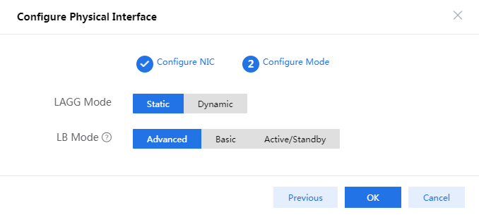

  1. If multiple NICs are selected for the vSwitch, you need to configure the link aggregation mode and load balancing mode for the selected NICs.
·          To avoid CVK unavailability, make sure the physical switch connected to the vSwitch has the corresponding link aggregation settings.
·          If the vSwitch uses the dynamic link aggregation mode, the connected physical switch must also use the dynamic link aggregation mode.
·          If the vSwitch uses the static link aggregation mode and the basic or advanced load balancing mode, the connected physical switch must use the static link aggregation mode. If the vSwitch uses the active/standby link aggregation mode, do not configure link aggregation on the connected physical switch.
·          As a best practice, use the active/standby or basic link aggregation mode. The advanced link aggregation mode is not recommended.
