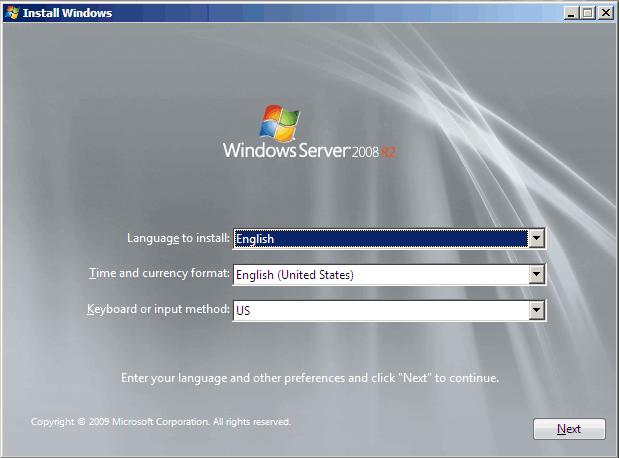

Mount the guest OS image file to the VM and start guest OS installation on the VM
  1. Navigate to the VM configuration page. Click Edit in the Actions column for the VM, select CD-ROM, and then click Connect. Select the drive and the OS image file on the drive, and then click OK to mount the OS image file to the VM.
  1. On the VM configuration page, click Start to start the VM.
  1. After the VM is started, click Console to launch the remote console window and verify that the VM has started to install the OS.

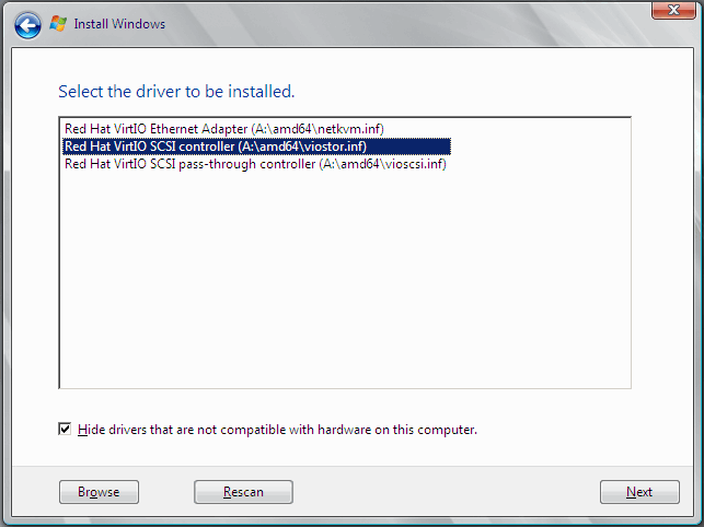

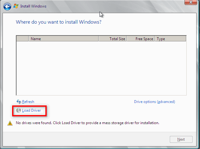

  1. Because a high-speed disk is used for OS installation and Windows does not have the required driver to identify the disk, you will be prompted to load the required driver in the OS installation process. Click Load Driver. The dialog box for loading a driver opens. Make sure the automatic Virtio driver loading function is enabled in the system.
  1. Select the driver to install. In this example, select the SCSI controller to install the high-speed disk driver.

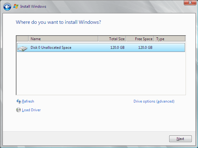

  1. Check the high-speed disk information displayed on the OS installation screen after the driver installation is complete.
