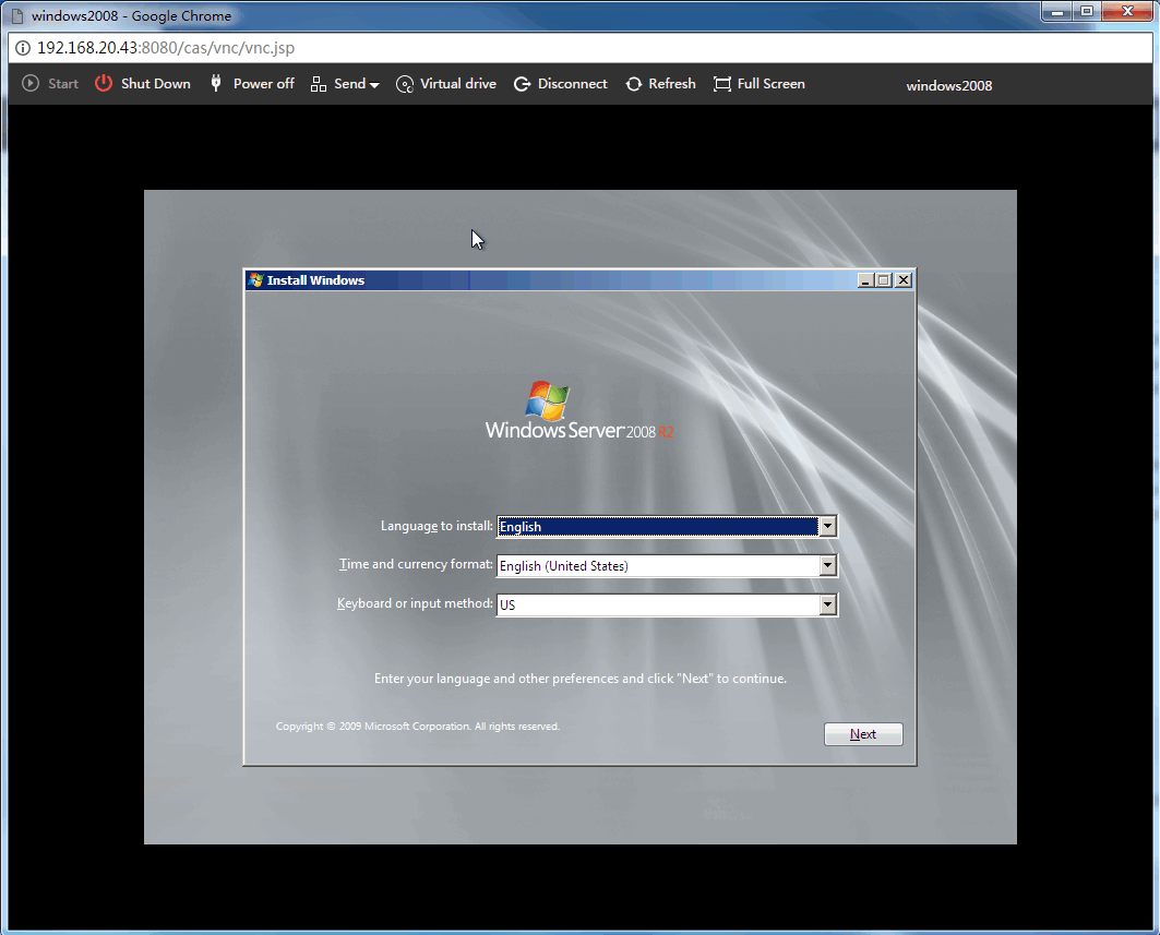

  1. After the VM is started, click Console to launch the remote console window and verify that the VM has started to install the OS.

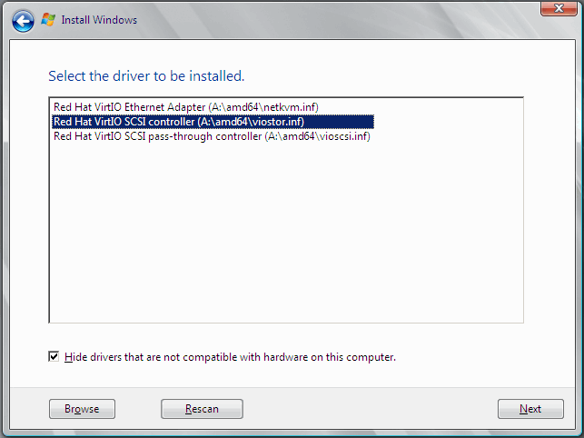

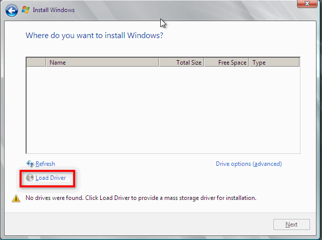

  1. Because a high-speed disk is used for OS installation and Windows does not have the required driver to identify the disk, you will be prompted to load the required driver in the OS installation process. Click Load Driver. The dialog box for loading a driver opens. Make sure the automatic Virtio driver loading function is enabled in the system.
  1. Select the driver to install. In this example, select the SCSI controller to install the high-speed disk driver.

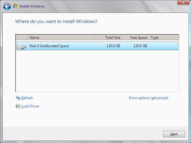

  1. Check the high-speed disk information displayed on the OS installation screen after the driver installation is complete.

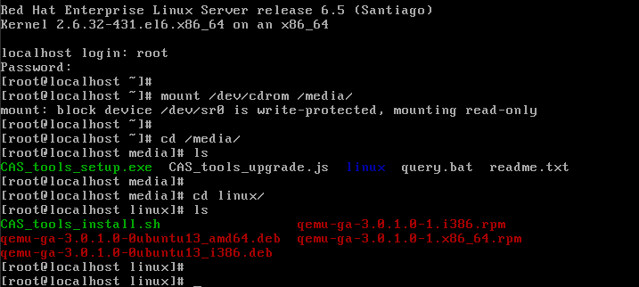

  1. Mount the .iso installation file of the tool to the VM. To do so, select CD-ROM on the VM modification page. In the right pane, click Connect. In the Select File dialog box that opens, select Install CAStools and click OK.
  1. Execute the mount command to mount the driver to the Linux VM and access the Linux directory of the proxy tool.
  1. Execute the ./CAS_tools_install.sh command to install the tool.
