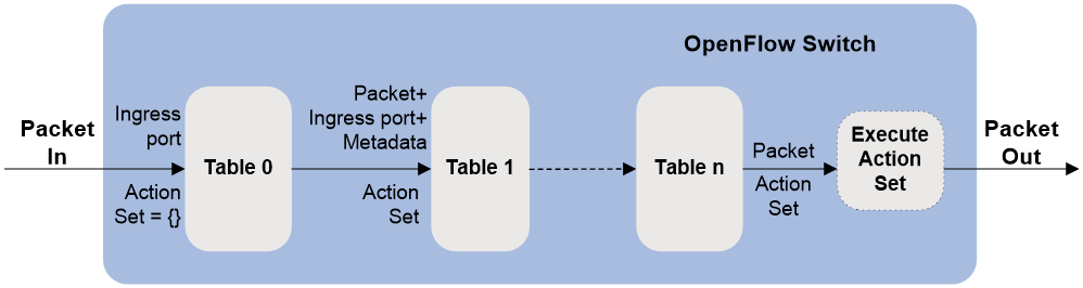

OpenFlow pipeline
The OpenFlow pipeline processing defines how packets interact with flow tables contained by a switch.
The flow tables of an OpenFlow switch are sequentially numbered, starting at 0. The packet is first matched with flow entries of the first flow table, which is flow table 0. A flow entry can only direct a packet to a flow table number that is greater than its own flow table number.
When a packet matches a flow entry, the OpenFlow switch updates the action set for the packet and passes the packet to the next flow table. In the last flow table, the OpenFlow switch executes all actions to modify packet contents and specify the output port for packet forwarding. If the instruction set of a flow table contains an action list, the OpenFlow switch immediately executes the actions for a copy of the packet in this table.
Figure 3 OpenFlow forwarding workflow
Table-miss flow entry
Every flow table must support a table-miss flow entry to process table misses. The table-miss flow entry specifies how to process packets that were not matched by other flow entries in the flow table.
The table-miss flow entry wildcards all match fields (all fields omitted) and has the lowest priority 0.
The table-miss flow entry behaves in most ways like any other flow entry.

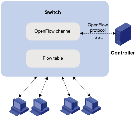

OpenFlow channel
The OpenFlow channel is the interface that connects each OpenFlow switch to a controller. The controller uses the OpenFlow channel to exchange control messages with the switch to perform the following operations:
·     Configure and manage the switch.
·     Receive events from the switch.
·     Send packets out the switch.
The OpenFlow channel is usually encrypted by using TLS. Also, an OpenFlow channel can be run directly over TCP.

OpenFlow controller
Controller roles
A switch can establish connections with multiple controllers. When OpenFlow operation is initiated, a switch is simultaneously connected to multiple controllers in Equal state. A controller can request its role to be changed at any time. The controller role contains the following types:
·     Equal—In this role, the controller has full access to the switch and is equal to other controllers in the same role. By default, the controller receives all switch asynchronous messages such as packet-in and flow-removed messages. The controller can send controller-to-switch messages to modify the state of the switch.
·     Master—This role is similar to the Equal role and has full access to the switch. The difference is that up to one controller in this role is allowed for a switch.
·     Slave—In this role, the controller has read-only access to the switch.
The controller cannot send controller-to-switch messages to perform the following operations:
¡     Deploy flow entries, group entries, and meter entries.
¡     Modify the port and switch configurations.
¡     Send packet-out messages.
By default, the controller does not receive switch asynchronous messages except Port-status messages. The controller can send Asynchronous-Configuration messages to set the asynchronous message types it wants to receive.
Controller connection modes
An OpenFlow instance can connect to one or more controllers, depending on the controller connection mode the OpenFlow instance uses:
·     Single—The OpenFlow instance connects to only one controller at a time. When communication with the current controller fails, the OpenFlow instance uses another controller.
·     Multiple—The OpenFlow instance can simultaneously connect to multiple controllers. When communication with any controller fails, the OpenFlow instance attempts to reconnect to the controller after a reconnection interval.

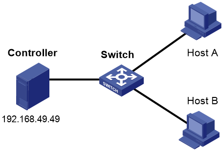

Example: Configuring OpenFlow in global mode
As shown in Figure 7, perform the following tasks on the device:
·     Create OpenFlow instance 1, assign all service interfaces on the device to the OpenFlow instance, and activate the OpenFlow instance.
·     Specify the controller for OpenFlow instance 1 to manage the device.
Figure 7 Network diagram

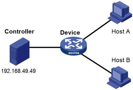

Example: Configuring OpenFlow in VLAN mode
As shown in Figure 8, an OpenFlow switch communicates with the controller. Perform the following tasks on the OpenFlow switch:
·     Create OpenFlow instance 1, associate VLANs 4092 and 4094 with the OpenFlow instance, and activate the OpenFlow instance.
·     Configure the IP address for controller 1 to have the controller manage the OpenFlow switch.
Figure 8 Network diagram
