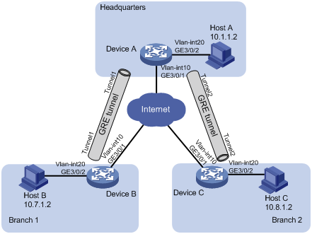

Network requirements
As shown in Figure 1, Device A is the gateway of the headquarters. Device B and Device C are the gateways of Branch 1 and Branch 2, respectively. The gateways have obtained public IP addresses from an ISP and can communicate with one another. Configure GRE with OSPF to meet the following requirements:
·     The headquarters and the branches communicate with one another through the GRE tunnels established between the headquarters and the branches.
·     The gateways learn the routes reaching the destination networks through the tunnel interfaces.
Figure 1 Network diagram
Device
Interface
IP address
Device
Interface
IP address
Device A
Vlan-int 10
191.2.1.1/24
Device B
Vlan-int 10
191.3.1.1/24
Vlan-int 20
10.1.1.1/24
Vlan-int 20
10.7.1.1/24
Tunnel 1
10.5.1.1/24
Tunnel 1
10.5.1.2/24
Tunnel 2
10.6.1.1/24
Device C
Vlan-int 10
191.4.1.1/24
Vlan-int 20
10.8.1.1/24
Tunnel 2
10.6.1.2/24
Software version used
This configuration example was created and verified on S7500EX-CMW710-R7168.
